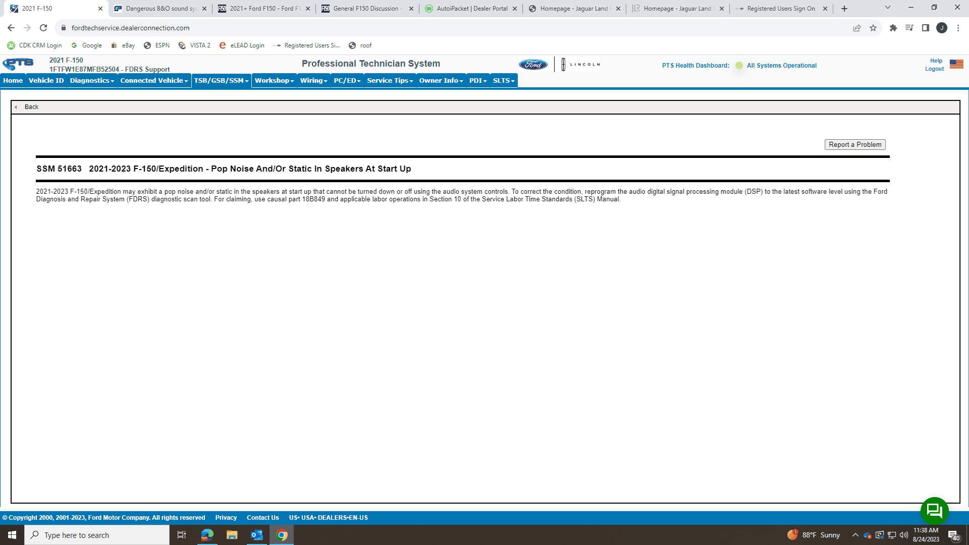

I'll say it again: There is a fix for this as of a few months now. The dealer can apply a software update that fixes this. Reference SSM 51663 to your dealer. Attached is a screenshot from PTS.
Ford F-150 Dangerous B&O sound system issue Picture8

Have the dealer do DSP update mentioned in this thread and it won't be an issue anymore.
Or DIY with Mongoose cable and FDRS.
I installed it myself and have only experienced a much quieter pop since then when flipping between screens on dash. Audio was switching between Ford built in nav and Android Auto.
