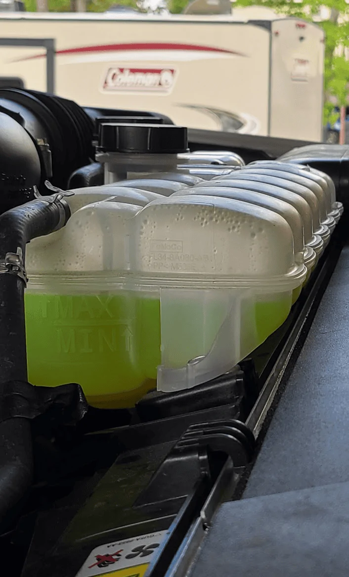

I've got a 2021 PB and... here's my coolant level 2 weeks apart. The thread is 100% relevant to all PBs, unfortunately. I am under the "can see the coolant level going down, but can't find the leak" (which is best case). The leaks can get worse / vehicle becomes undrivable. The main culprit is a heat exchanger unique to PBs that leaks, but... it could be anywhere! I've had it at the dealer multiple times to pressure test - nothing. No puddles even when vehicle sits for days... just fill it up every month.
Filled to top:
Ford F-150 Coolant loss 1658889090679
2 weeks later...
Ford F-150 Coolant loss 1658889117537

Thanks for all of the replies. The missing coolant is from the main system, the large reservoir, not from the small tank associated with the hybrid cooling loops. From my reading, this would eliminate the exhaust heat exchanger as the culprit as it is used to warm the batteries.

Yep! It's the infamous Powerboost-only exhaust heat exchanger leak, which seems hundreds (or thousands!) of people are having. The dealership finally said there was Ford documentation (not sure if TSB, or whatnot) and fixed it.
It's just the opposite.
The exhaust heat exchanger is part of the engine coolant loop, thus the larger expansion tank.
Ford F-150 Coolant loss enginecoolantloo
Not the Hybrid cooling loop with the smaller expansion tank.
