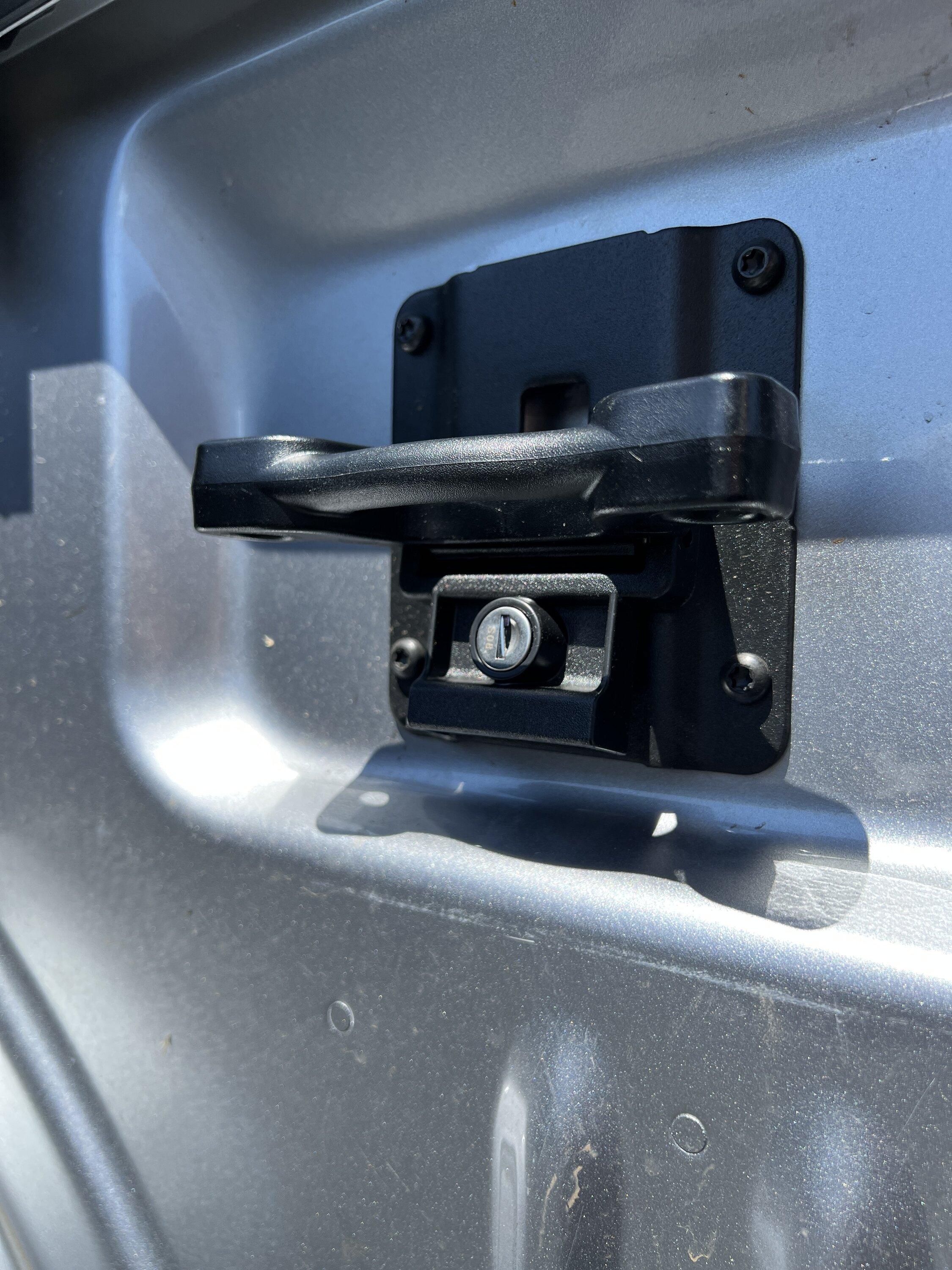

For the life of me I cannot get the Ford supplied cleats to go into the boxlink brackets. Even tried a rubber hammer to get them in. No dice. They just will not slide up into the bracket.
what am I doing wrong?

Make sure it’s unlocked. The part that folds. Pull it out more towards you. Push the cleat up then push the locking folding part towards the bed and it should go. Then lock.

unlock it, then till will slide into the slot. The lock holds it in..

With my spray-in liner they were hard to install. I had to twist them back and forth as I was getting them to move up (or is it down) to install. Without the bed liner, yours should install easily. Like others said, make sure the lock is unlocked in the proper position to slide in.

Ok after a lot of swearing I managed to get them in. Trick appears to be to tilt it slightly. Was not an easy slot in.

Rubber mallet did wonders for me. After a few times knocking them in and out I am able to take install and remove them fairly easily.

I had to take a file to one of mine. Three of them fit snugly. One just wasn't going in. I think it was the mold line causing the interference.

mine has the spray in liner, i loosened the bolts t give a bit of wiggle room, then persuaded them in

I put liquid soap on my Box Links first. Went right in. This sounds so risqué!
