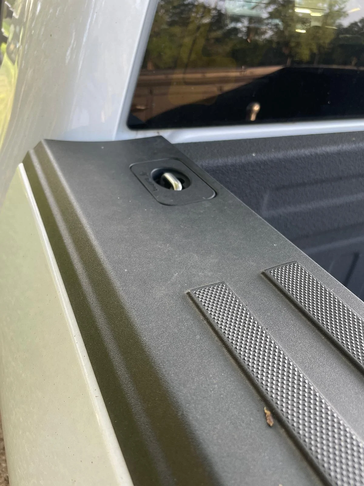

I cut mine out with the BullRing router bit, installed the tie downs, and then filled in the gap with black RTV. I did better on one side than the other with smoothing it out, but it looks better than with the gap.
