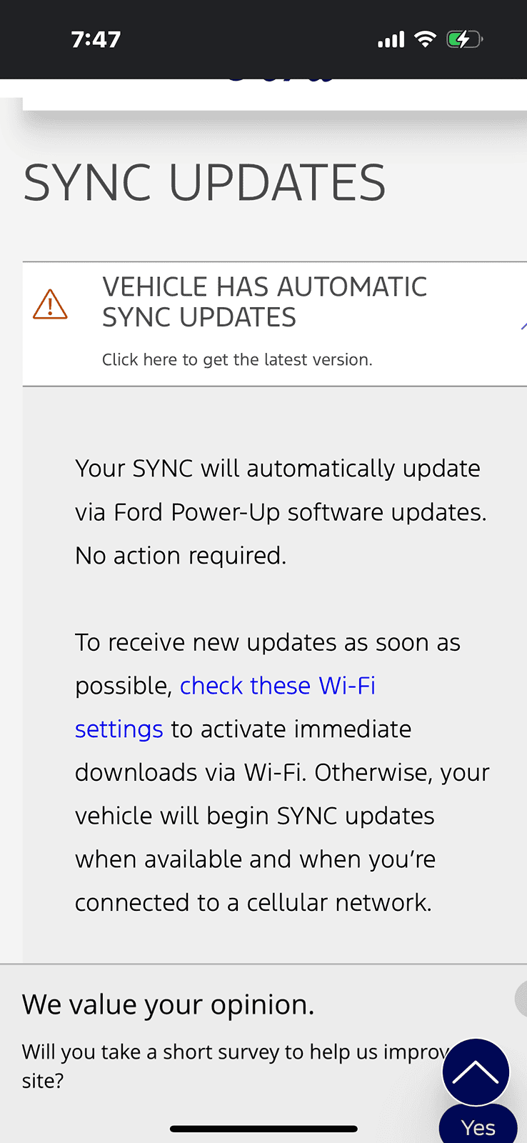

From what I can tell…. Nothing has updated. I do show this in the my ford site, but when I click on the “click here for the latest version” tab…. It just closes the information box. Nav updates shows the same symbol and clinking on the update tab, I get the same results. ?‍♂ lol
Ford F-150 Black screen IMG_1206
That sounds like an APIM reboot. As to why or if it happens again, well you'll have to keep an eye on it.

It would be in FordPass app, not the website. Or check truck screen update details if it is different than your last update.
Update or not I wouldn't worry about it unless it happens frequently.

"To receive new updates as soon as possible, check these Wi-Fi settings to activate immediate downloads via Wi-Fi."
Would some kind person put these up as I can't activate my KR using fordpass (long story but no TCU connectivity)? Curious to see if OTAs can actually be done without cellular triggers ?
Unfortunately, in the 3 years I have owned my truck, I have received only 1 update vis Wifi and that was this month. A TCU update. The others have been vis cell connection.
Yep, I seriously doubt they'll come over wi-fi, but it'd be nice to see what settings they're talking about.

Just setup truck with WiFi turned on, and add your home WiFi. It can't hurt to try it. I also doubt that it will ever work. You would need someone with PTS to see your truck get an OTA trigger. Then have it on WiFi and see if it will download the update. Thinking about it now if you can install FordPass I don't see why you can't link the truck to it if the truck is on WiFi. Unless Ford blocks IP addresses outside US. ?
Yup, wi-fi all set up and has been reporting stats to Ford since I got it home in November ?‍♂. I'd still like to see if they're saying anything different from that message. Last time I tried to activate was, I admit, months ago and no dice. I'll give it another go shortly. Javier already has with PTS and whatever triggers are for me end up expiring. I still believe that triggers only get sent via TCU and that some bulk file downloads can and do happen over wi-fi. I'll report back re activation ?
