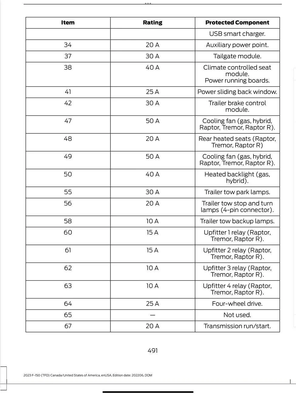

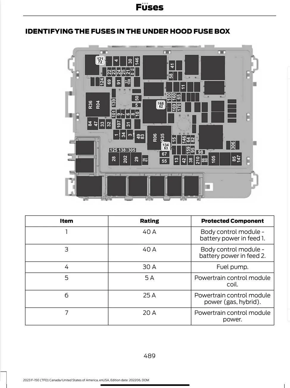

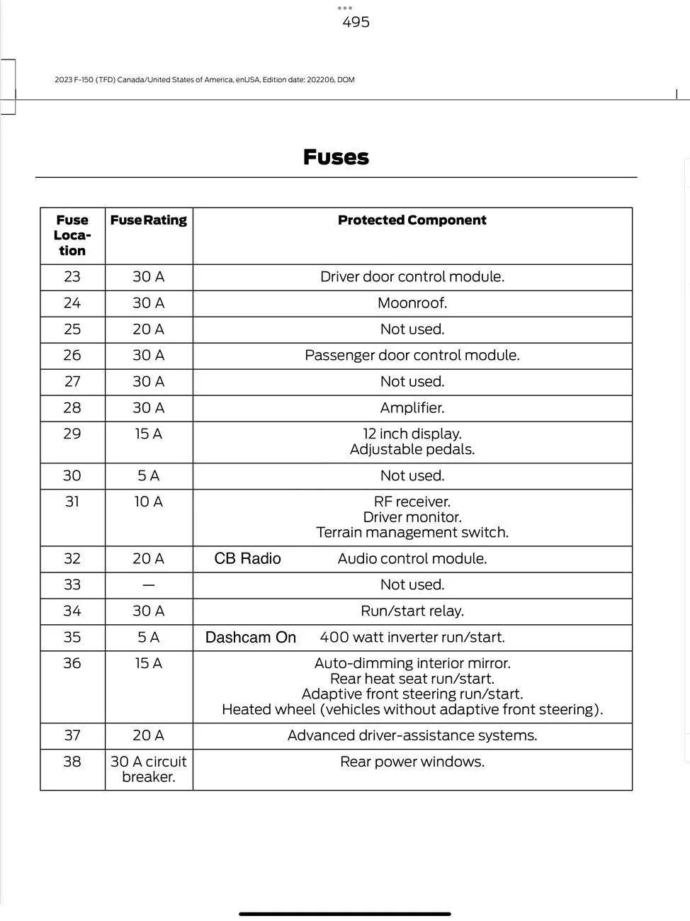

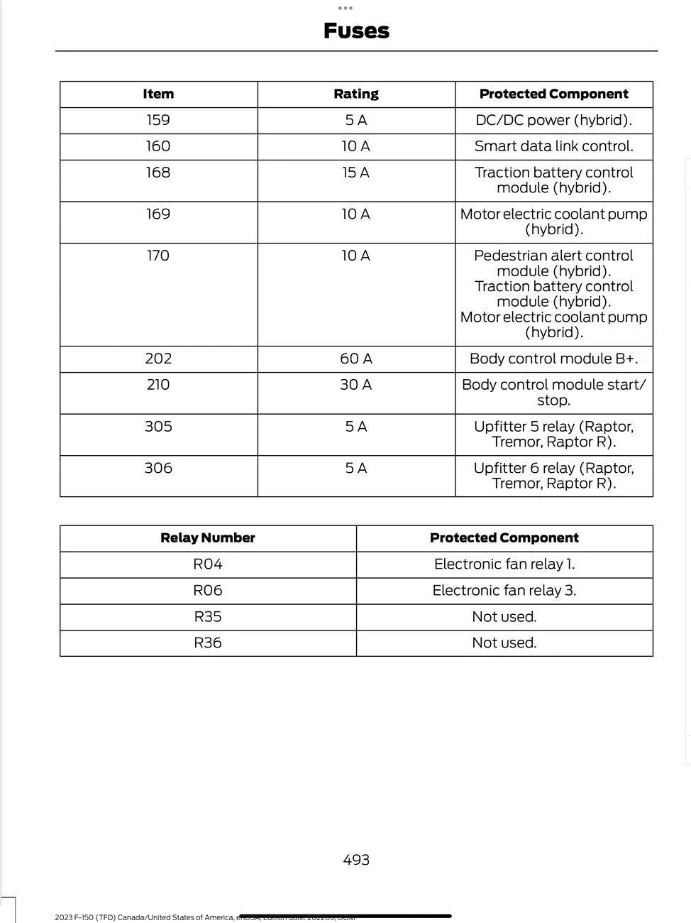

I'll just leave them as attachments because they attached out of order and I can't see properly to order them correctly. The page numbers will help.

I pulled the number 15 integrated control panel sync and cranked it nothing happened as expected then turned truck off and put fuse back in and the sync came back on and working fine.
I do appreciate the diagrams I'm screenshoting them to keep.
