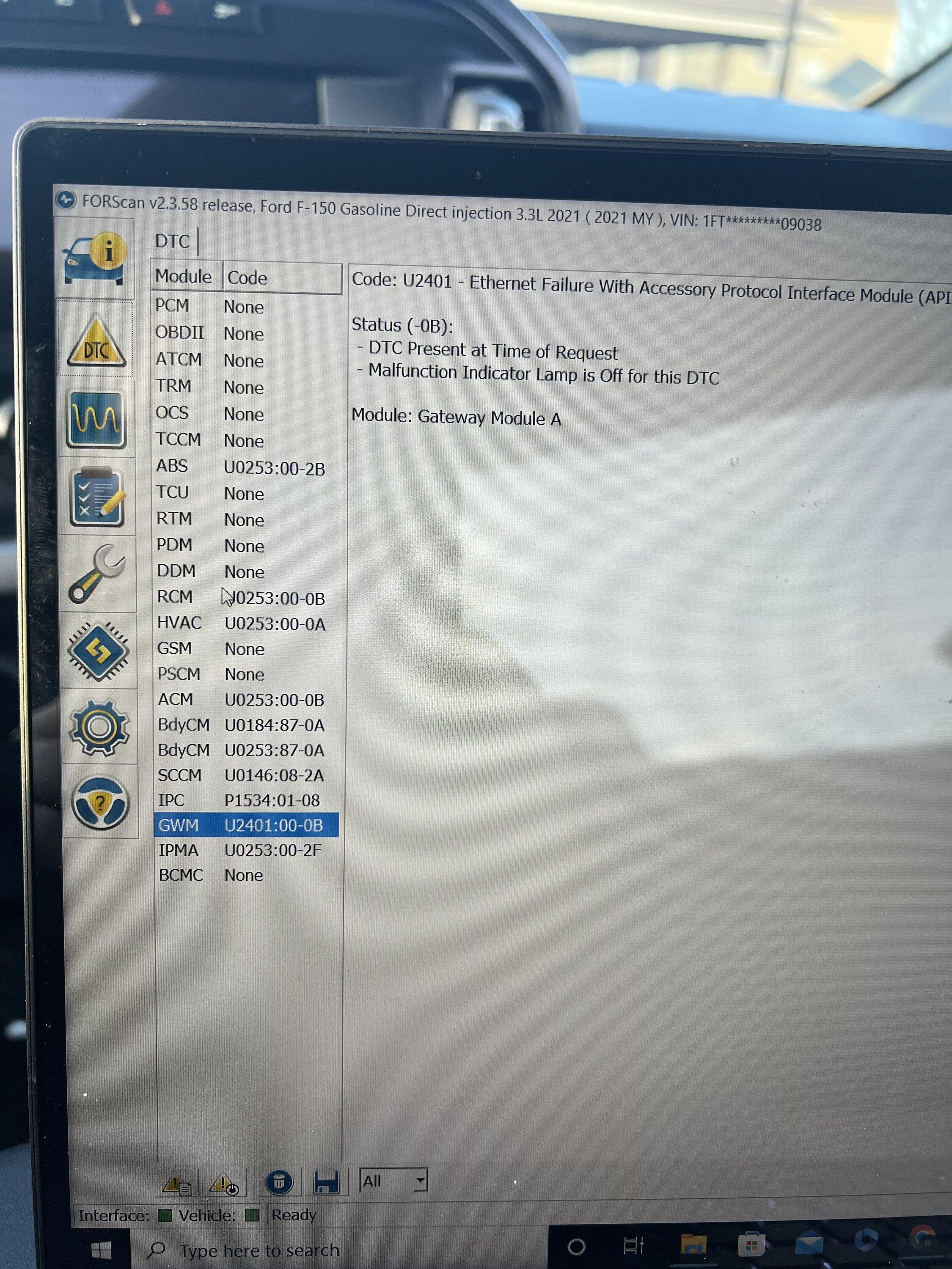

Thursday evening I drive my 2021 f150 xl and it's fine. Then Friday morning my screen is black. I haven't had any issues of random restarts or anything weird in the one month I've owned it. I try soft restarting on my way to work with pwoer and right seek. After work I pull and check fuses 15 and 32. They are fine as well as having voltage at them. Then did a hard reset of removing the fuse for a while.
Still no change. Screen is still black and no features work (back up camera and usb from the radio). I used forscan to see the modules and dtc. It show only lost communication with APIM in many modules. All attach the dtc in case it helps.
