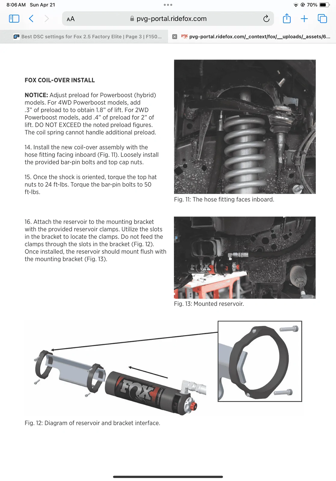

The picture in the install guide is smooth mine has threads ?

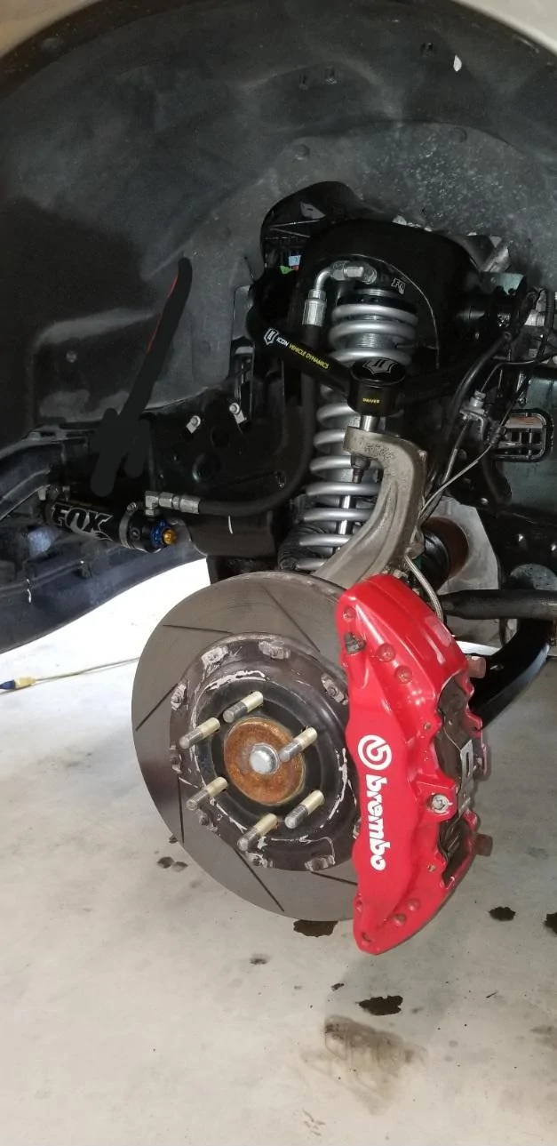

Although the geometry in the Gen14 is different than Gen13, I don't know by how much.
I located the reservoir pretty much where you appear to have placed yours.
Ford F-150 Best DSC settings for Fox 2.5 Factory Elite 20240330_202941

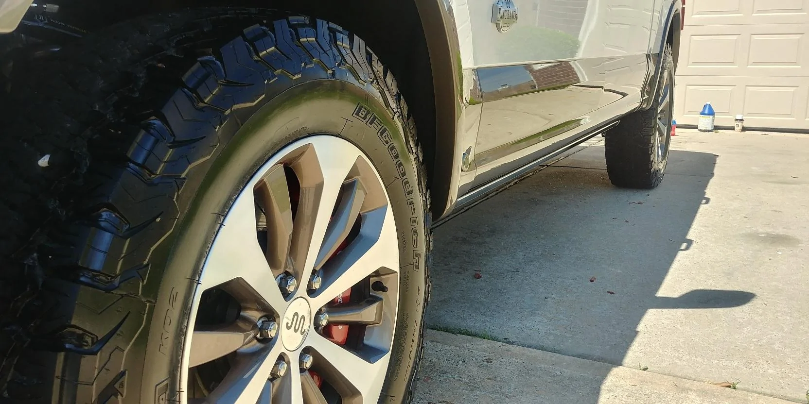

Because of the caliper (massive, compared to oem) I had to have some custom concentric hub spacers made to clear the OEM wheels. I think they were about 12-13mm? And my so called "35"'s were really 34.8 I believe?
Ford F-150 Best DSC settings for Fox 2.5 Factory Elite 20240421_081502
I had no rubbing issues.

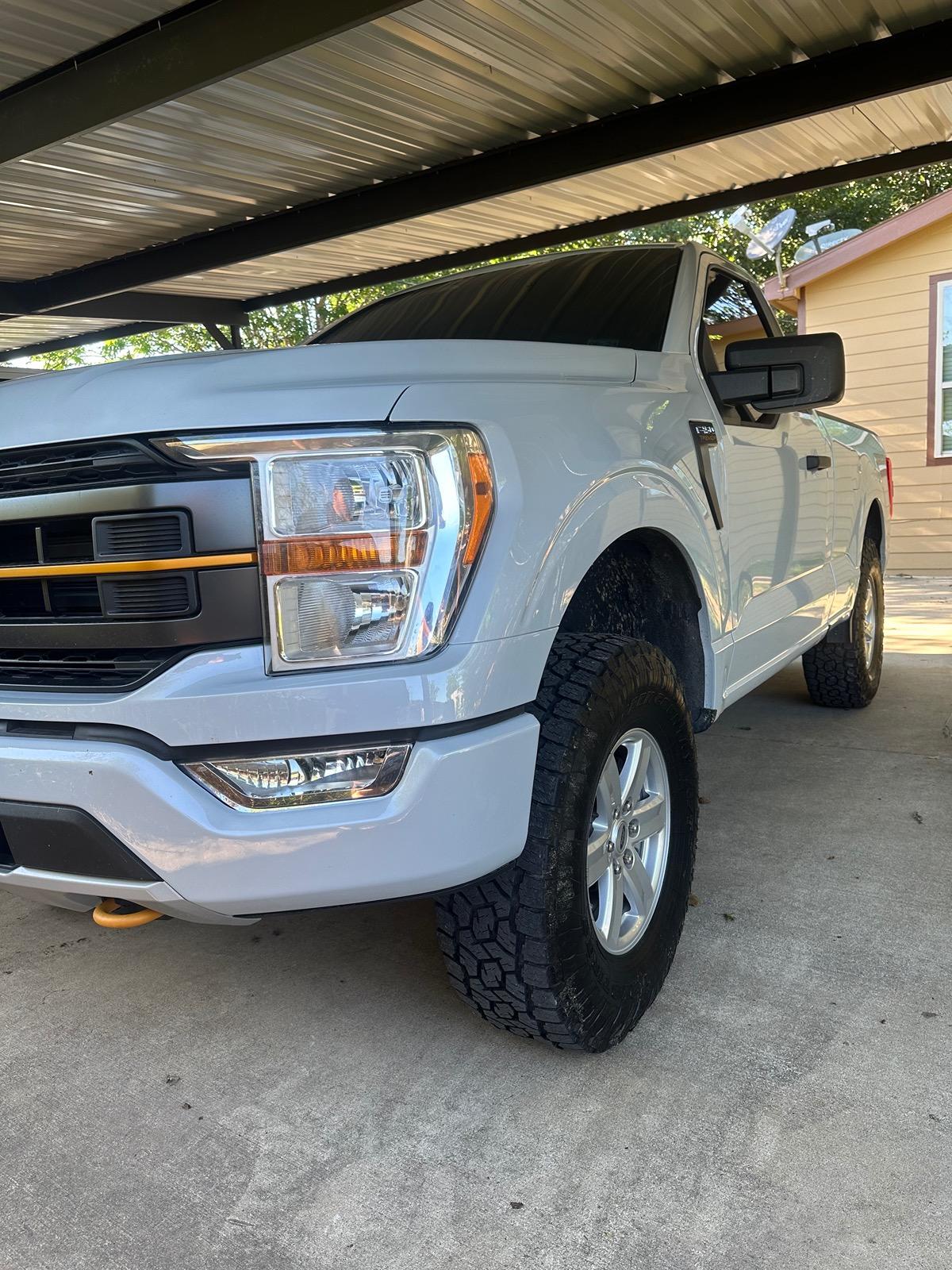

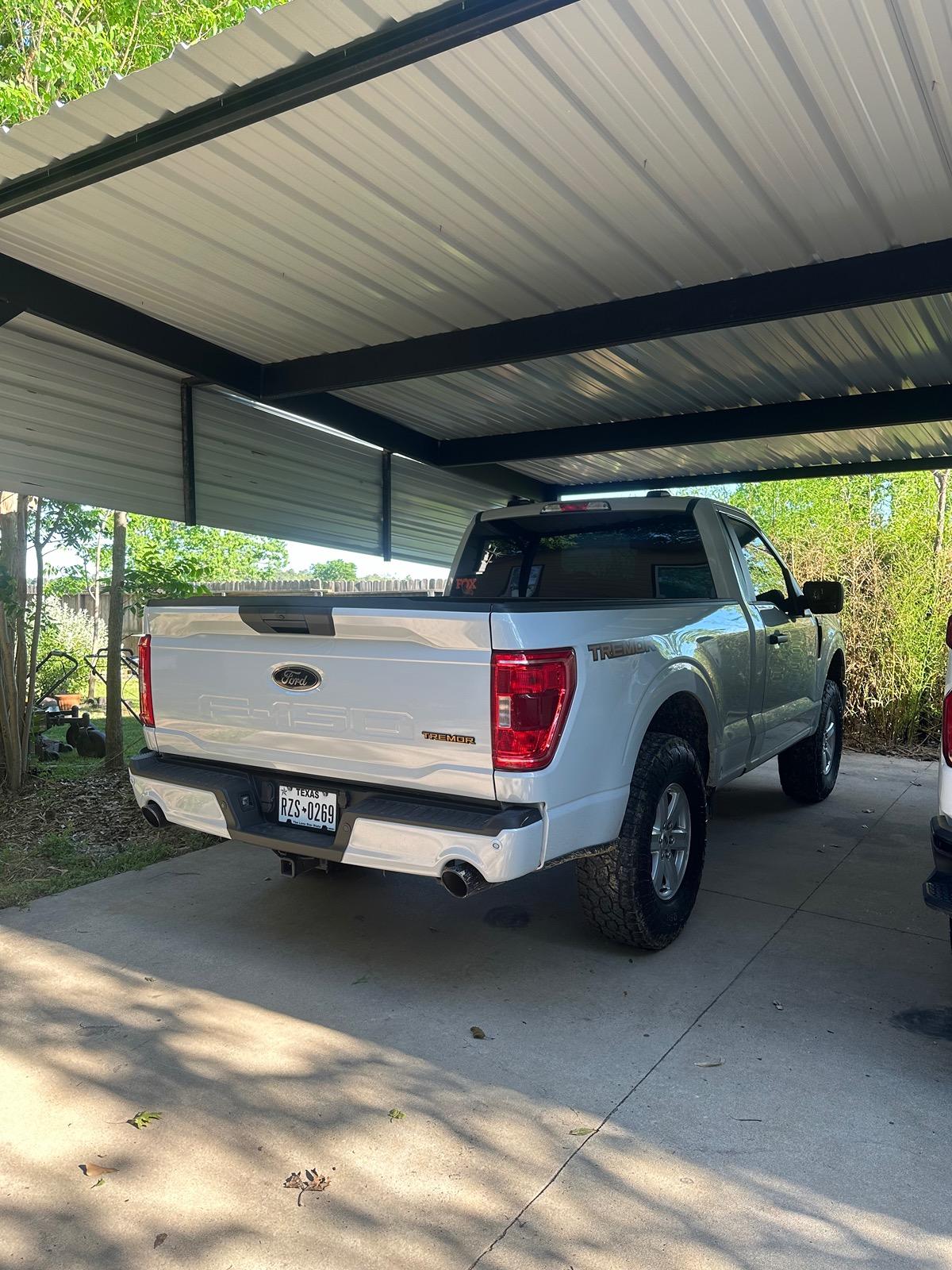

So did you get rubbing from your 35's even with the Icon upa?
JB’s 5.ohhh
Juan
Feb 4, 2024
2022 F-150 5.0 regular cab
HVAC
Well I’ve had 35’s on for 2 yrs and no rubbing at all(with a 2.5 inch level kit), and I can fully turn with no problem. I’ll have to see if placing the reservoir on the same spot will rub or get in the way.

Hard to tell but almost like the hose was a bit short? Picture in the install manual looks like they sit further forward?

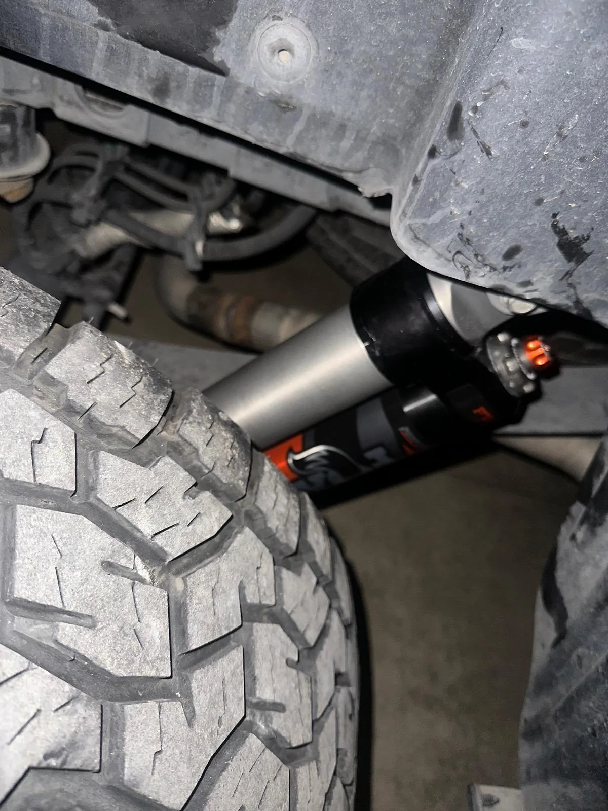

So turns out the hose for the reservoirs was too short to mount above the coilovers. It prob could’ve been mounted there but I wasn’t taking any chances by overstretching the hose and perhaps damaging it. So it had to be mounted as far as possible right above the skid plate(same spot as picture). 35x11.5x17r toyo at3’s clear with no issue and don’t rub at full turn AT ALL. Just kinda worried because the DSC adjuster knobs are about 1” away from the tire at full turn. Now the Icon UCA are great, they don’t rub either and give the strut enough space to not rub. So far still playing around with the settings and trying to find what’s best for me. Also noticed my coilovers might have arrived with more than a 2” lift because now the front sits at 42” and the rear at 40” 3/4”. Now I did also remove the rear blocks a while back, but I’m thinking of putting them on to try and fully level the truck. Any recommendations on what settings are pillowy on road but will handle the terrible potholes here in Houston?(lol Iykyk)
