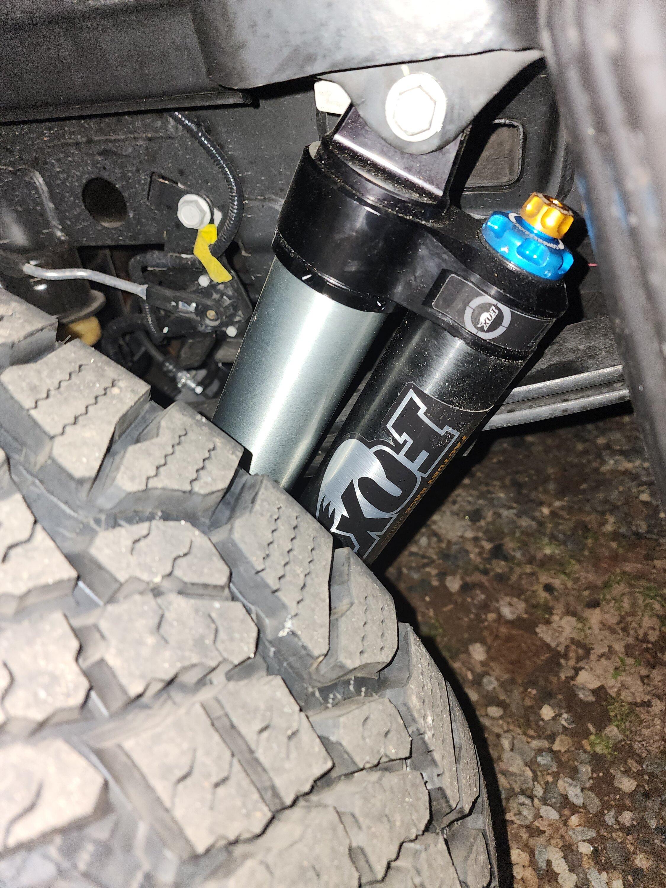

Hey there. I just installed the fox 2.5 front and rear on my Powerboost today. I bought the 15-20 kit from stage3 and dealt with frank. Great guy to talk through the purchase. The springs that come with the coilovers are eibach 550 lb. I had to adjust the colar on the coil over to get 2" of lift. I adjusted them on the truck with spring compressors. Originally there were 3/8" of thread showing and I bumped it up to 7/8". This gave me the 2" lift. I have maintained 1" rake but expect that to increase slightly as the shocks settle in.
The ride is great so far. Very compliant on the road. I have both high and low speed compression settings half way at the moment and will adjust more as I take it off road.

Thanks! I did not. I am playing with the settings now. Middle of the clicks for road seem to be good so far. The rear doesn't jump around anymore when there's chatter in the road so, the 2.5's with these settings are keeping the rear at bay.

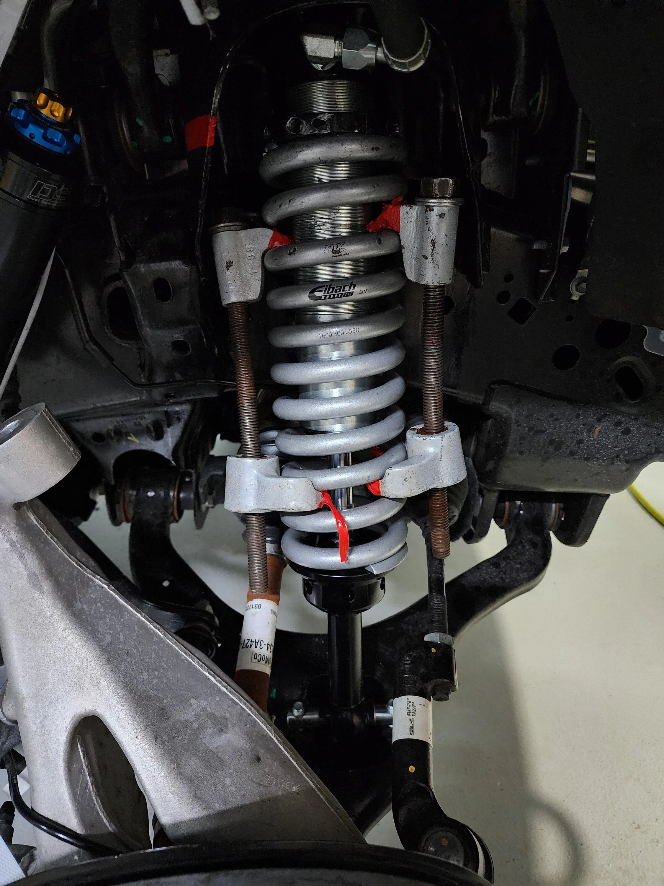

@YzermanTopShelf Nice looking truck. I can add my brief experience with the Fox 2.5.
I have them on my 21 PB, leadfoot Lariat, coincidentally. I've put 1000 miles on them and the previous owner (Not sure if he is on this site) put 10k miles on them. They still look new, no signs of corrosion. I've previously run Bilstein shocks and the Fox feel similar: well damped on bigger bumps, potholes, etc. Perhaps a little sharper on the small stuff, but that might be from the LT Ridge Grapplers.
Mine are set with 3/4" of thread above the collar in the front. That's 38.75" from ground to the bottom of the front fender and 40.75" in the rear (max tow). So not leveled, but improved clearance up front and lost some of the OEM max tow jacked-up look.
Overall, I'm happy with the setup and at the moment I don't think I would change anything.
Ford F-150 Fox 2.5 Coilovers on a Powerboost? F150 221225 Fox 2.5 front
Ford F-150 Fox 2.5 Coilovers on a Powerboost? F150 221225 Front qtr
