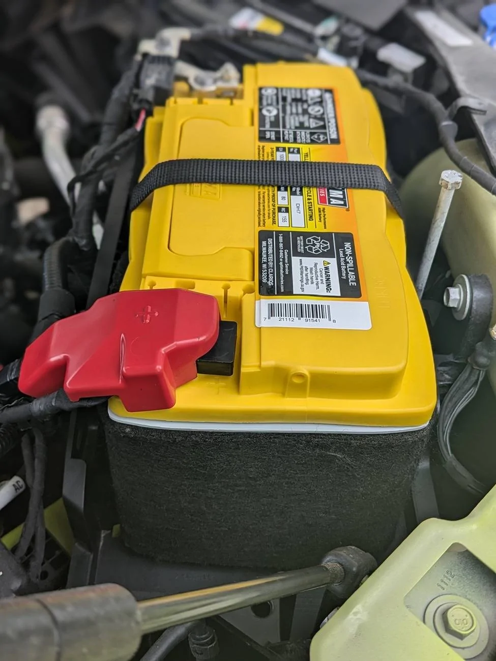

Picked up the largest battery Optima made in a Yellow Top, which is an H7 from O'Reillys as I get a large discount on them. My truck originally had an H6 in it. Got the battery tray all cleaned up and wiped down as well as the new battery. The old blanket fit the Optima battery fine, so I re-used it. Did the BMS reset, road tested around the block, and cleared faults from all the modules with my scan tool. All good to go. Hopefully no more deep sleep and low voltage issues. Thanks for all the help!

It actually lives outside for the most part. I just try my best to keep it clean when I can. lol Yes, it came that color from the factory. :)
