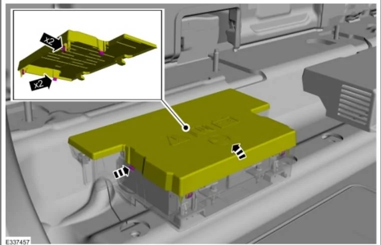

I humbly request the proper technique for prying the auxiliary battery cover off?
I can see the 6 clip points on my cover, and they coincide with the service manual diagram.
But I can't tell if I should pry out&up?
Or just up?
Don't want to break the plastic. ?
Put on gloves, run fingers down to the edges that overhang, YANK.
If you have a 90 degree screwdriver it can slip under that edge for prying off. Gets easier the more you do it. Front lifts up, back is quasi hinge style, you can see those sticking down in the image. Front lifts up 40ish degrees and slides to you.
