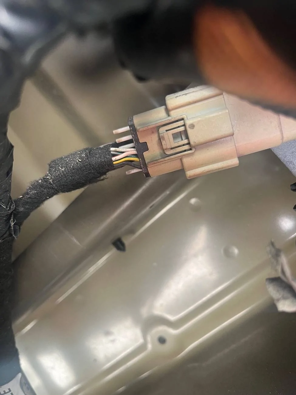

New member here with a 2023 F150 Platinum Powerboost. Can someone help me confirm whether I'm looking at the correct harness here? I want to add TPMS to my buggy hauler trailer - don't care about the camera, just looking for TPMS.
That does appear to be connector C439, and in your case it appears to be 'fully populated' with the wires required for both TPMS and cam. (y)
C439 being what will plug directly into the replacement 7+12-pin bumper socket you'll get with the TPMS kit.
If the 'connector' it's plugged into (under your finger) is simply a 'blank holder' with no wires beyond, that's it for sure.

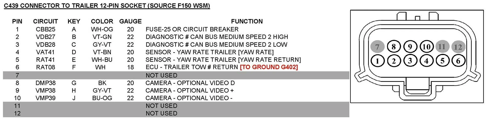

@Broke Richard , here just FYI is a diagram to let you confirm you already have all of the wires to support your need ....

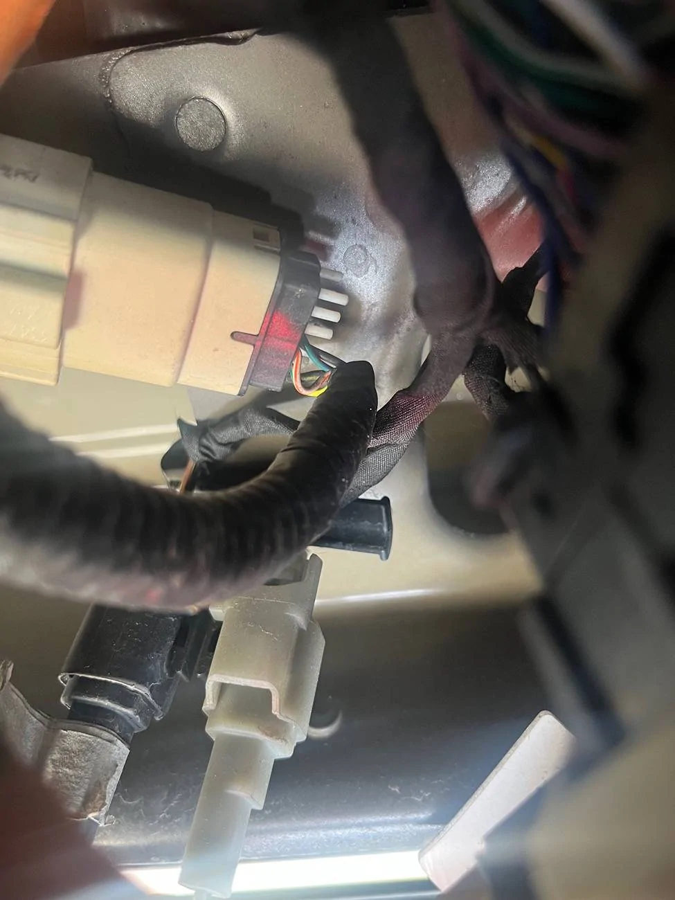

Can I get some advice on part numbers and the least I need to purchase to get trailer camera to work?
I want to use the prewired camera and existing 12 pin connector without buying the full Ford kit. Otherwise a $100 wireless camera makes more sense.My trailer is wired with 12 pin connector, but I don't have the tow tech package. Currently, I have the 7/4 socket and the following wiring underneath.
You want to use the prewired camera, as in the one that came on your trailer? I think it won't work. A $100 wireless camera probably makes more sense, considering your requirements.

The stock wireless camera was replaced with this and wired. It looks like a Ford camera, but can't confirm. That's why I want to see if I can tap into the existing 12 pin harness already routed to the hitch.

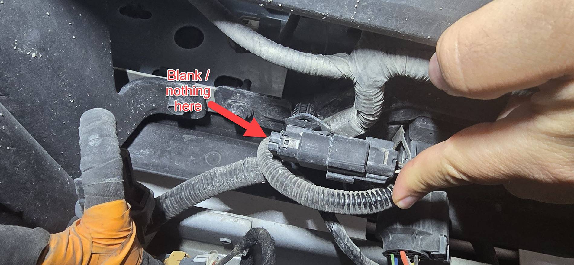

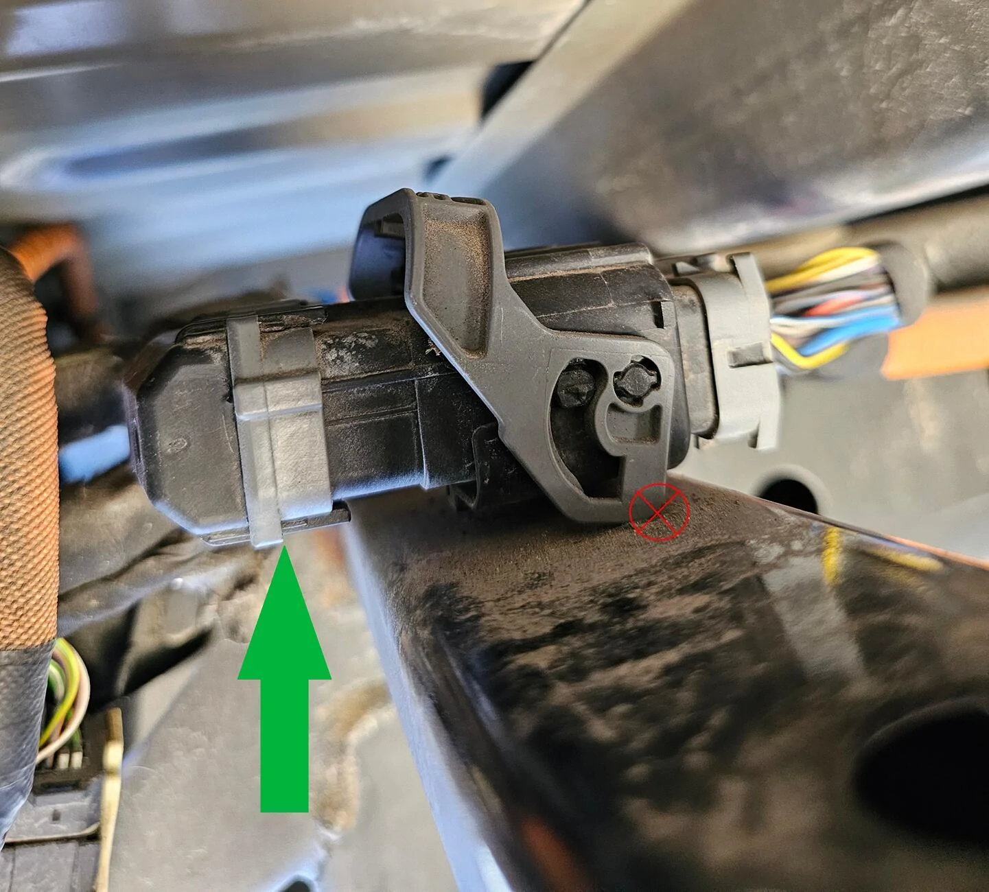

I'm not finding the 'stowed' C439 in any of your pics. That needs to be located and the number of wires into it counted to determine what you may need. Go back and look for that, these pics may help in your search:

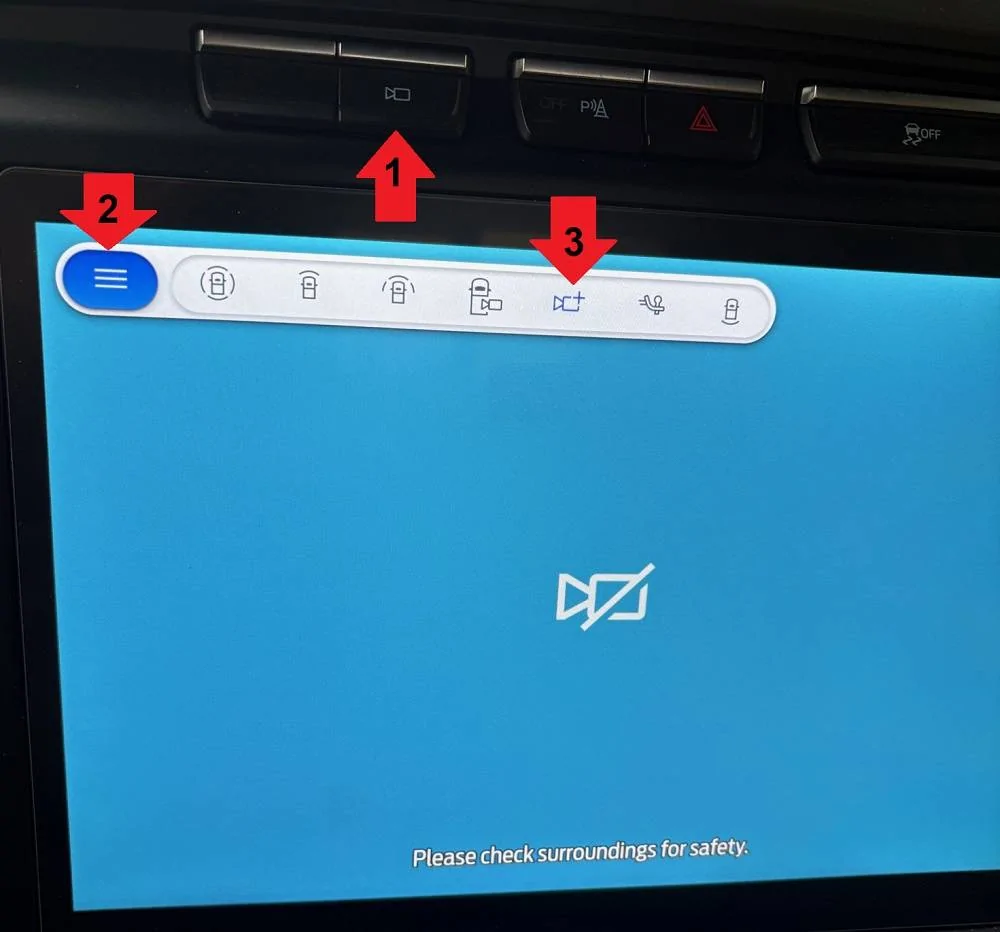

While you're at it, please confirm that you have the following on your 12" display screen menu as it is now without the trailer cam connected (you don't need the tow technology package but you do need the 360-degree cams package, this is required to display the trailer cam view when it is connected):

I can’t find it. Possible it’s not there at all?
No 360 cam package, base 500A Lariat.
