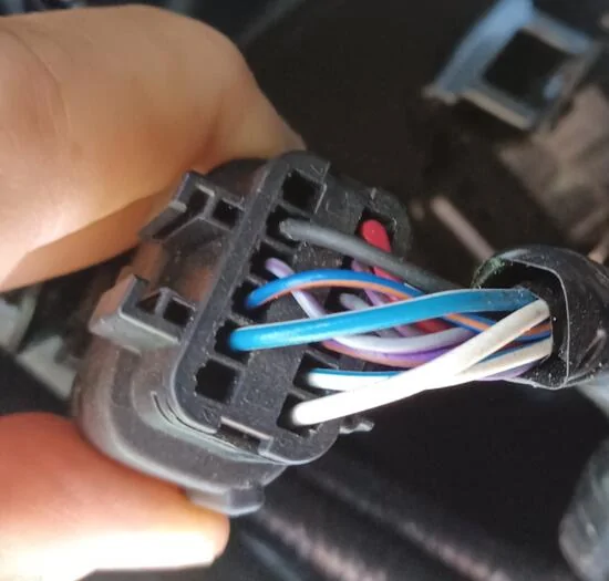

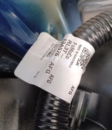

The truck side harness with the 12 pin connector on my August built 2024 XLT with tow package and 360 degree cameras is a new revision. The part number on the harness tag is RL3T-13A576-AFG. In this harness, C439 (the truck side 12 pin connector) has wiring to 10 of the 12 terminals. The new wire is pinned to terminal 11 and is a blue wire with a white stripe. It is a heavier gauge than the other wires. Does anyone know what its for?
Ford F-150 Any update on a Trailer TPMS system? 1741614730965-87
Ford F-150 Any update on a Trailer TPMS system? 1741614639555-

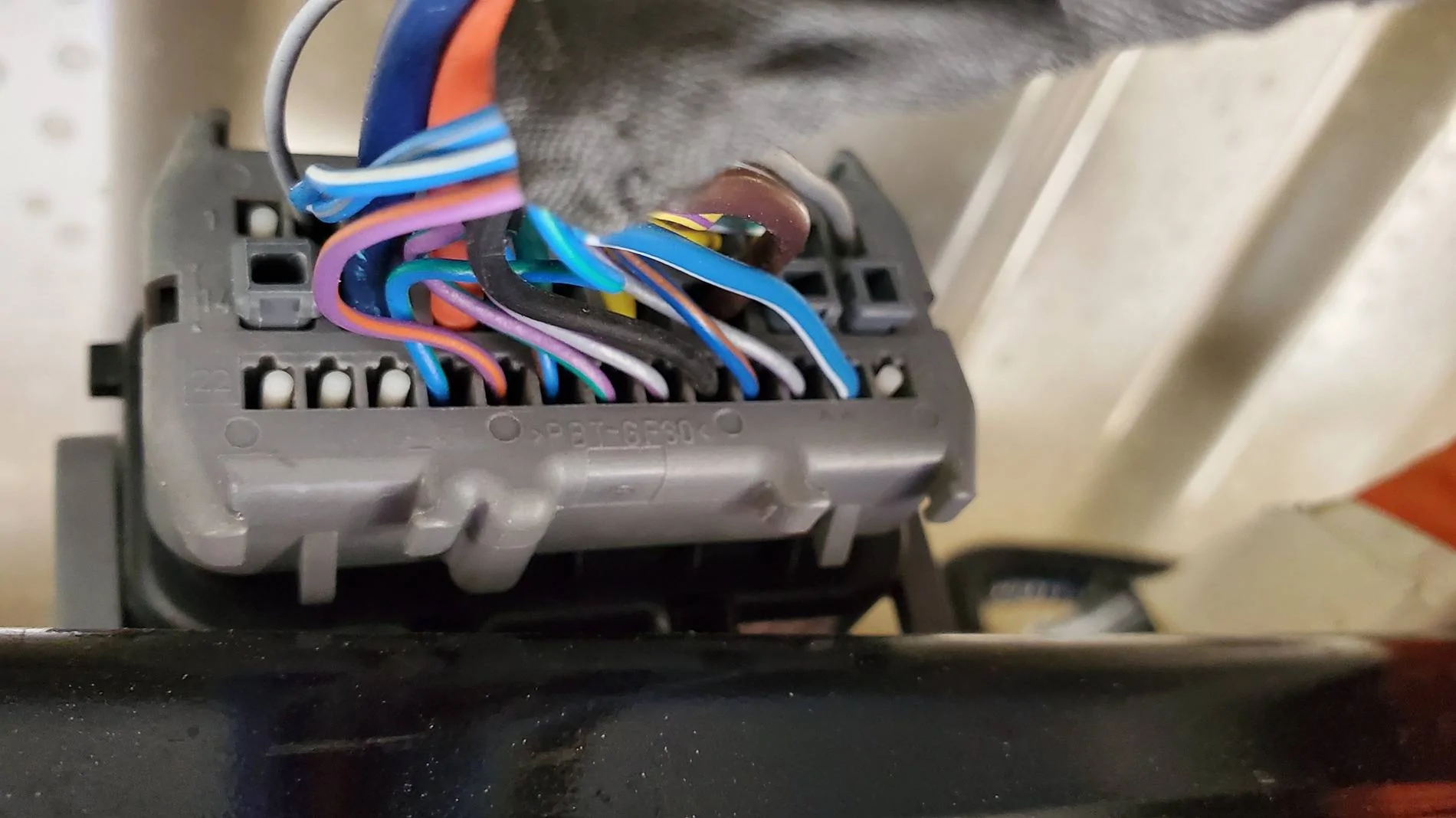

The truck side harness with the 12 pin connector on my August built 2024 XLT with tow package is a new revision. The part number on the harness tag is RL3T-13A576-AFG. In this harness, C439 (the truck side 12 pin connector) has wiring to 10 of the 12 terminals. The new wire is pinned to terminal 11 and is a blue wire with a white stripe. It is a heavier gauge than the other wires. Does anyone know what its for?
I do not have the answer, but it is good to see they included the C439 connector at all in your build. My 2024 Lariat 501A with 360 cameras and tow package did not even have the C439 and I had to repin the C423 and make my own patch cable with a Molex C439.
This is a photo of the truck side of my C423 connector and I can see this blue/white wire in pin 33 (just left of the lower right corner). I assume that's the same one.
Ford F-150 Any update on a Trailer TPMS system? 20240707_115727
However, there is nothing on the Super duty camera+TPMS+yaw set that I installed that would use this additional wire. Perhaps newer camera packages have something additional.
