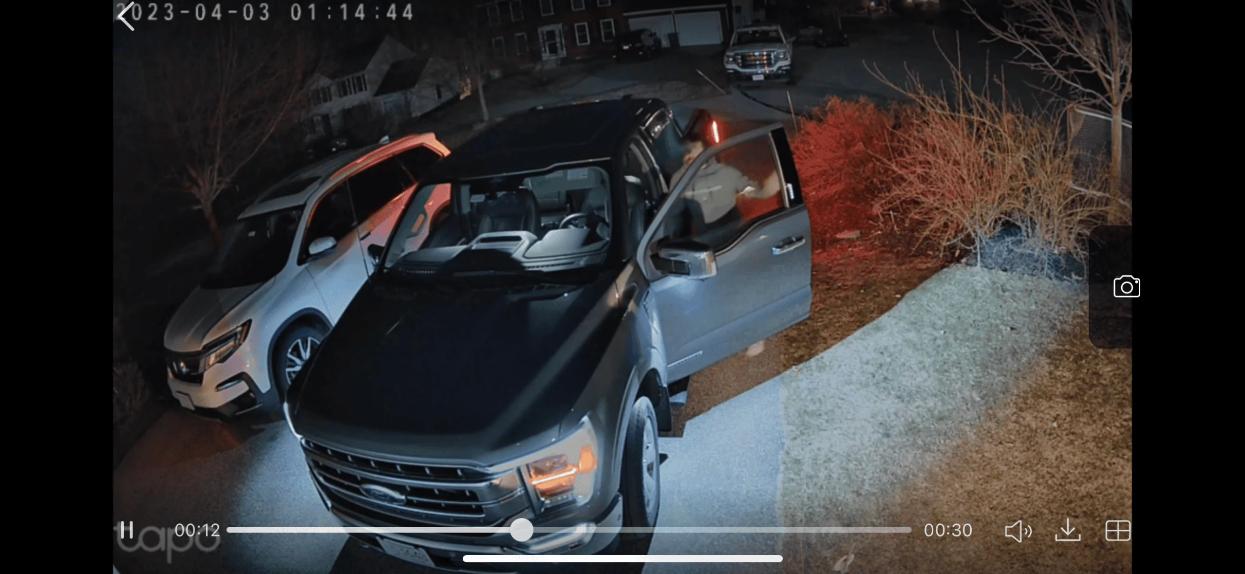

Looks like my Secure Alert is about 16 seconds behind real time according to the time on my cameras. Close enough for me
Ford F-150 Any news on when SecuriAlert will return? IMG_8874
Ford F-150 Any news on when SecuriAlert will return? IMG_8877
