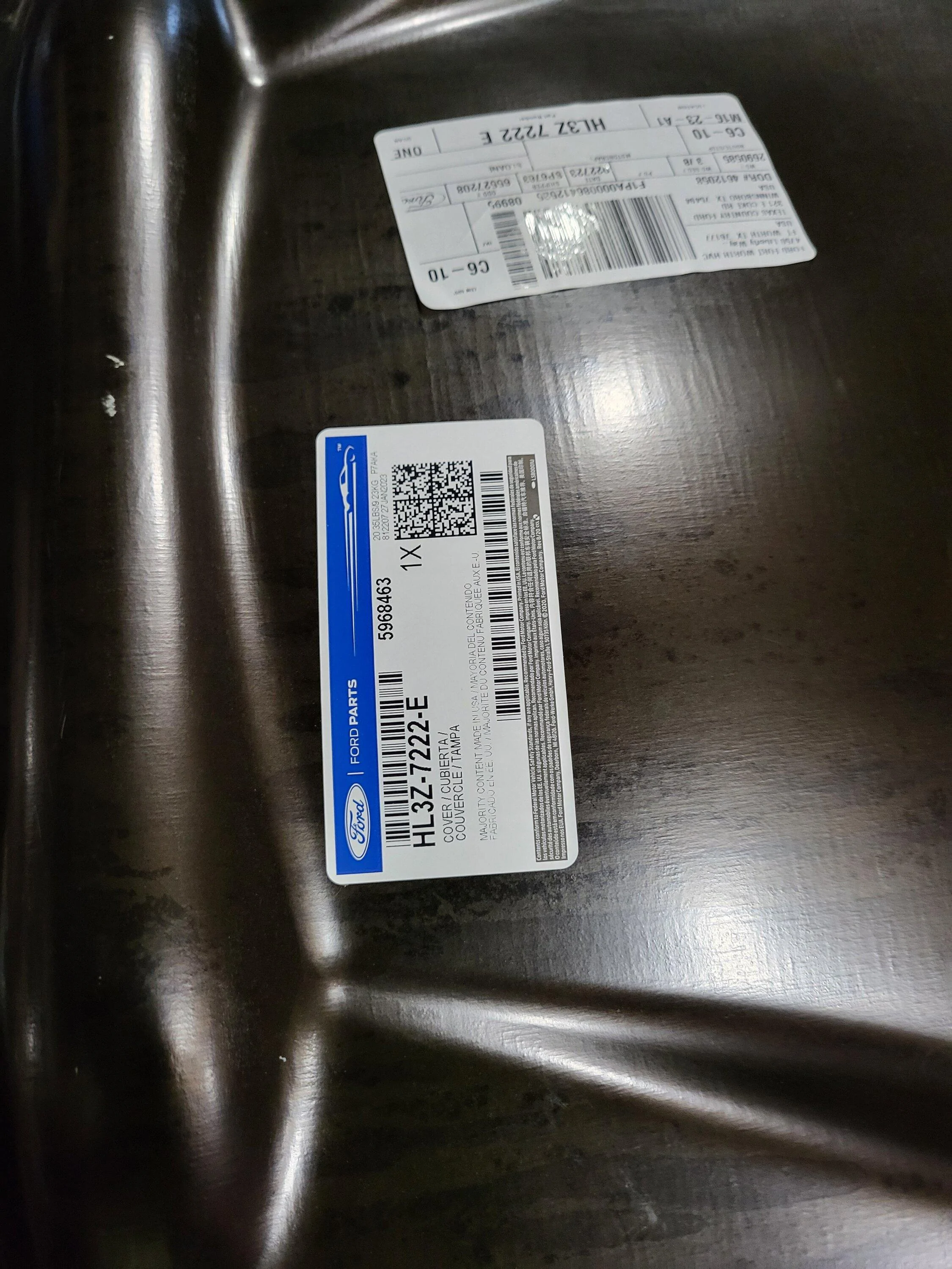

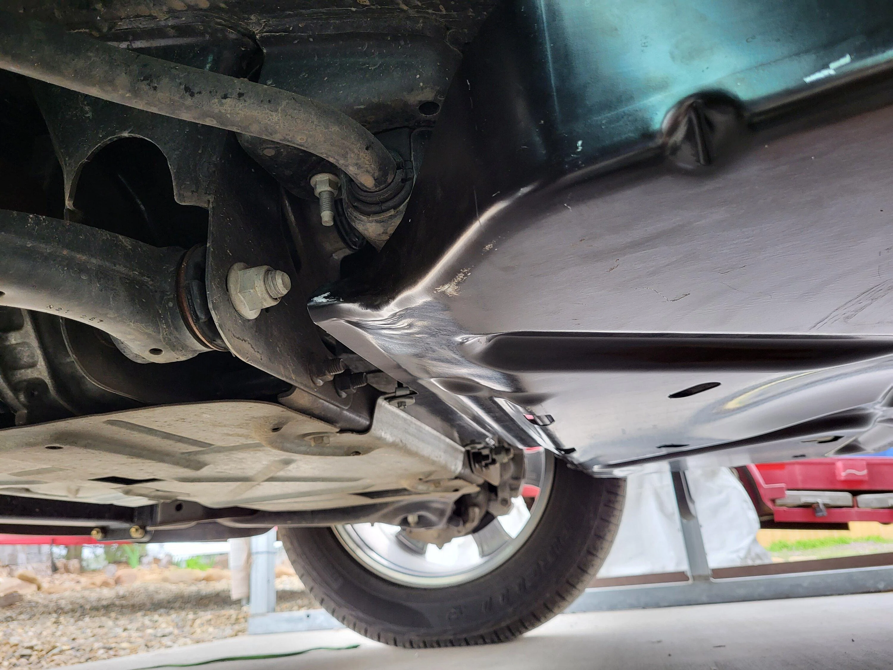

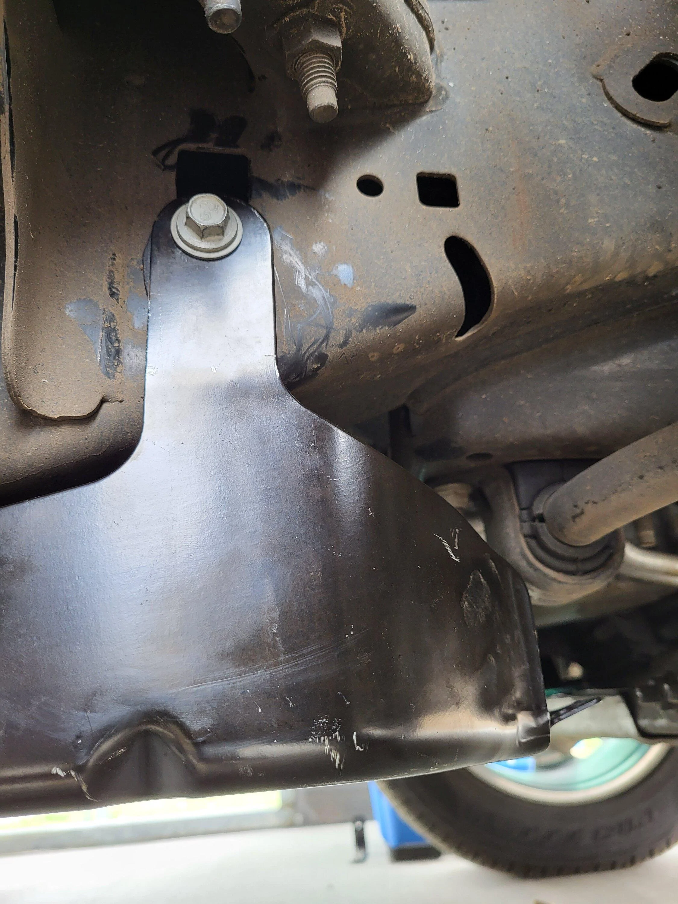

i put on the ford steel plate cover used on other models
i was going to do RCI, but i already had gas tank shield, engine and trans case
i dont do tons of off roading but wanted a tough option to stop road debris damage or potential for damage and make it harder to steal the cats
so far it has claimed one racoon

I was unaware Ford made legit skid plates. I thought all of them were the flimsy ones on the FX4 package. Neat. So you are overall happy with them? Self installation easy enough?
less than 5 minutes to install
only i did not do the oil drain cover as its really not needed and instead fashioned one from the old felt cover
the pan bolts to the 10mm bolts in front and 4 bolts on the frame
some f150 are missing the front frame holes, but i believe all 22 and up have the holes, you can use the existing bolts for the felt cover (rear ones and order 2 more for the front ears that attach to the frame. easy as falling off a log
i was going the rci route, but IMO ordering things that i already had seemed not frugal enough.
if the truck had no skid plates, i would have gone the full rci route
search here, there is a whole thread on this pan, another member here found it and did all the research.
