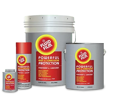

Fluid Film - I use this on the underside of whole truck. This works. Apply about every year.
I think the OP was trying to avoid FF to keep dirt from sticking to the shock.

You will get a little bit of dirt, but no rust. I rather have a bit of dirt than rust.
you can wipe off the dirt....

If that's the best solution I will go with that and just wipe them down in the spring. Just wasn't sure if there was a better solution that I wasn't aware of.

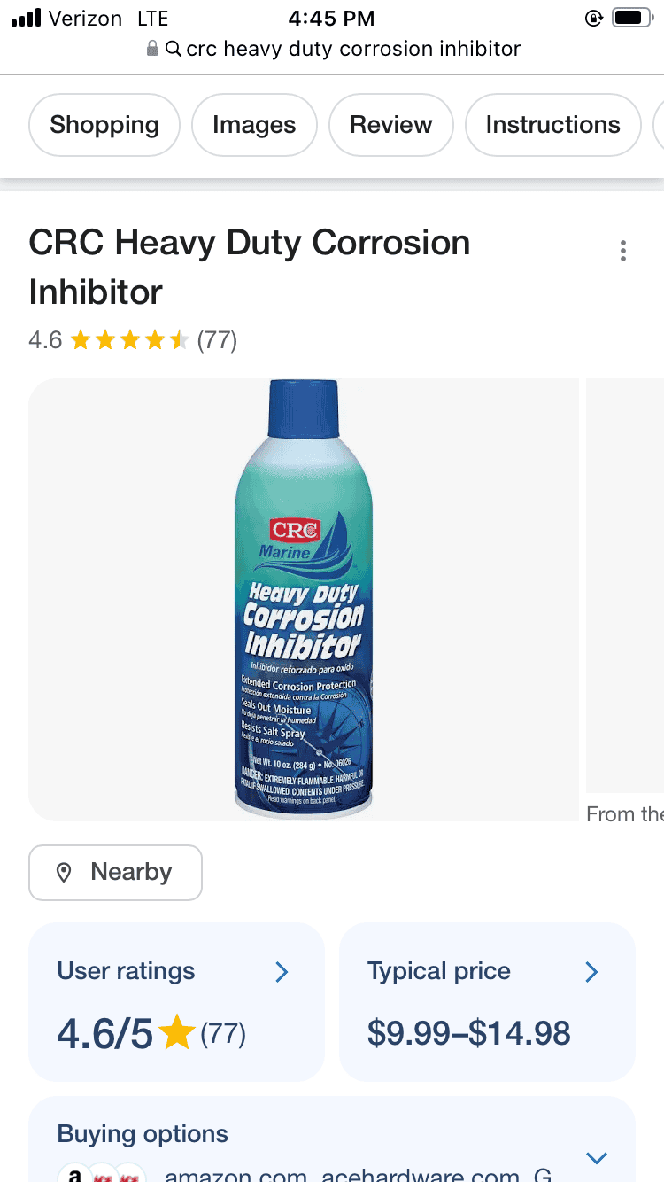

Has anyone ever used Mavcoat Steel Shield? It seems to be a cosmoline product (like the CRC corrosion inhibitor mentioned above), but it is clear which I like.
