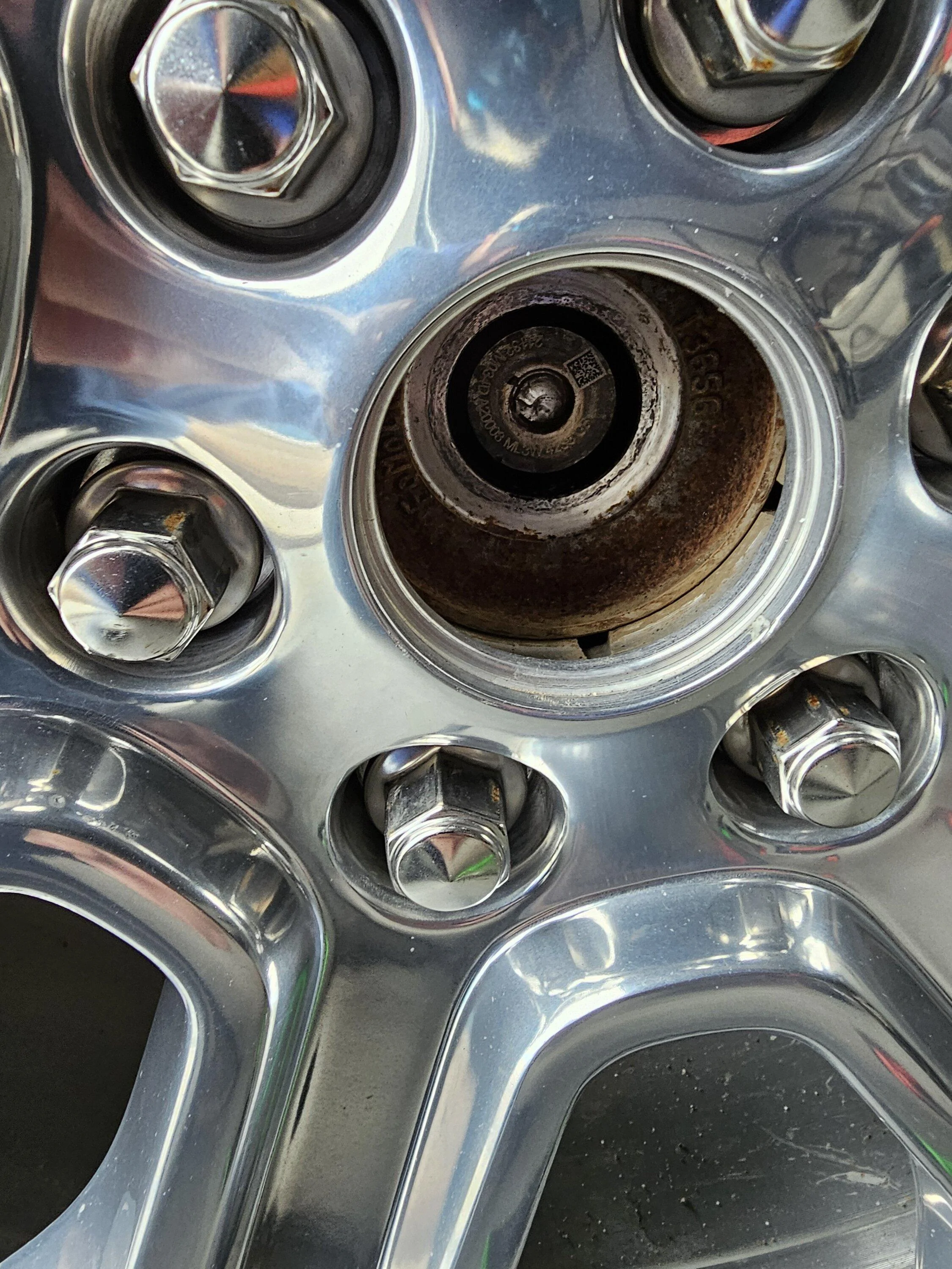

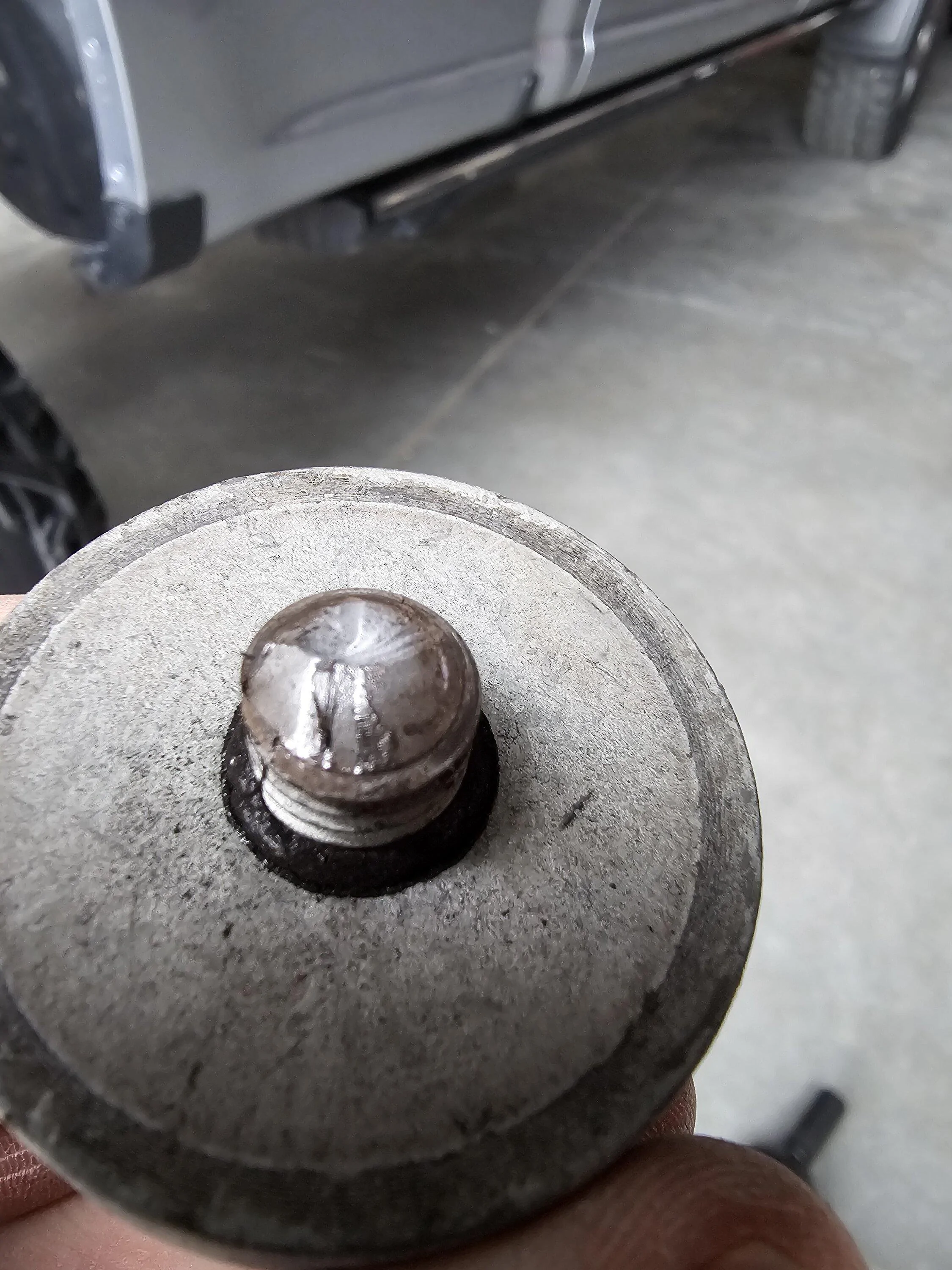

I decided to proactively replace the bolts. LH went good, but the RH broke off after a couple turns. Guess I'll let the dealer do the CSP now.

Did it break going in or coming out?
Man would I have liked to have seen a picture of the end of your axle when you removed that bolt.
Was the axle flush with the shoulder of the hub?
And the one that snapped, same question? It appears that it broke further down into the axle than many we have seen.
Looks like it broke about where the loctite is applied the the picture you provided of the new bolts. Just my uneducated opinion.
edit: maybe just a thread or two closer to the bolt head now that I look at it again.

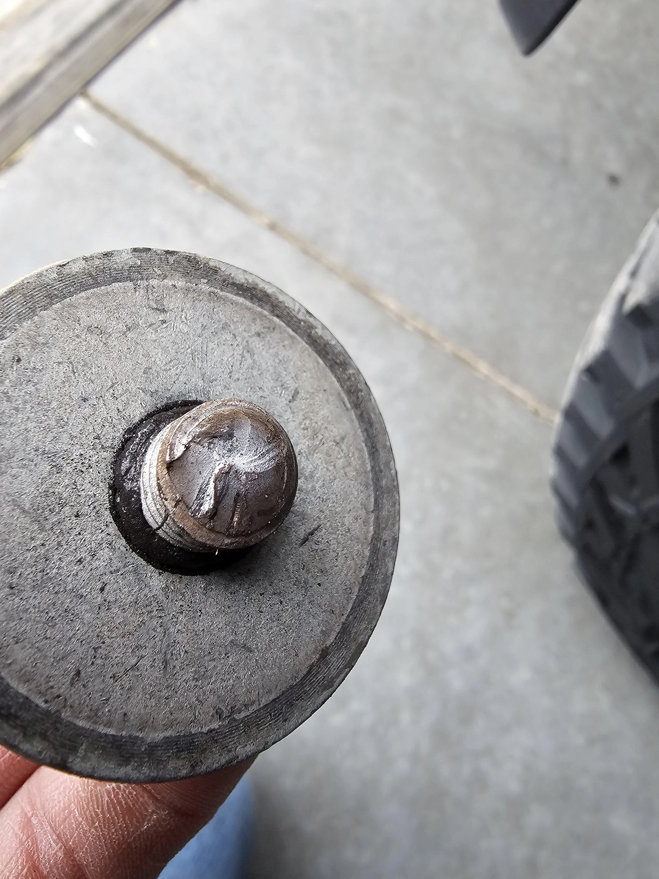

This is the only pic I took of the axle. Both sides looked the same and were not flush with the hub.
Thanks for the picture.
I'm always wondering why all these pics with broken or removed bolts show the axle NOT flush with the hub. It seems like as you torque the bolt it would draw the axle up against the washer and hub shoulder.
Or put another way, I have yet to see anything about the axle shaft itself that would stop it from coming outboard enough to seat against the bolt. So why are most of the pictures showing the axle inboard a few centimeters?
I guess it's possible that the axle wants to move inboard if the fastener/bolt isn't holding it from moving?
