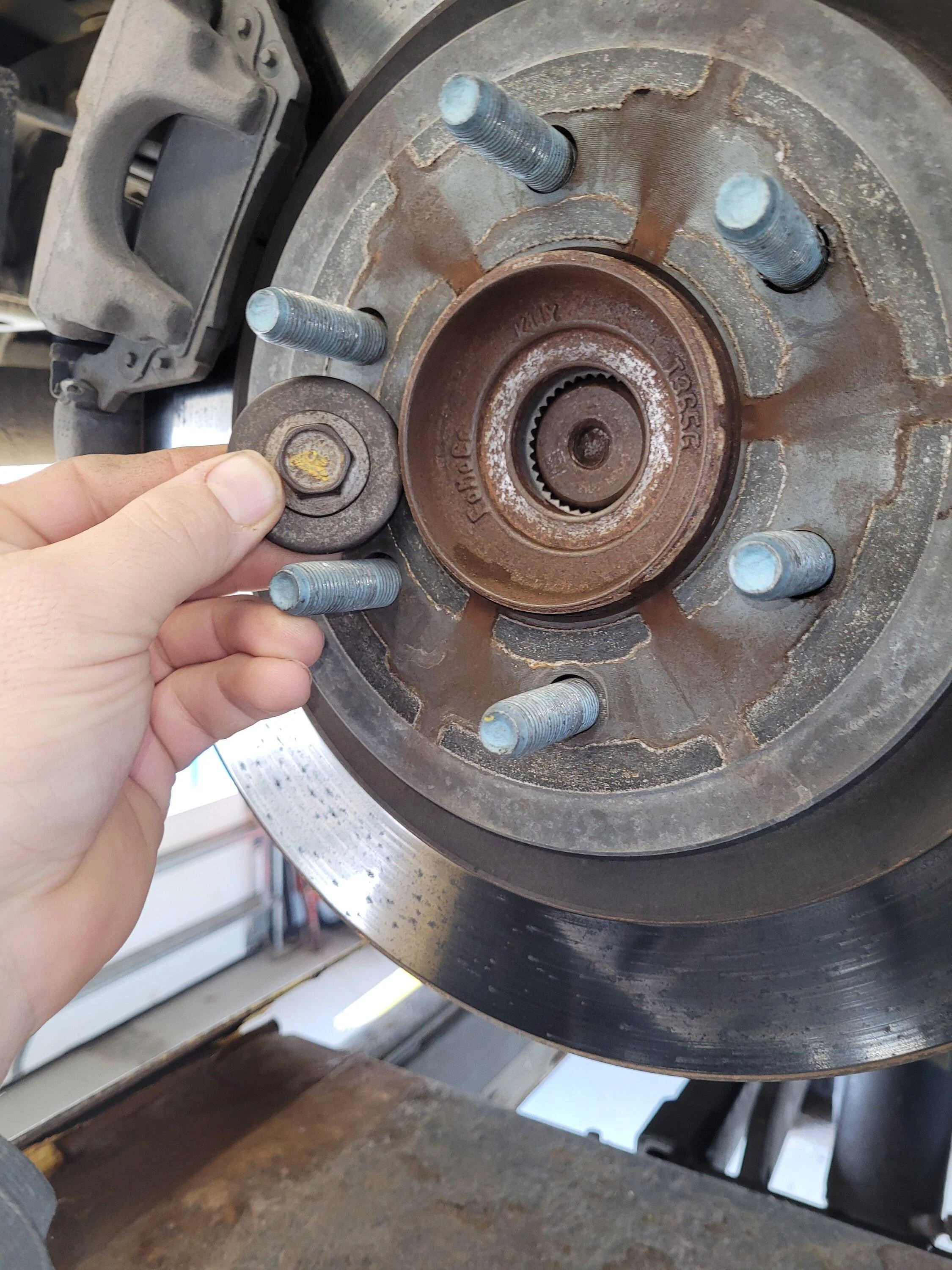

I lease a 2021 f150 with the heavy payload package with 30,000 miles and found this when the tire was pulled off passages side rear axle

HDPP or max tow? If max tow there is a bunch of threads on it. Sorry to hear it. Good luck
Yes, a Max Tow issue indeed. Fortunately the national backorder for replacement axle seems to have subsided, so you won't have the truck sitting in the dealership parking lot for weeks/months hopefully.
As stated previously, there's a couple of threads that already exist and one is tracking build dates to see if there's a time period that most of the affected trucks fit within.

HDPP or max tow?
Note that HDPP (option code 627) requires purchase of the separate Max Tow Package (option code 53C) so all HDPP (distinct from 2.7 Payload Package) also have Max Tow. The axle with the sometimes problematic bolt is actually a part of the Max Tow Package.

Note that HDPP (option code 627) requires purchase of the separate Max Tow Package (option code 53C). The axle with the sometimes problematic bolt is actually a part of the Max Tow Package.
Got it. Thanks
