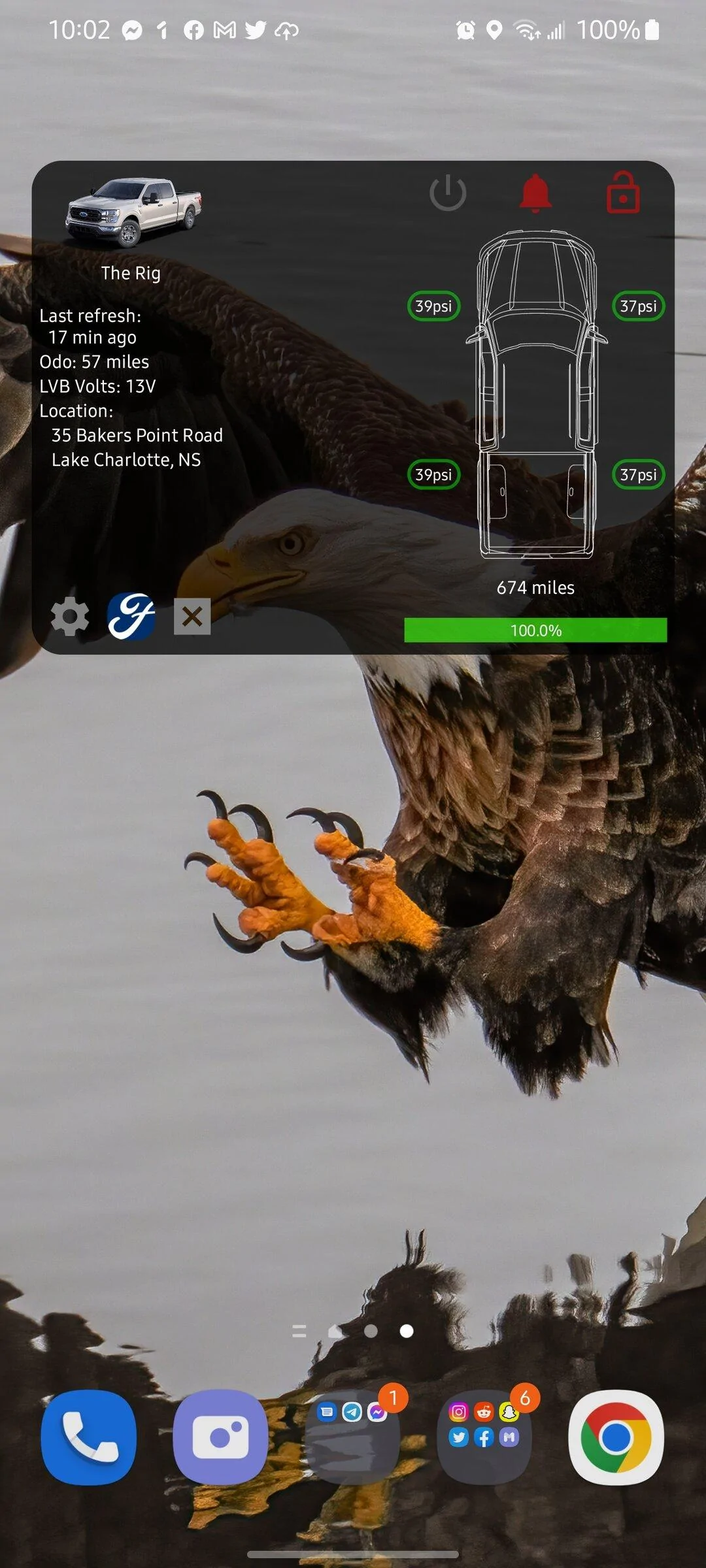

Canadian here. So I have units set to Fordpass, however it still shows miles vs kms in range.
A kms + psi option would be nice?
In settings you can choose Ford Pass units...I have mine set to KMS and PSI on my Ford Pass app.
I have kms and psi as well setup in the fordpass app, however on the widget it still shows miles for range.
How does your Ford Pass show the units? Ford Pass gets the units from the truck and the widget just uses those units. In the widget, under settings, near the bottom of the choices, select "Units to Display" and select "Use Ford Pass settings."
Fordpass is showing in psi and kms

Yup, thats how I have it. It switches the the tires to PSI but keeps the milage in miles. I logged out and in again. no change
I would uninstall the widget and reinstall it. Don't save settings, just make note of your VIN and login info. I have found that after some widget updates it is better to uninstall the old app first and then install the new one.

Ford F-150 Android widget 4
This is how mine shows.

Yup, that's how I have it. It switches the the tires to PSI but keeps the mileage in miles. I logged out and in again. no change
Congratulation! You win a free bug fix in the next release.
