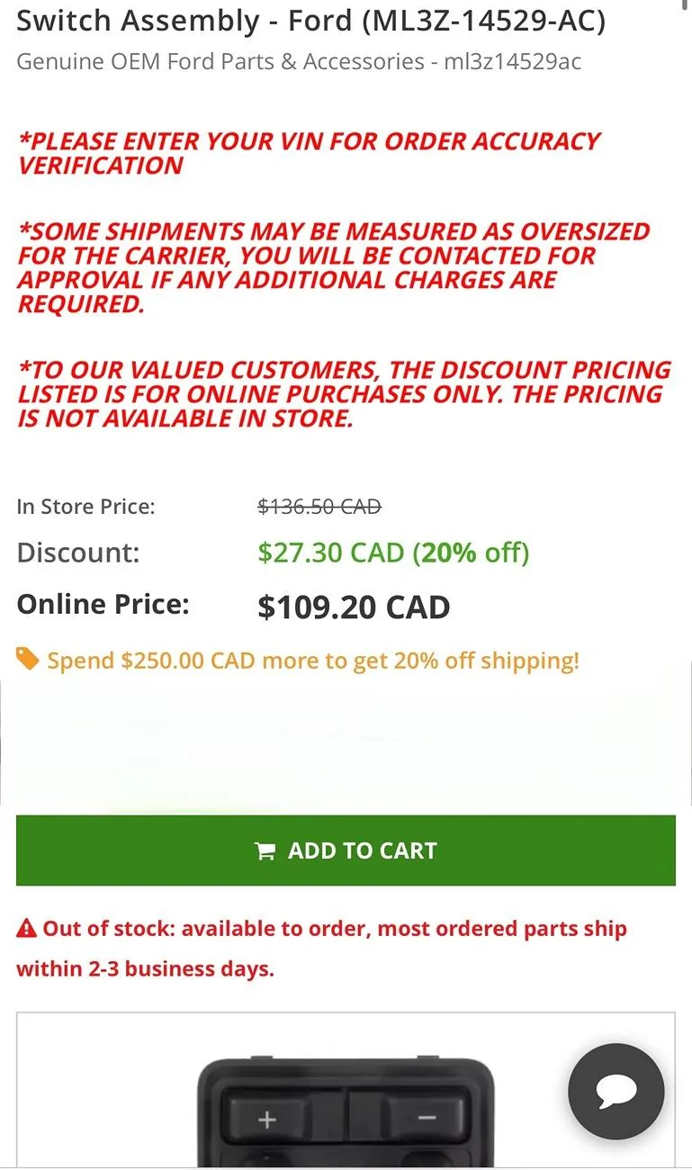

Thanks for that! As for the part numbers, it isn’t showing up on Ford’s parts website (I’m in Canada) but the following 2 below seems to show up without issues:
—Trailer Replacement Module (replaces under footwell): RL3Z-19H332-A
—Trailer Controller Switch (replaces coin holder): ML3Z-14529-AC
