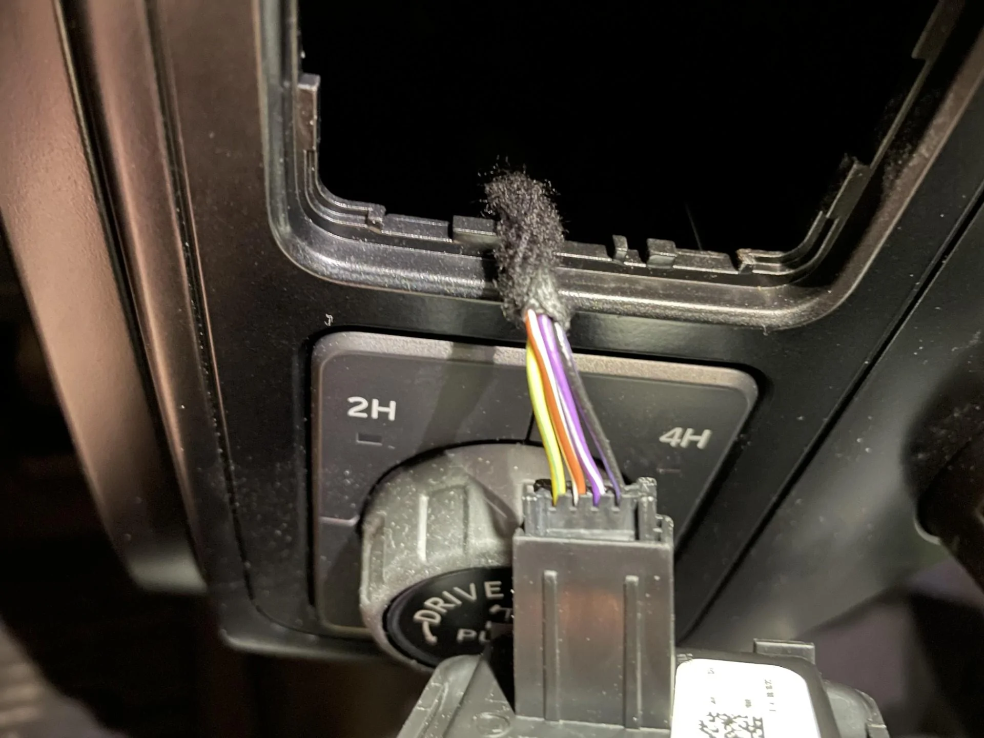

These steps worked for me, with the addition of saving the TRM as built data from the original module before swapping it, writing back the original as built data to the new TRM module after swapping it, and then adjusting the 791-01-02 6th character.
I appreciate this thread, I also just bought a 2024 STX last week, put the trailer brake controller into it a few days ago, and towed with it for the first time. Couldn't be happier.
