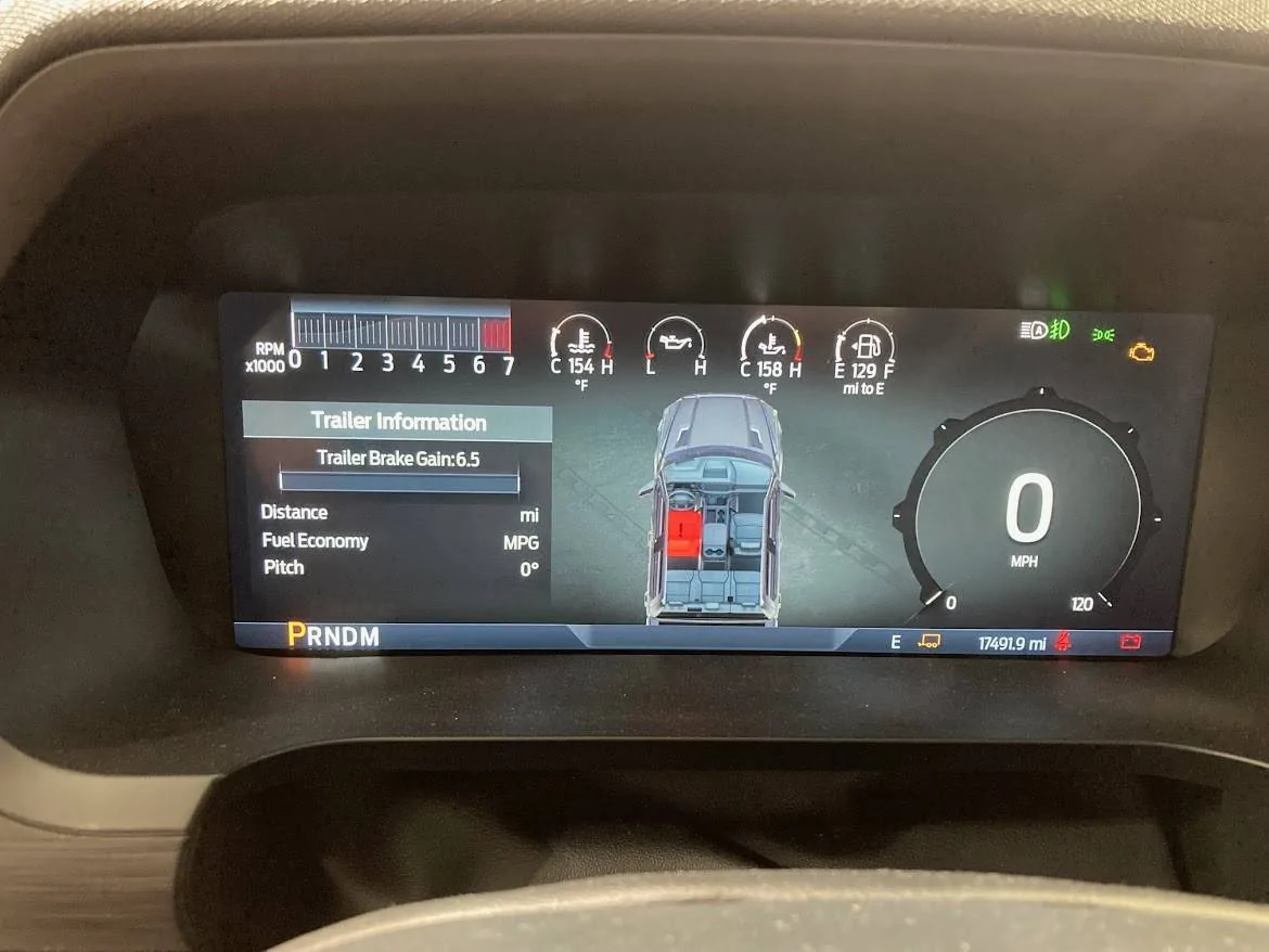

I used @haddad1 info from post #18
Parts:
Ford F-150 Add trailer brake controller to 2024 IMG_9444
Ford F-150 Add trailer brake controller to 2024 IMG_9551
Results:
Ford F-150 Add trailer brake controller to 2024 IMG_9565
Ford F-150 Add trailer brake controller to 2024 IMG_9568

Is that testing with trailer hooked up and does it work? I haven’t had a chance to test with trailer brakes yet.
I hooked up to my trailer and everything seemed to work, I didn't actually tow yet though.

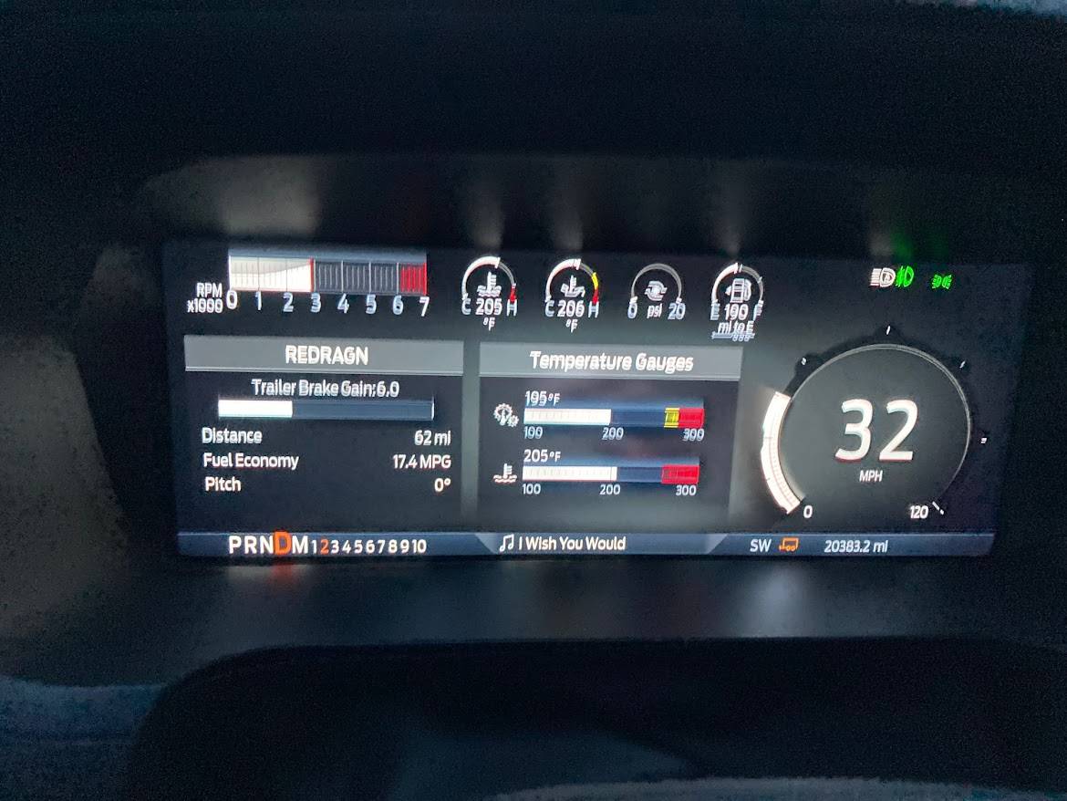

I'm wondering if something is wrong or is just fine and I don't need to worry. I wrote all the other values successfully, but when I go to write values to the TRM, I have letters instead of numbers. The trailer brake controller seems to work anyway. It shows gain adjustments and 'no trailer' when I squeeze the brake lever. Do I need to worry? Thanks!
Mine looks like this...its probably not the "right" way but everything works as it should...
Ford F-150 Add trailer brake controller to 2024 IMG_9807
Ford F-150 Add trailer brake controller to 2024 IMG_9804

Thanks Regragn, Your pic indicates a gain of 6 with the white bar below it on the guages. Mine shows the number value but the white bar never slides right , it shows zero always. Going out to swap the modules now...
