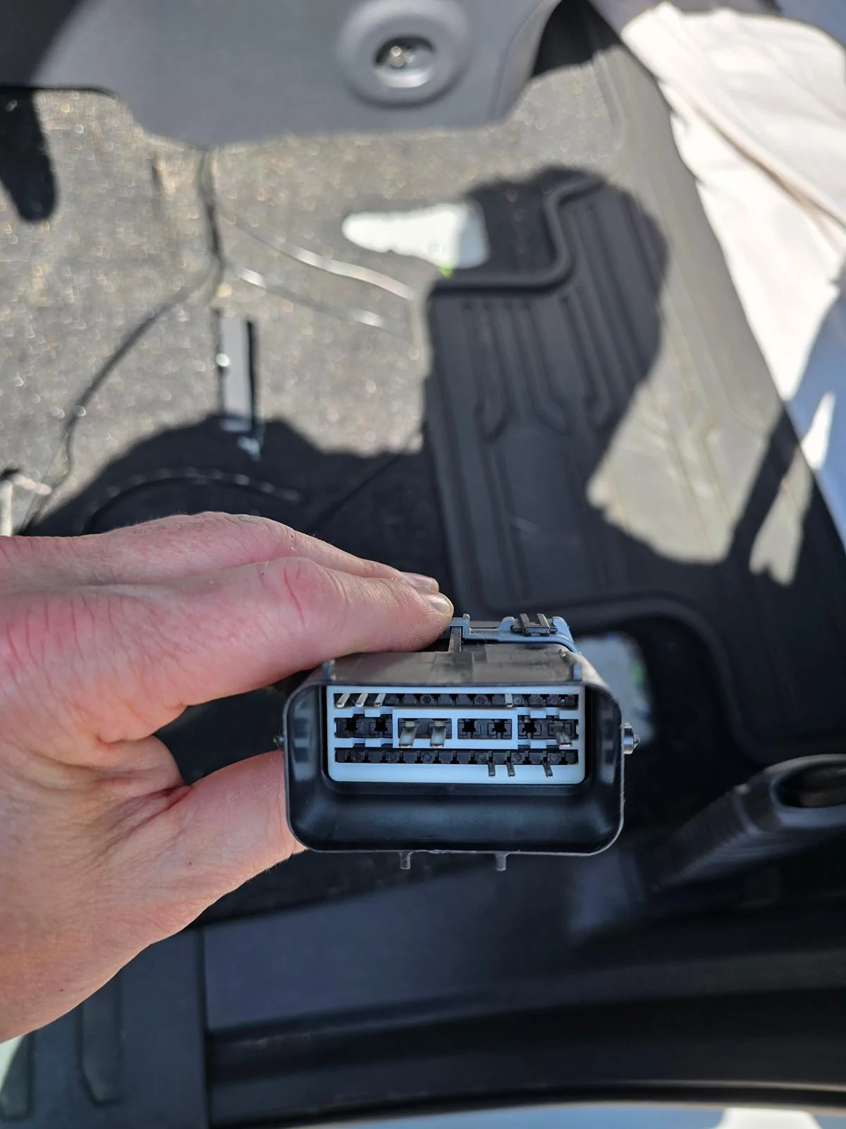

Hey @cash31 money, attached is a picture of the truck side and seat wiring from heated seats. If you have all these pins, I would imagine heat will work with either or both HVAC controller or Sync Unreal screen (if enabled). I will PM you my HVAC ASBuilt which supported only heated seats to compare with yours.
BTW, I am working with @HammaMan to change my seats to cooled and heated so my HVAC controller with heated seat buttons will be available soon.
