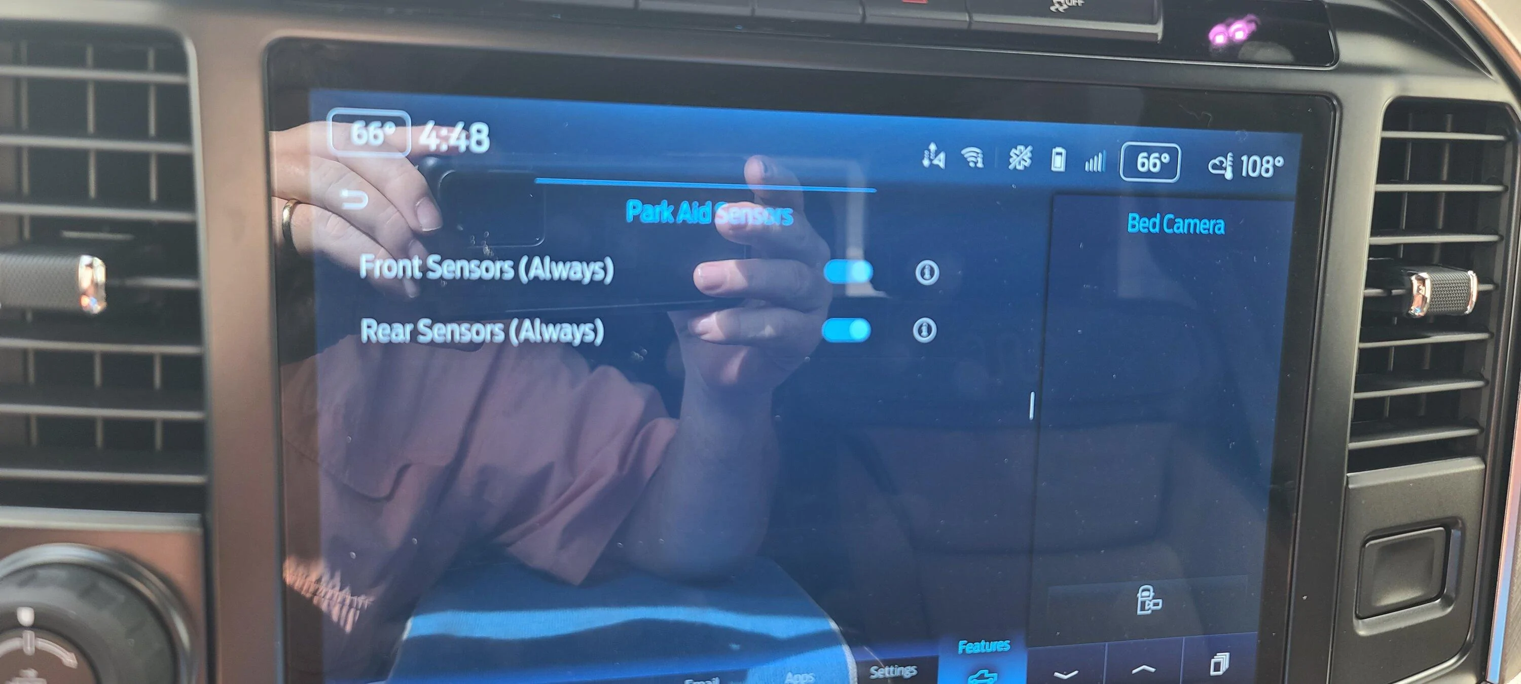

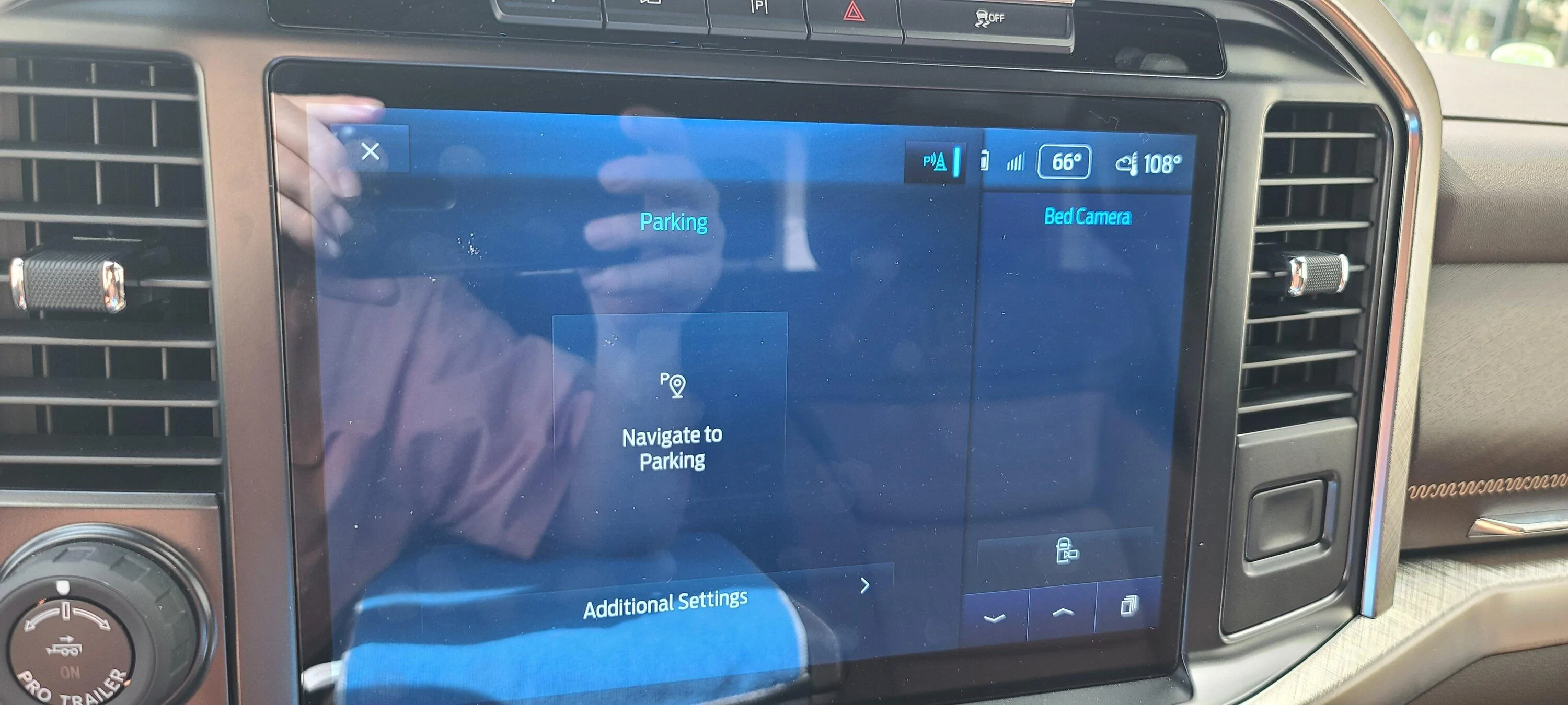

Do you get this instead? @Snakebitten
Ford F-150 Adding Forward Sensing System - 2021 King Ranch w/601A A49550F5-CE47-44D4-BB3B-8C9556950FA5
If I hit the P button I get:
Ford F-150 Adding Forward Sensing System - 2021 King Ranch w/601A 20220612_164805
If I hit "Additional Settings", I get
Ford F-150 Adding Forward Sensing System - 2021 King Ranch w/601A 20220612_164811
