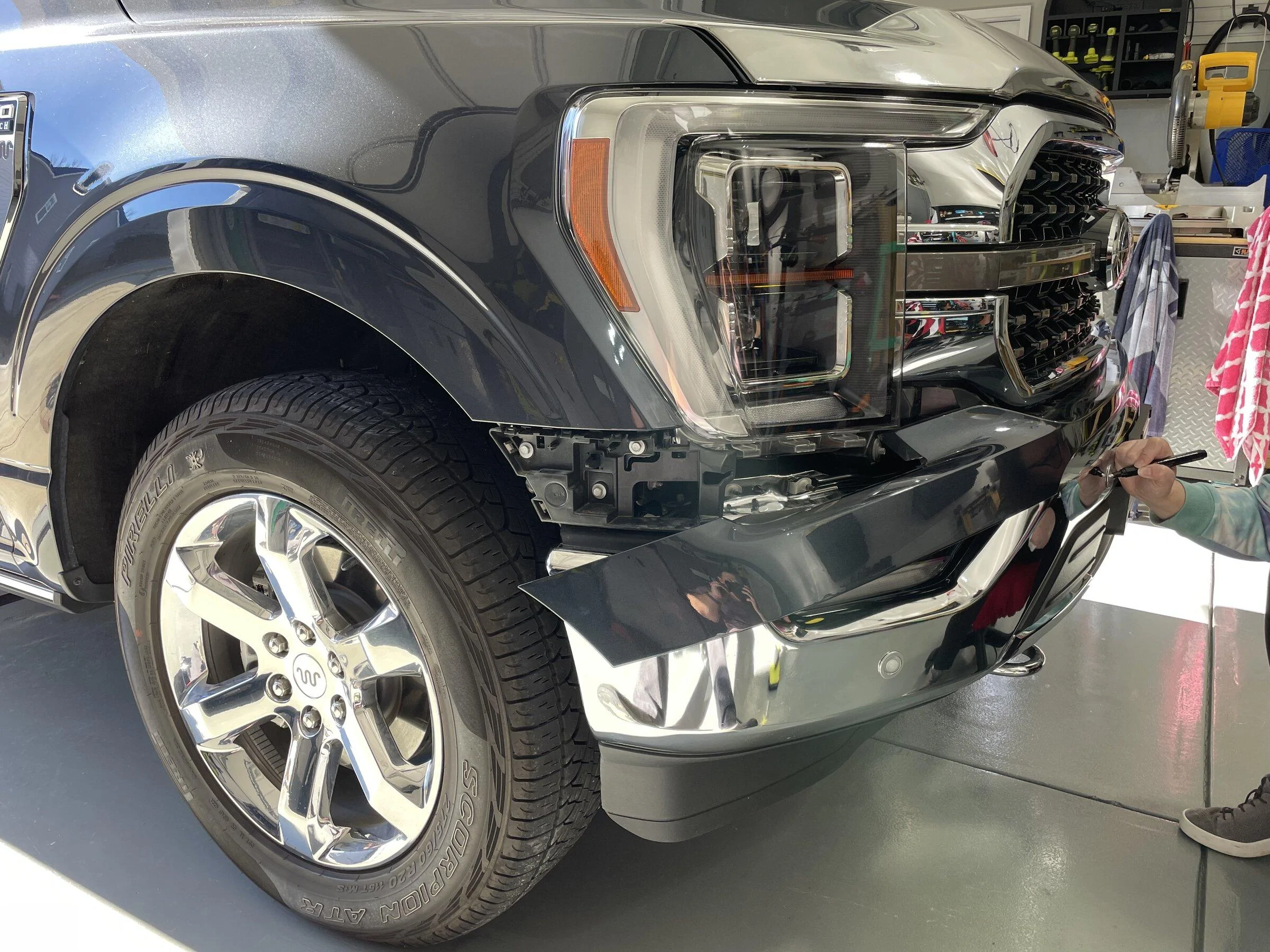

Removing the front bumper was relatively easy/straight forward. First, you will need to go under the front bumper of the truck and remove the plastic active Air-Dam, not the active Air-Dam left/right motors, those can stay attacked. The point is to expose the large bolts which attach the front bumper to the truck's frame.
Next, you will need to come out from underneath the truck and remove the plastic cover which goes along the front of the vehicle, just above the bumper. There are two screws on the inside/front of the wheel well on each side. Once the screws are removed, the plastic cover can popped out by lifting up and out from the outside(s) working towards the middle.

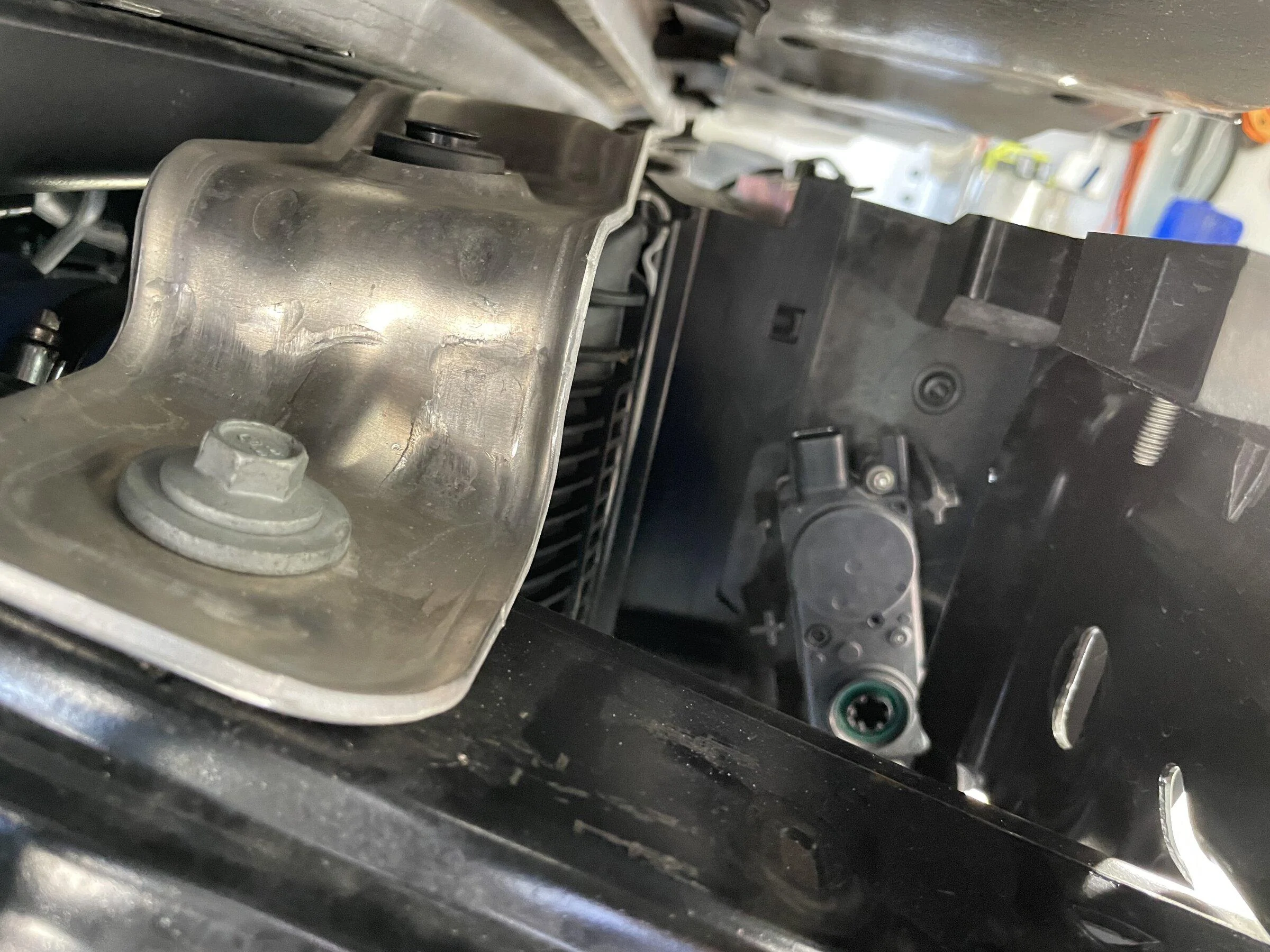

Once you have removed the plastic cover, you will need to go back underneath the truck's front bumper and unscrew the (6) large bolts, (3) on each side, in order to be able to detach the bumper from the truck. If you have a power boost, the pedestrian alert speaker will be directly in the way one of the large bolts. I removed the speaker by unscrewing one screw to the right of the speaker and then twisting the speaker such that it detaches from the speaker's metal bracket. I could not find an easy way to get the pedestrian alert speaker's bracket removed though. I ended up using a long handle (12") 13/16 socket wrench and slowly unscrewing the bolt ~1/8 to 1/4 turn at a time. Once all of the nuts have been removed, you can come out from underneath the truck and partially pull the bumper away from the truck exposing the wiring harness connecting the truck to the front bumper's sensors and fog lights.

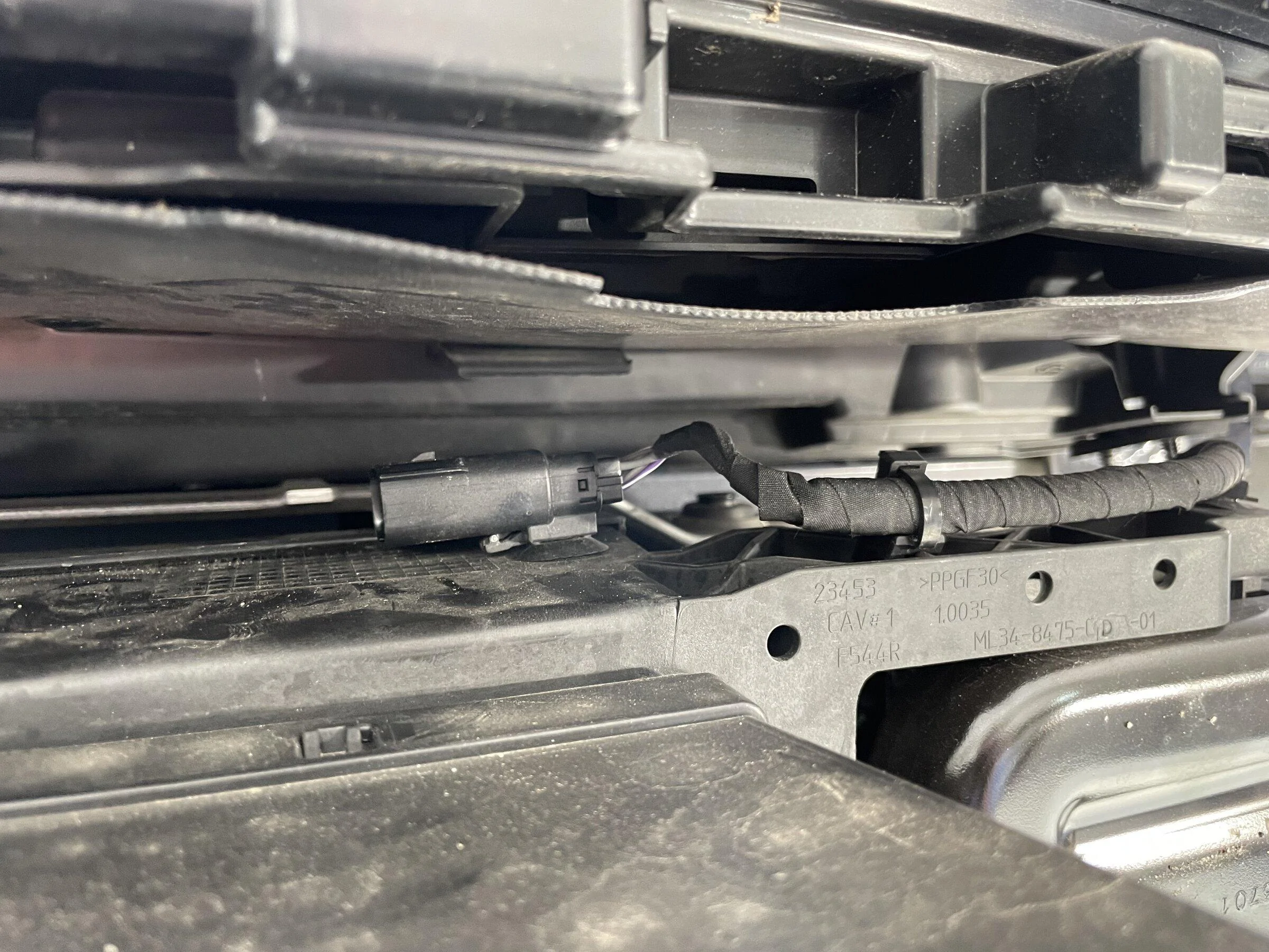

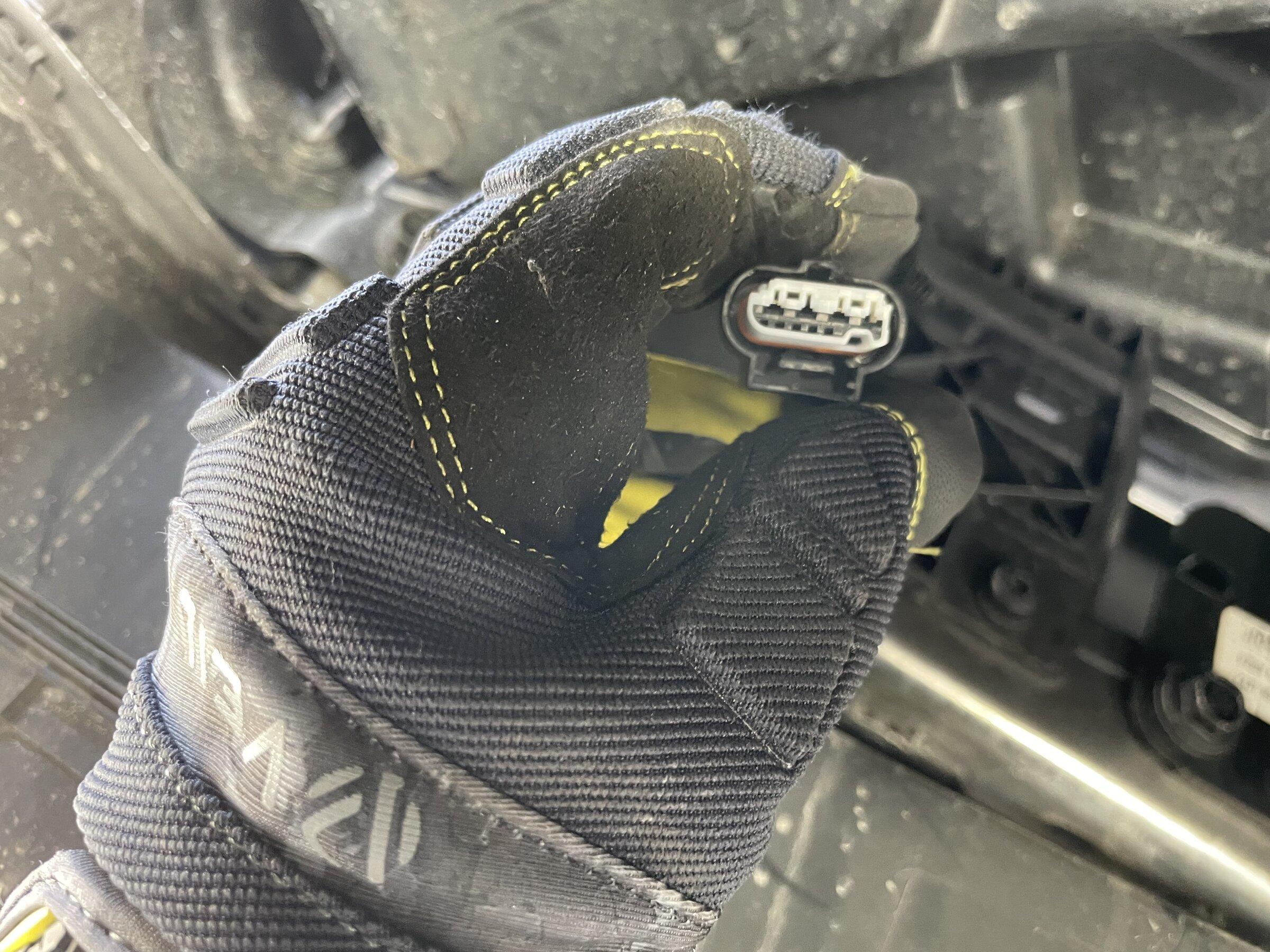

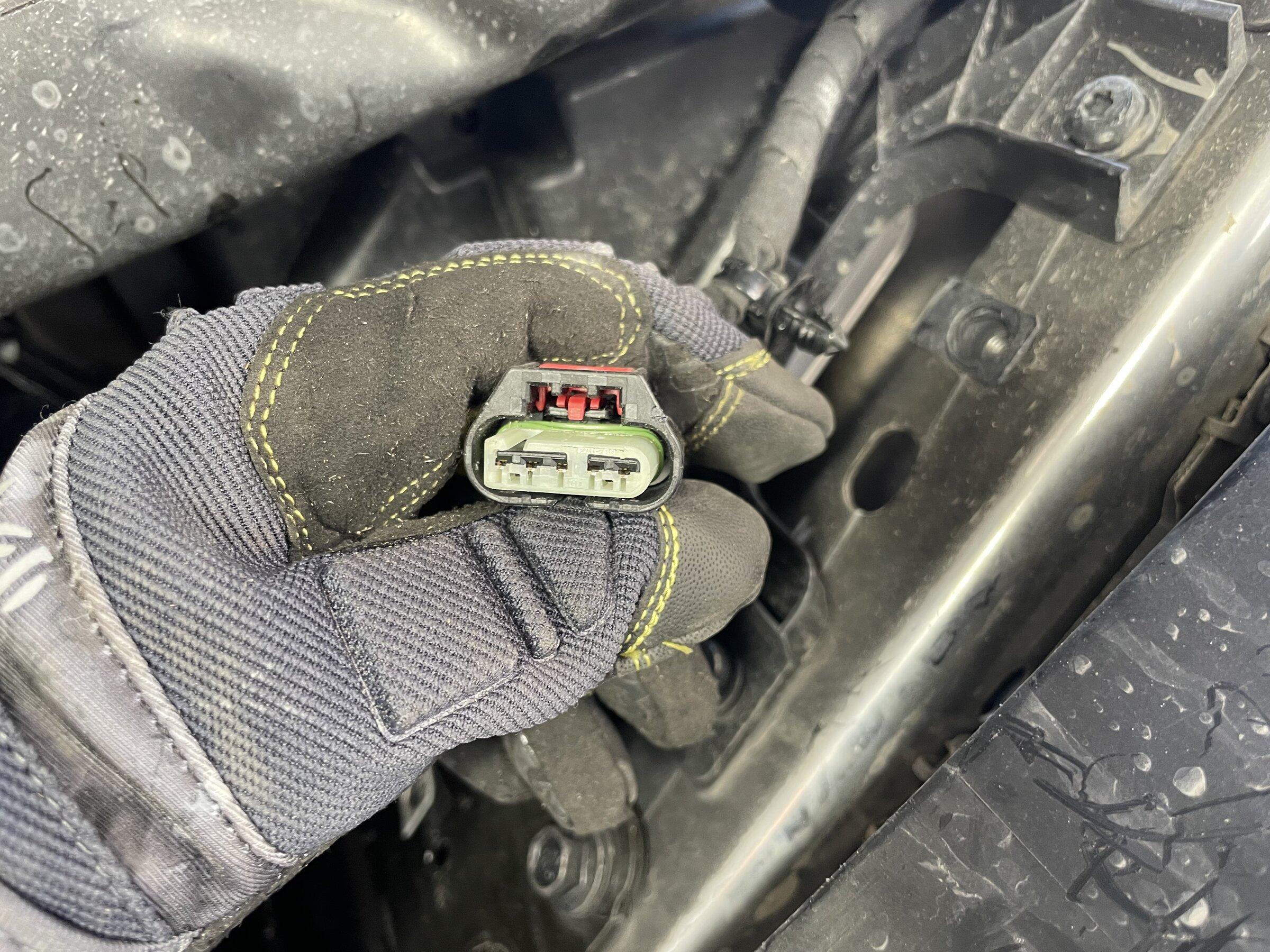

The wiring hardness which connects the truck into the front bumper will have a few connection points, based upon your truck's options. Mine had three connections, Main (Front/Slight left side), front air louvers, and the Pedestrian Alert Speaker, which all needed to be disconnected before i could lift the front bumper completely away from the truck and place it on a blanket on the ground in front of the truck.

The bumper is not extremely heavy and could be able to be lifted by one person; however, you will need two people, one to hold the bumper while the other disconnects the wiring harness, so using two people to remove it is recommended. You will also need two people when putting it back on. One person to hold it up flush against the bolts while you go under the truck to screw the nuts on. If you do it with only one person, the bumper will be low by ~1/2 inch creating a gap between the front rubber seal and the plastic trim piece you removed previously.
Once the front bumper is off the truck, you can begin to remove each of the various components on the back of the bumper, starting with the active air dam motors, fog lights, then left and right structural brackets.
Ford F-150 Adding Forward Sensing System - 2021 King Ranch w/601A D1818738-5BAD-49AF-81DF-5E1F7013E517
The left structural bracket (when looking at the back of the front bumper) has the front/center sonar sensor attached to the back of it.

Pay close attention to the harness' left and right side as the connections at each end are different.

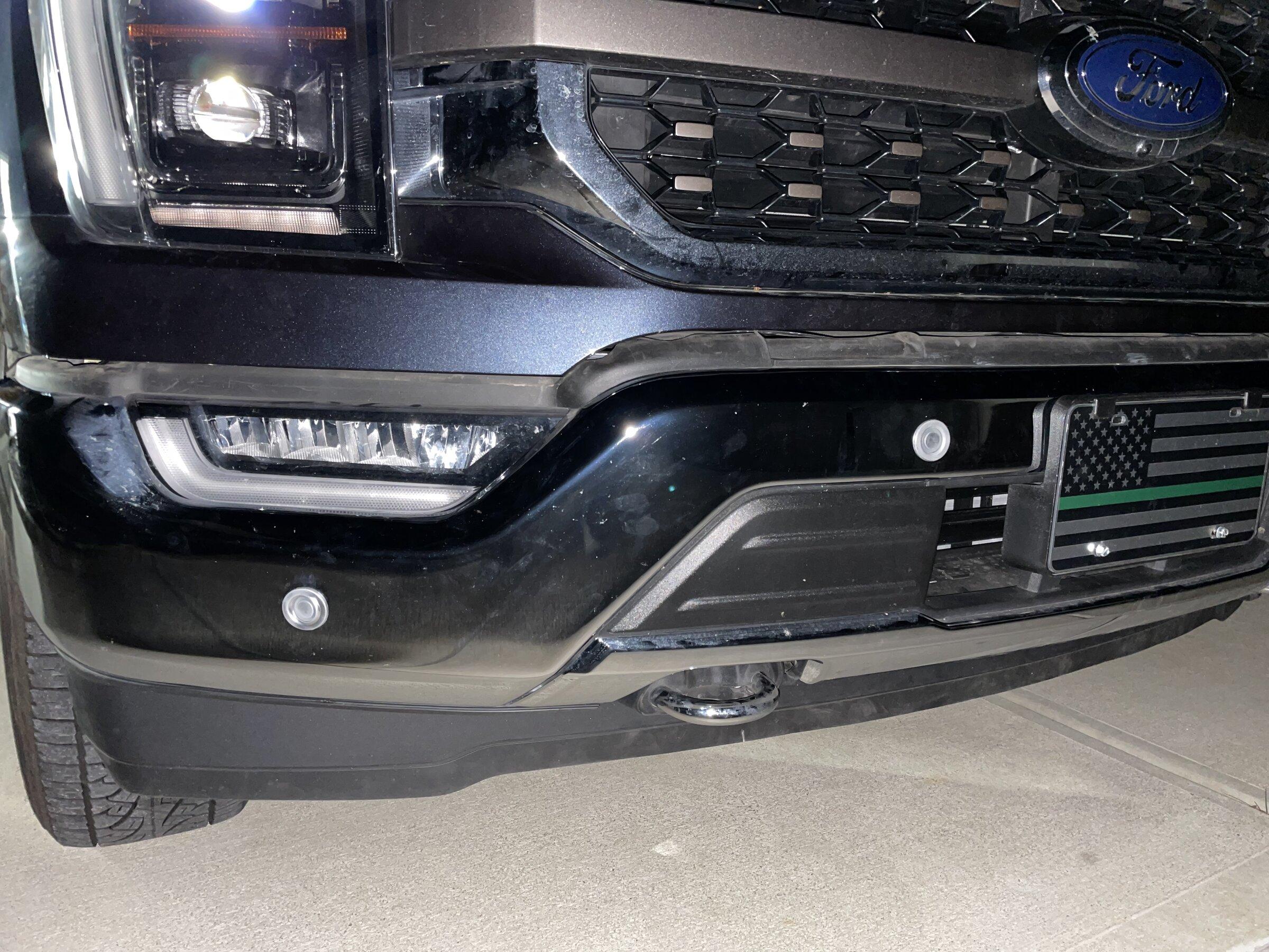

*Update* Drove my truck today and the front proximity sensors worked when pulling into a parking spot. So apparently the FORScan changes did work, but took a few hours (last night until this morning) before the truck recognized them.
It did not turn on the front camera like it does in other models with the 360 camera system though. I'll need to figure out what setting causes that. I am pleased that they work now.

I added some of the pics i took last weekend, but i admit they aren’t the best. I was more focused on making sure i could put it all back together than i was illustrating the steps i took at the time. I’ll go back through this weekend to take some better pics to add.
