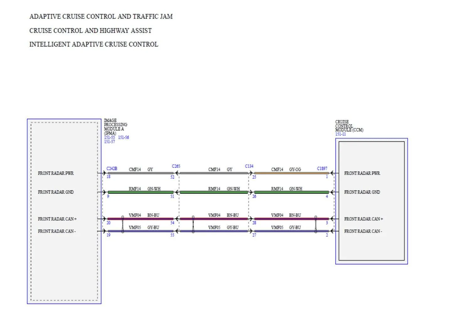

CCM looks like uses the same connector for F150, Explorer, Escape, Maverick:
CCM Connector = TE connectivity 2x4 Female Connector Housing, wCPA Key B PN 1411001-6
https://www.mouser.com/ProductDetail/TE-Connectivity/1411001-6?qs=iLbezkQI%2BshvzHt1mRq1zg==
CCM Connector Female Terminals:
TE Connectivity PN 1393367-1 24-22 Awg
TE Connectivity PN 1393366-1 20-18 Awg
Application Specification 114--13060
CCM Pigtail: 4U2Z-14S411-LC, WPT1198
https://www.f150gen14.com/forum/threads/adding-co-pilot-assist-2-0-with-forscan.5028/post-281959

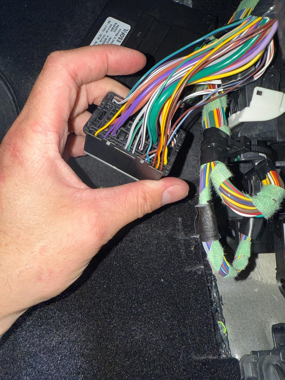

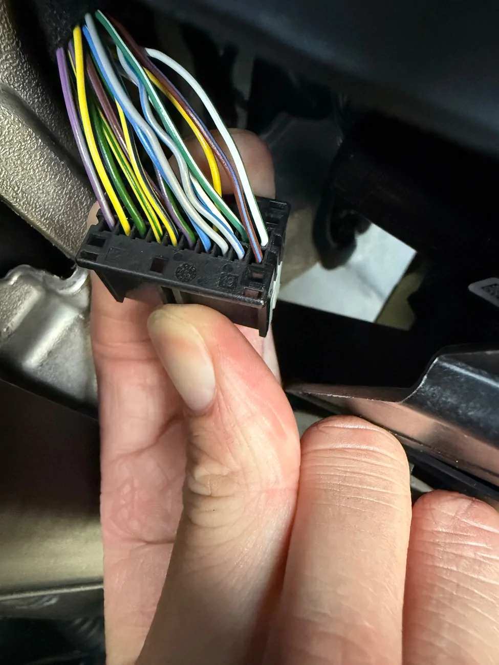

Hello folks,
I have a 2024 XLT W/360 cameras I have the pins at the IPMA. When I opened the bumper harness it looks like I’m missing the pins. Has anyone run across this? I’m guessing I’m going to have to find where they dead end and make a harness from there. Side note looks like ford put a module in on passenger side for front traffic? Module is not plugged in. Any assistance is greatly appreciated. I have read through majority of the posts on here and the lightning forums if this has been dealt with with in the past and I missed it my apologies.

Ok, I found the wires at the C265 no male pins for wires to go through fire wall. I’ll following what BeefLighting did on the lightning forums.

Think you found this already, but I believe you're on the right track.
It goes from the IPMA to a connector behind the glove box. I hear it's not easily accessible.
Then from there, it goes to the bumper connector.
You can skip this all by just running your own 'harness' (in reality it's just four wires) to the front sensor.

Yep, I’ve ordered wire and the pins to pin the connector to the bumper. Already have the bumper harness so figured I should just make it close to stock as possible. I’ll get everything early next week and go from there…
