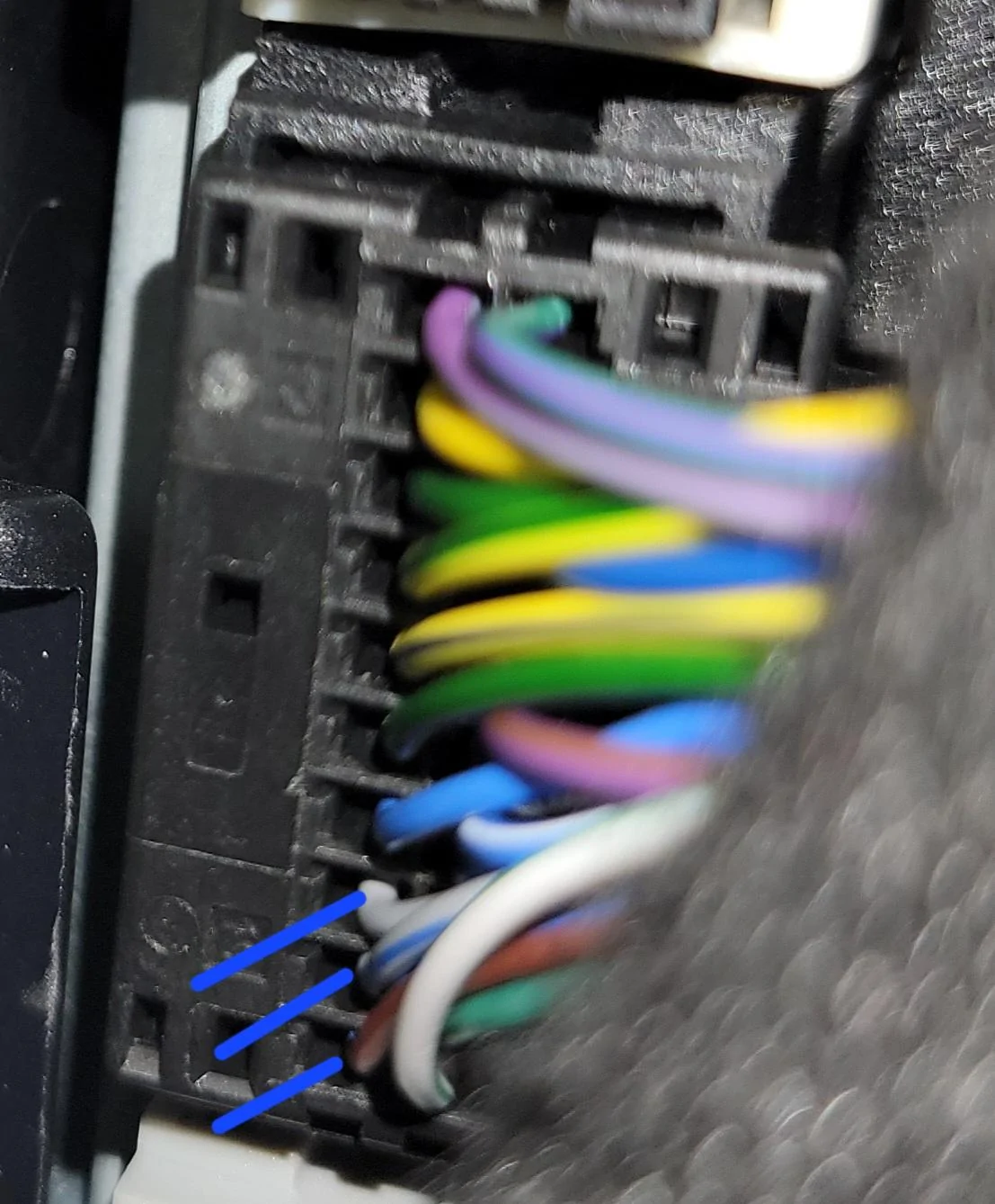

on the harness list avoid the first 4. trust me i made that mistake. i ended up going with what the @superfordman suggested which was the MA.
check the back of you IPMA which is located under the steering wheel behind the driver side cover for the 4 wires. if you're lucky you they should be there.

Which 4 wires do i need exactly?

I'm actually checking the same thing before I order the harness for my truck... Here's a video at the point where they check at 2:42 of video

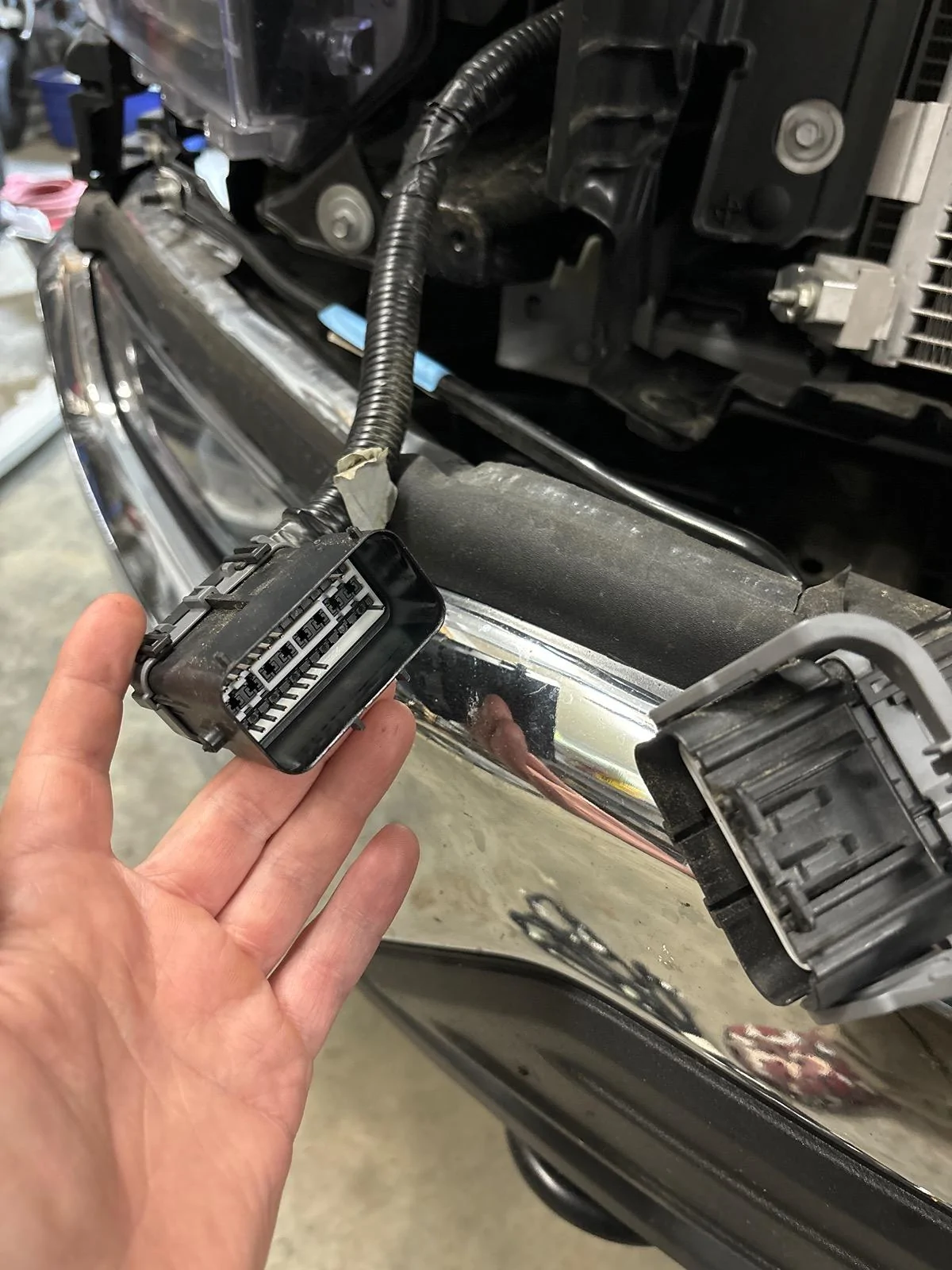

Ford F-150 Adding Co-Pilot Assist 2.0 with Forscan? 20240517_163629
Ford F-150 Adding Co-Pilot Assist 2.0 with Forscan? 20240517_161835
Ford F-150 Adding Co-Pilot Assist 2.0 with Forscan? 20240517_170348
Ford F-150 Adding Co-Pilot Assist 2.0 with Forscan? 20240517_182859
Ford F-150 Adding Co-Pilot Assist 2.0 with Forscan? 20240517_193522

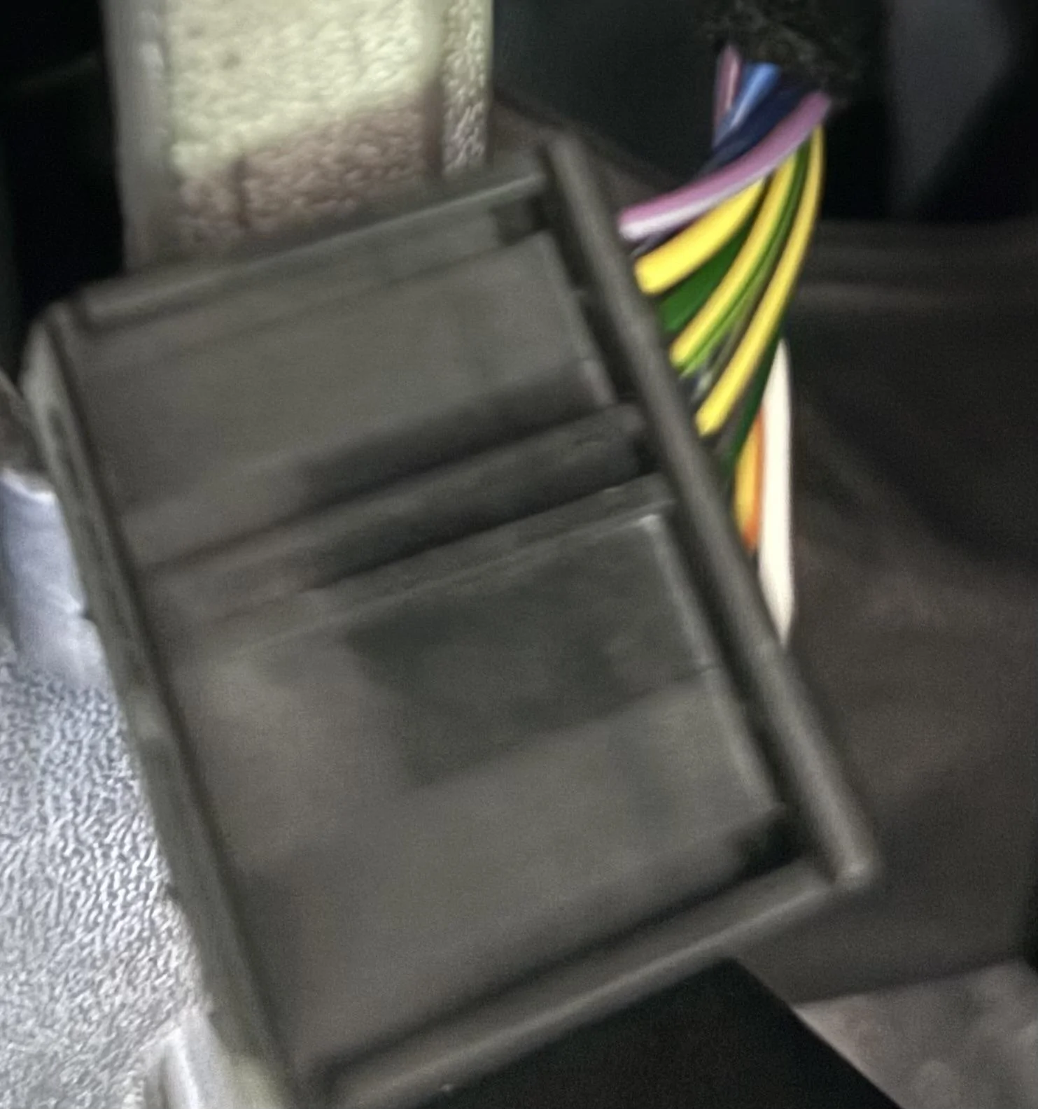

When I looked under driver side at wires I didn't see the 4 required so I suspect I have to splice wires. I’m about to take bumper off and one last check to see if I have to splice wires, use harness I bought or if I my 2023 xlt already has the plug for ccm. What 4 pins here?

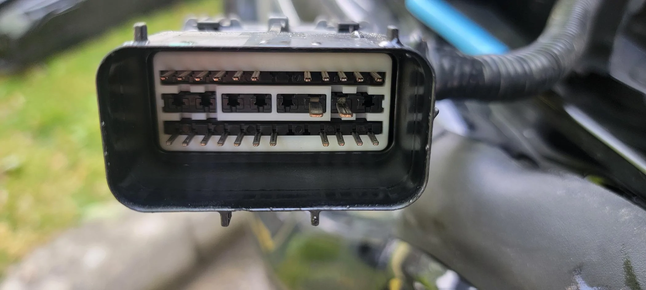

Can anyone confirm by looking at my pins for c134 above before I go straight from ccm to ipma. I definitely am missing the 4 wires at driver side kick panel Ipma (c265) so it looks like I’m going straight from the ccm to ipma .i bought the harness just in case since some 301a xlt had it . Here’s my c265 confirming no pre-wired support for ccm

See post #869 from @superfordman on page 58. You appear to have all the necessary pins to use the bumper harness.

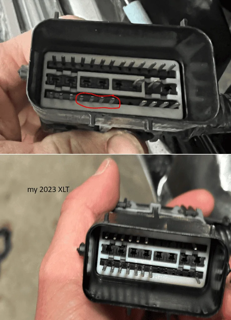

ok, so even if I'm missing the 4 wires in kick panel these 4 wires will work. I took another picture just to be sure to compare with superfordman's post

See my post #678 on page 46. I'm not sure that your looking at the IPMA harness in your picture above.
