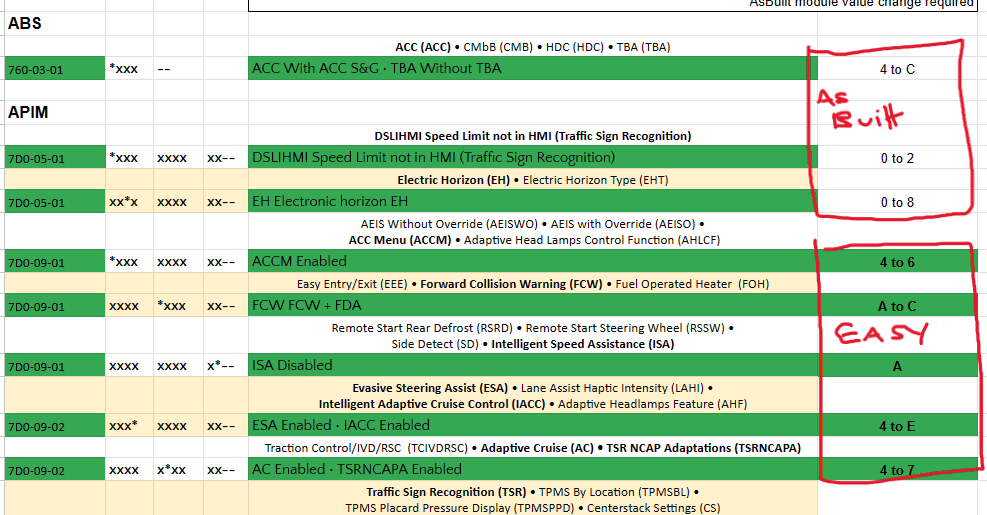

Speaking of Easy Mode, your sheet says you recommend using it when possible. I was making some guesses as to when an easy mode exists and when it must be an As-Built change. Is it like this, where green filled boxes indicate that an easy mode change is available and white boxes mean it's an as-built?
Yep, you got it.
