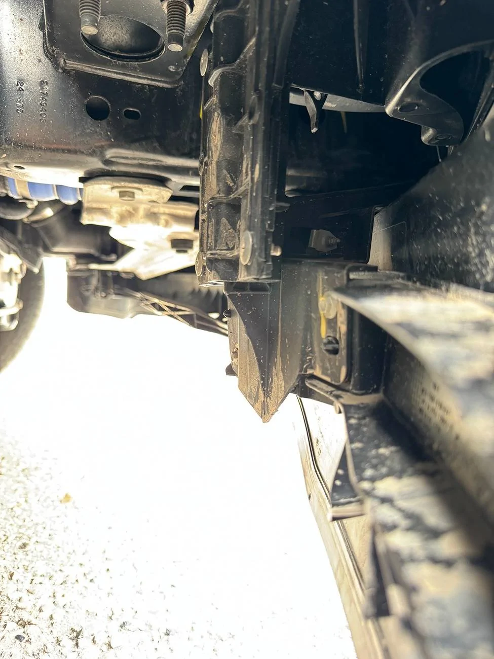

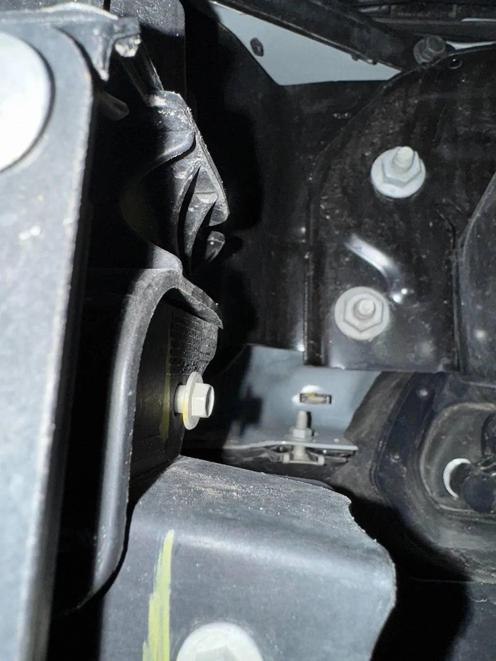

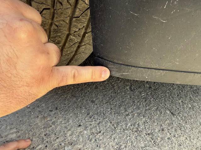

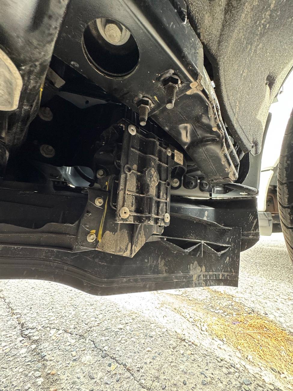

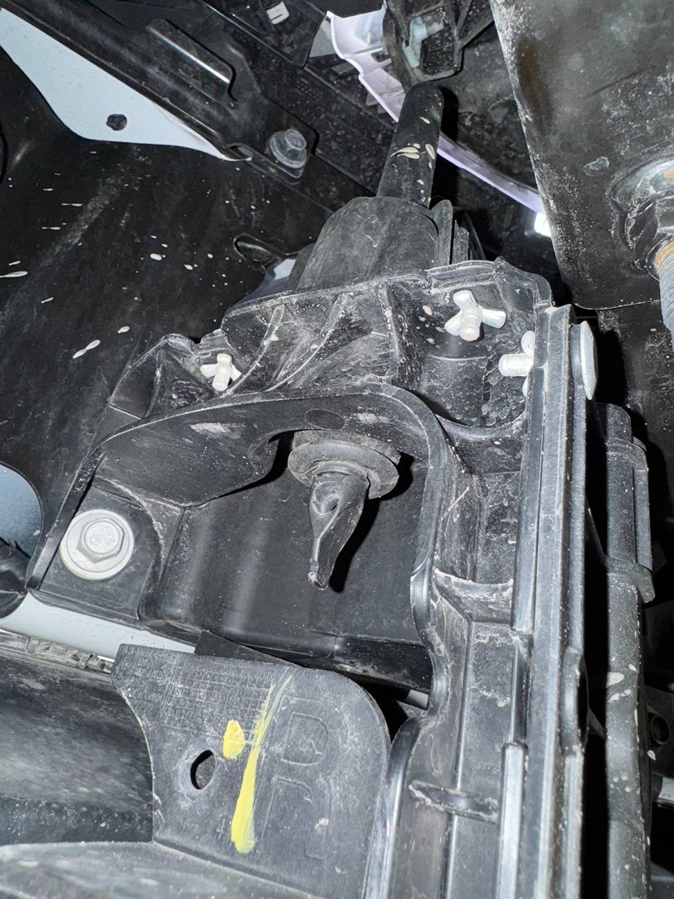

Hi All,
I've got a 2024 F-150 with less than 8,000 km (5,000 mi) with the active air dam dangling down on the passenger side. I took it into a dealership, and they are refusing to cover this under warranty, saying this has been caused by "external forces" and is not deemed a manufacturer defect (see picture taken by dealership pointing to the evidence of physical damage).
I got under the truck and maybe I'm missing something but I don't really see any damage, only a missing bolt that connects the actuator to the air dam.
I also took a look at the driver side which is still attached, and the bolt seems to be... backing out a bit (see last pic)?
Are they right to not cover this under warranty? Where could I find a bolt that fits?

If you are unable to get the dealer to replace it the actuator is actually pretty inexpensive just $170. It can be replaced in about 20-30 min if you don't want to delete the air-dam assembly
Ford (ML3Z-17626-T)
