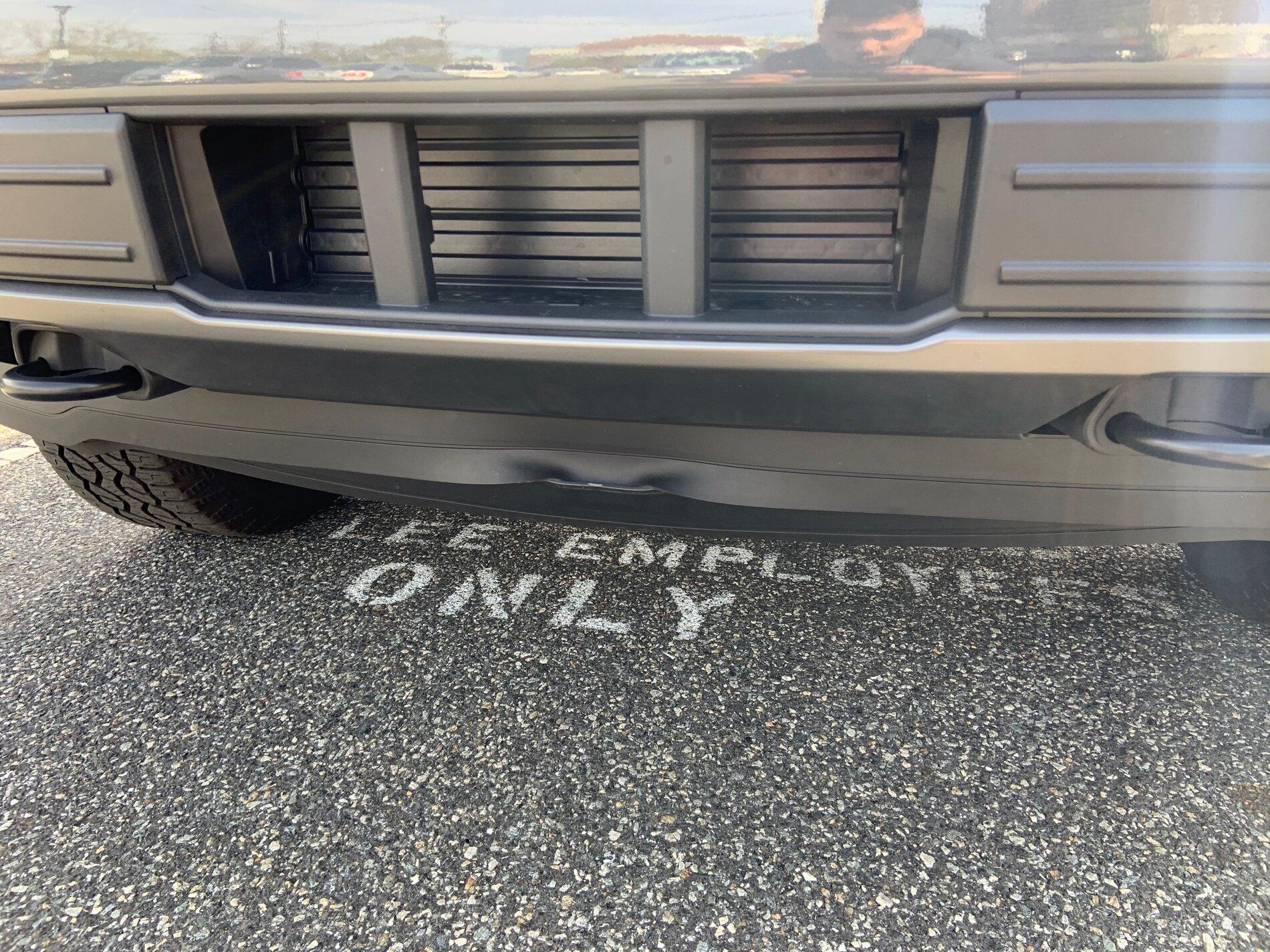

So I'm in a different mindset. I like the idea of active aero on a big brick punching a hole through the air. Also, I see benefits not claimed by Ford. I live in the north, and salt/sand are real vehicle killers; I expect that keeping wind off the undercarriage will help keep it cleaner and rust resistant.
Anyway, two weeks into ownership I hit a racoon (I saw him at least a 1/4 away thanks to the excellent lights) but the bugger must have been facing support payments and decided to cross back at the last moment. RIP air damn.
My question is, anyone able to share the PN? Just for the plastic part that lowers. I'll replace it myself once I get one in on order.
Have you try using a heat gun to heat up the plastic and see if it can return back to original shape?

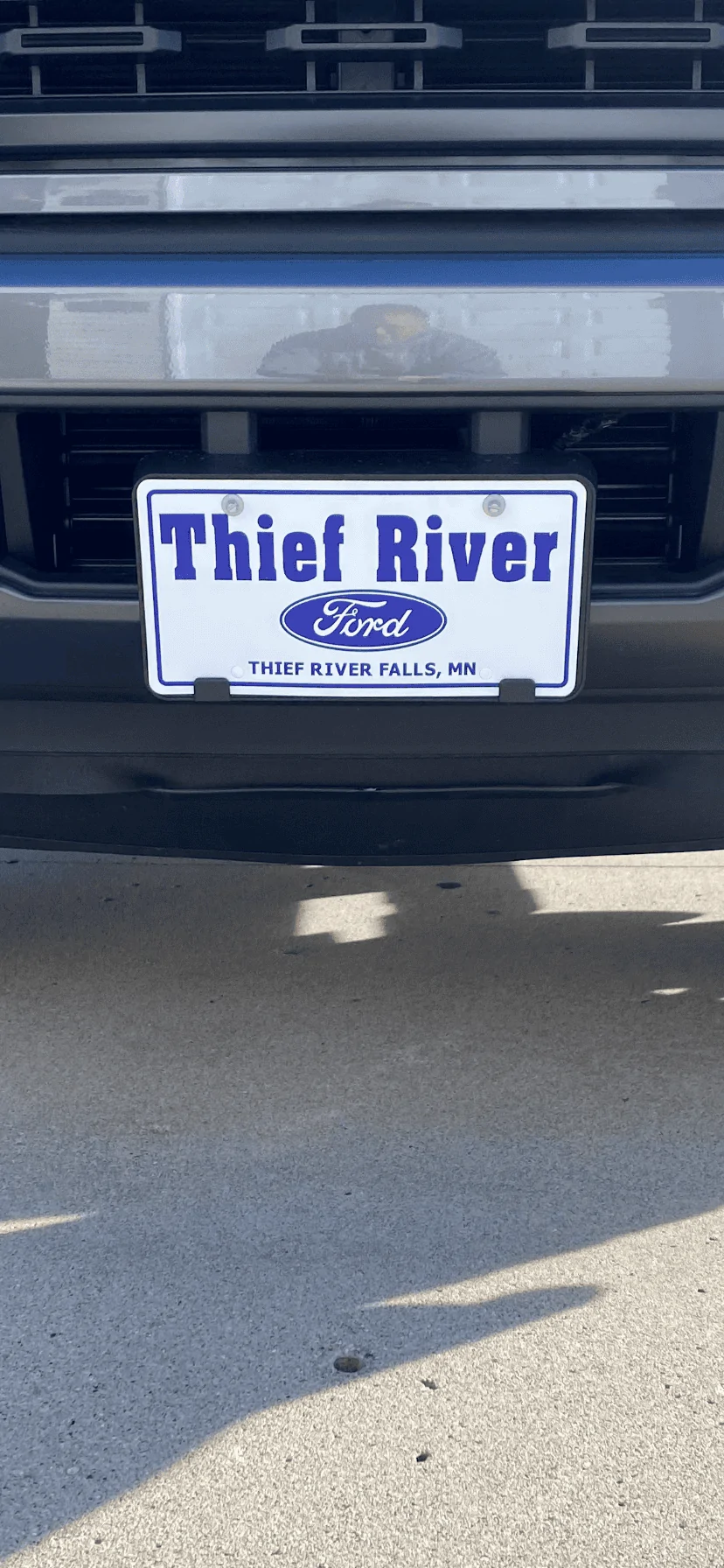

Any benefit mounting the plate holder upside down?
Didn't know it was upside down I guess. After looking at photos I guess I might be, but it fits fine like this and opens up the lower grill area somemore. Sits at somewhat of a downward angle, but is on there sturdy.

I had the service manager put it up on a lift today and look at it. He is thinking that somewhere along the way (most likely transport truck) the air dam was hit in the up position bending it back some and it is now loose as well, so when it wants to come back up it hits the front piece. The bottom of both pieces have scrapes on them like it hit a curb or parking stop. They have new pieces on order and will replace both early next week. The other one on their lot does not look this way, nor is it as loose as mine.
Hmmm, better plate angle this way. Plate holder is just snap on to 2 posts. I broke a clip when I install a mesh in the lower grill area.
It looks better the way you have it. Those fingers at the bottom are logical, they support the license that way.

Replaced mine yesterday. Took longer to open the box and find my 7mm than it did to swap it. The damaged one had a split and bend from the raccoon strike, so a heat gun wouldn’t have done much.
