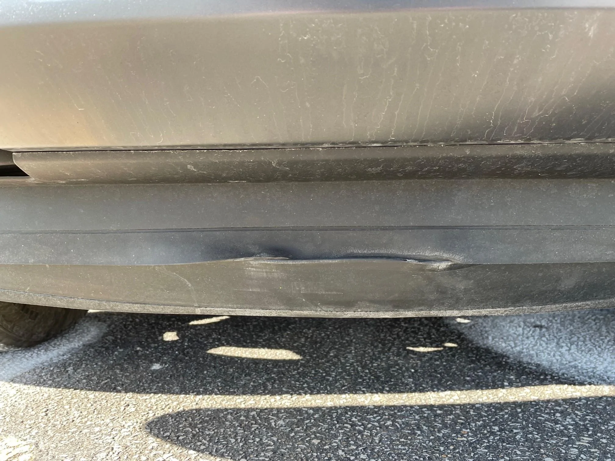

Had my truck in a month or so ago for the insulation recall, and they replaced my air dam. Seems to be working ok still. New version has a taller lip on top to prevent catching. So far so good! They said my original one was warped.
Mine keeps getting caught too. Don't want to go to the dealer unless I know there's a real fix for this. Come spring, I'll take a look to see if I can fix it myself if nothing reliable comes from Ford.

The combination of heating and bending the air dam along with the washers have fixed it so far for me. Not sure if the washers helped but I am leaving them in for now.
Where are you putting the washers exactly?

Thanks for taking the time to reply and adding pictures, I appreciate that. I’ll put the washers on tomorrow and cross my fingers.
