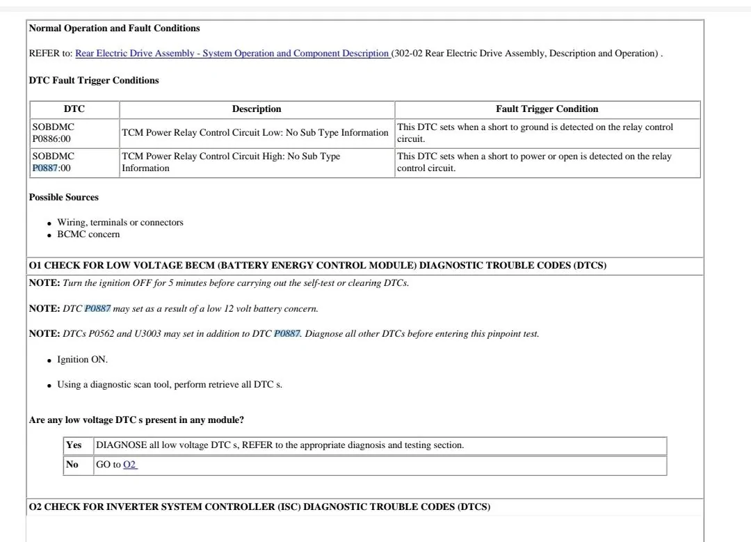

Amazing it's not throwing at least some soft codes?
I believe others that have experienced the Stop Safely alert, and then a no start condition, do get some codes along with it.
P0887, for example?

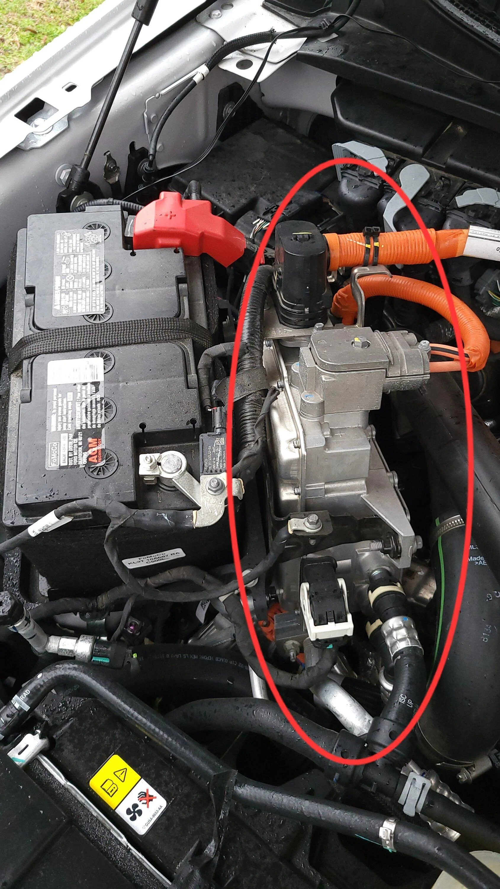

Another fella had the inverter (SOBDMC module) swapped out after it failed the pinpoint testing procedure. He was fortunate enough that the issue presented itself while in possession of the dealerships technician.
It's that big chunk of technology right next to the battery.
Ford F-150 Accessory mode and stop safely now 20230202_091258
Keep in mind that his truck did throw the appropriate code(s)
