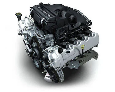

At the end of the day what we all want is for Ford to give us a 5.4L 3V option. I miss the low power, low mpg, and cam phaser/ timing chain issues. Had a nice and lazy 9.8:1 compression. That motor could run 87 all day long (at full power btw) and put glitter in the oil. Those were the days. I think I speak for all of us when I say we would all trade our motors for that package.
Funny how quickly Ford became the leader in powertrains. It used to be, yeah Fords are ok but the engine kinda sucks and they ride like a dump truck. Things change.
What I never understood with the 5.4 was Fords refusal to fix it. All the problems came down to the plastic chain tensioners with the stupid silicon seal and the weak backer plate on the oil pump. Literally just needed to be switched to a cast backer plate and two steel tensioners and they’d have zero oil feed issues. So easy to fix, it’s still crazy to me. They lost a lot of customers over that BS.
