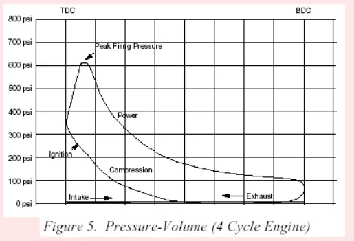

The issue can be seen in Figure 5 of the link I've been posting. Bottom line is that the way an engine produces more power is by moving the Power line farther away from the Compression line. The area between those two lines represents the work done to the face of the piston. The way you do that is by raising the compression ratio which moves the Power curve away from the Compression curve and this then requires higher octane. Unless you control dyno testing to the same parameters that Ford used, dyno testing is anecdotal. Nice to have but irrelevant. The only purpose octane serves is to prevent fuel-air detonation prior to the ignition point during the compression curve. If you want more power you have to raise the power curve farther away from the compression curve (Recall that a gallon of gasoline contains the same energy regardless of octane). So you have to change the design of the engine. How do you do that? You increase compression ratio (which requires a higher octane). Note: the Compression curve repsents work into the cylinder; the Power curve represents work out of the cylinder. Note: moving the ignition point (the spark) either way from the design point of the engine reduces power. Merely advancing the ignition point doesn't add power since, with the same engine compression ratio, the peak firing pressure will go down. (Why is that? The purpose of advancing the spark is to allow combustion time to be complete by the planned peak firing pressure point.) If you don't increase the peak firing pressure, the area under the curve doesn't change.
No. Just no. You're over explaining and not addressing one question. Is the engine designed to make max power on 87? We know that's not the case. Better question is, will 87 octane allow you to extract the maximum amount of power allowed by factory programming.
You can't answer that and your info doesn't prove that. Lots of anecdotal info points to "87 doesn't". You speak in absolutes you don't have any info on.

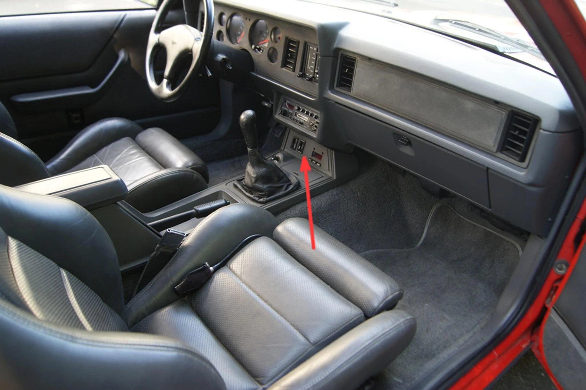

Ford has been leveraging "Premium" for additional performance with turbocharged engines for a long time.
My 1984 SVO Mustang had a toggle switch on the centerstack for when you were running Premium fuel.
It wasn't a placebo switch. ?
Trouble is you don't know that, thus you are just plain wrong. Ford advertises that the engine will run on 87 and produce full power. Read the owners manual. When you say "we know that's not the case" you're seeking to paper over ignorance with fancy words. Try again.
