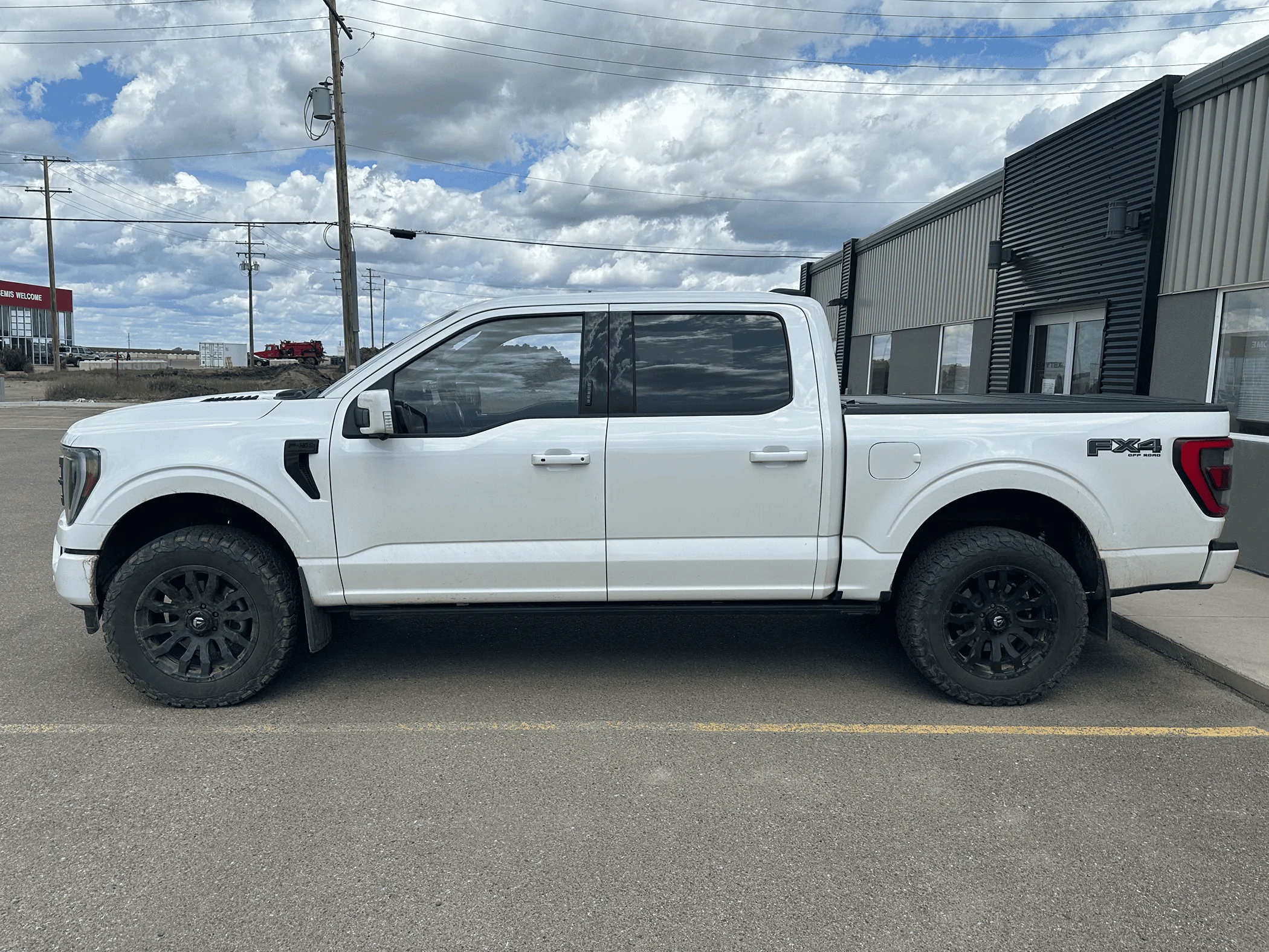

Bilsteins on 6112/5100 and 295/60/20 Nitto today. Not many miles yet but I am very pleased so far. 41 1/4” rear 40 3/4” front. With improved handling.
Looks Awesome Jerry! I assume you went with the 2.5" setting? I'm just waiting on my 5160s to show up. Going with Fuel Blitz wheels, gloss black +20 offset and BFG K02 285/60R20. I picked up a couple of camber bolts but am undecided about upper control arms.... I'll post pics and before/after measurements when I get it done

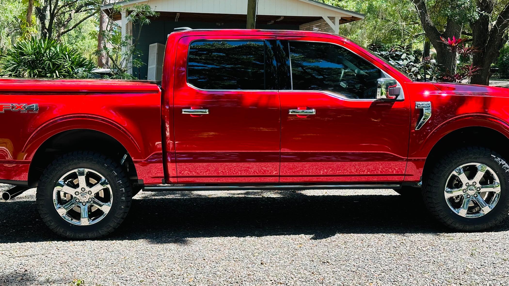

Jamie, sounds like you are on your way to a great setup.
Post pics and measurements when you’re installed. Also curious on how you’ll like the rear 5160’s. I was going to go that route but only tow my Bassboat and very little off-road use.

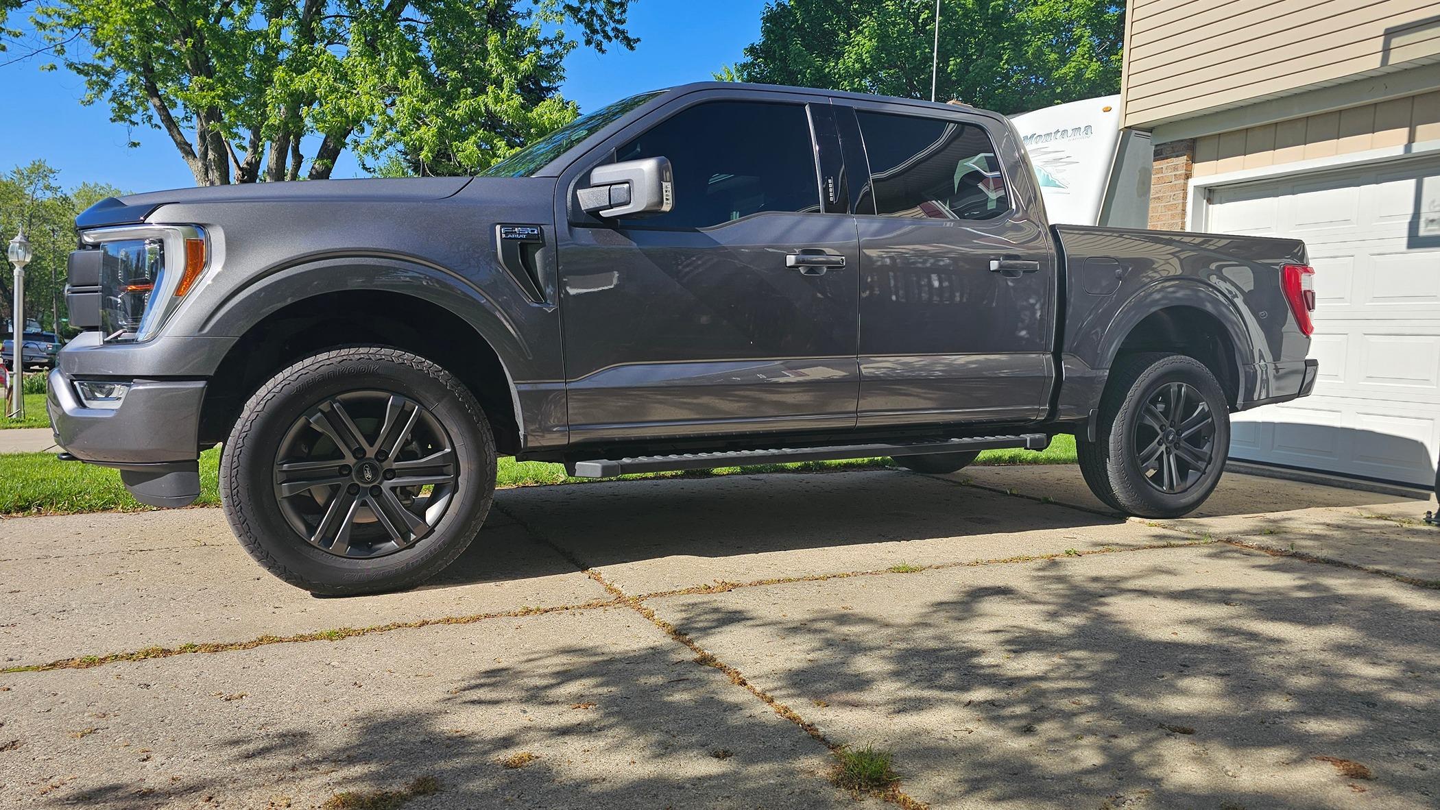

That's how mine looks on the 2" setting. I wanted to keep a bit of rake since I tow in the summer. It's got about .75". I didn't bother with UCA's since I wasn't planning on going over 2.5".

Thanks Gord, truck looks good! I'm leaning more towards the 2" since I have an enclosed trailer that I'll be towing once in a while. The shop doing my install is a place I've used before for suspension, wheels and tires so should get some idea from them too.

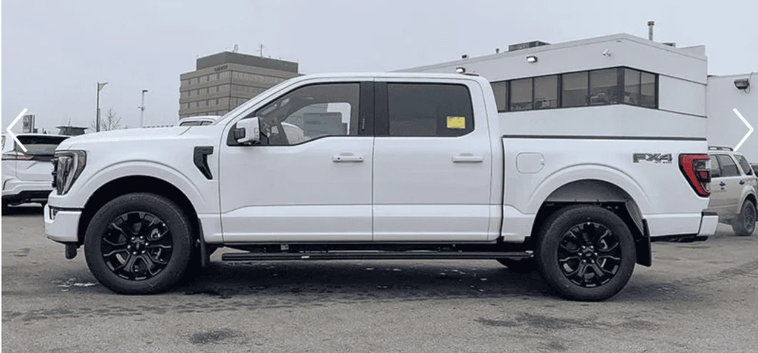

Sorry for the delay, but here it is. Trucks a bit dirty but it rains more often than not lately.
Here are the before measurements:
LF: 37 1/4
LR: 40 5/8
RF: 37 1/8
RR: 40 7/8
After measurements:
LF: 39 3/4
LR: 41
RF: 39 3/4
RR: 41 1/4
I went with the 2" setting on the 6112 in the front and it came up more than that but i expect it will settle a bit. 5160s raised the back a hair but I'm ok with it as need a bit of rake for my trailer.
