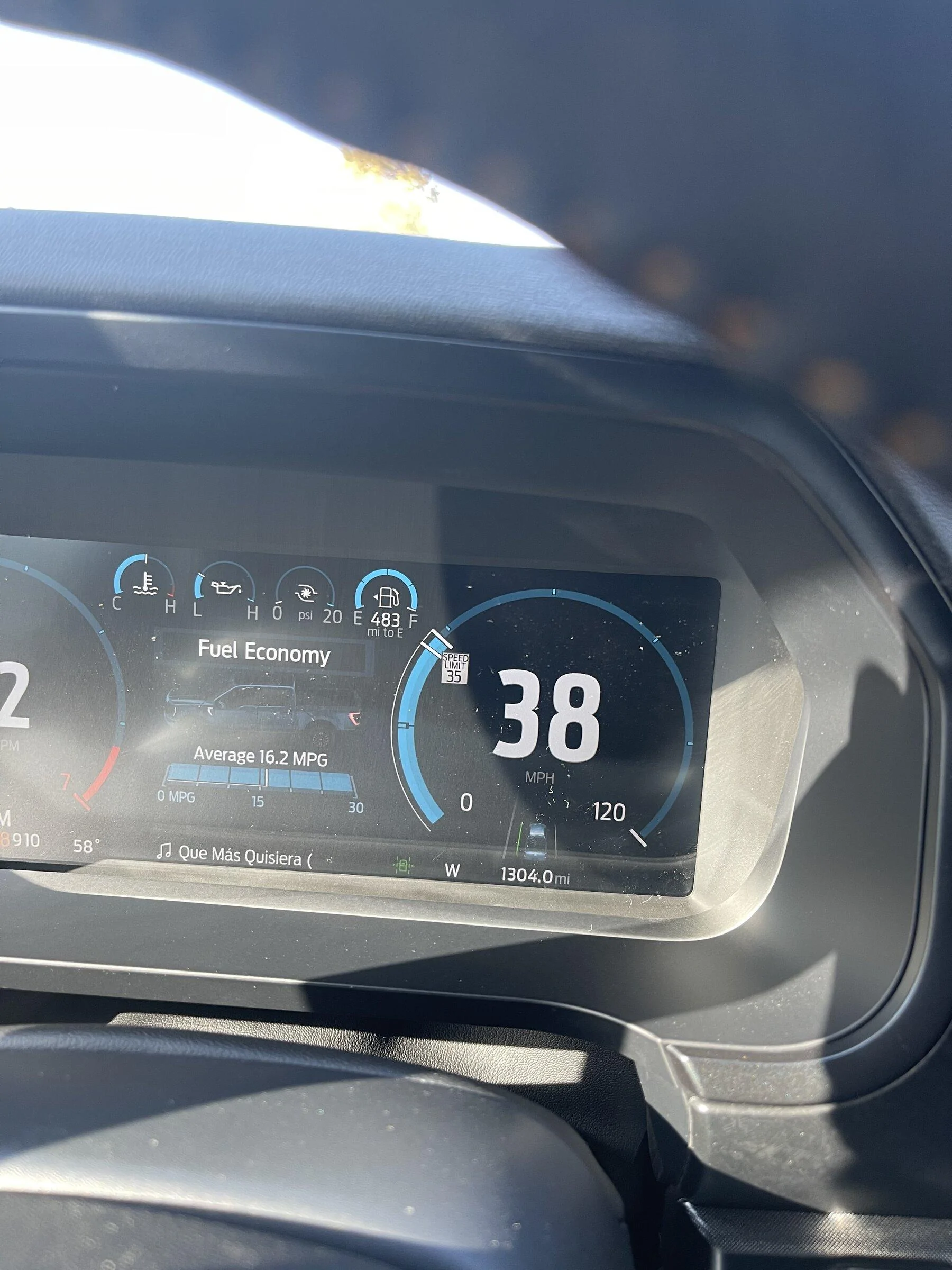

i have the same issues, I have pumped several times at very low DTE and have only been able to fill up with 31 Gallons and only get 483 miles to empty, on my 21 Tremor with 36 gallon tank, with 1600 miles on it, ( I also recently purchased a 21 Honda Accord and the DTE was also not calculating the correct DTE, it’s at 1800 miles now and it did learn to calculate, but that’s not the same issue with this 21 F150,) I also didn’t have this issue on my 19 F150 Lariat with same 36 g tank, on my 19 I used to fill up with 34 or 35 Gallons at the pump, well to make story short, I drove up to ford service and spoke to the service GM, and he advised me to drop off the truck, so they can drop down the Gas Tank and verify if I do have a 36 Gallon tank and that if I do, they will be reprogramming the gas cluster to see if that fixes the DTE issues. I dropped it off this morning and they told me it would be about 2 days before they can give me an update. I will update Y’all once I get updated.

Hello everyone,
Update,
I picked up my truck back from the dealer after a week of them experimenting with it, they lifted the truck to check to see if I had the 36 Gallon tank, after verifying that it was a 36 gal tank, they moved forward with running the gas gauge to 0 DTE they left my truck on all day, after that, they filled the gas tank to see how much it would take in, so what they came up with was that it fill up with 34 Gallons, they say that it has a 2 Gallon Reserve after you hit 0 DTE, so that was their conclusion. Now I have to verify myself and she what happens from there.
