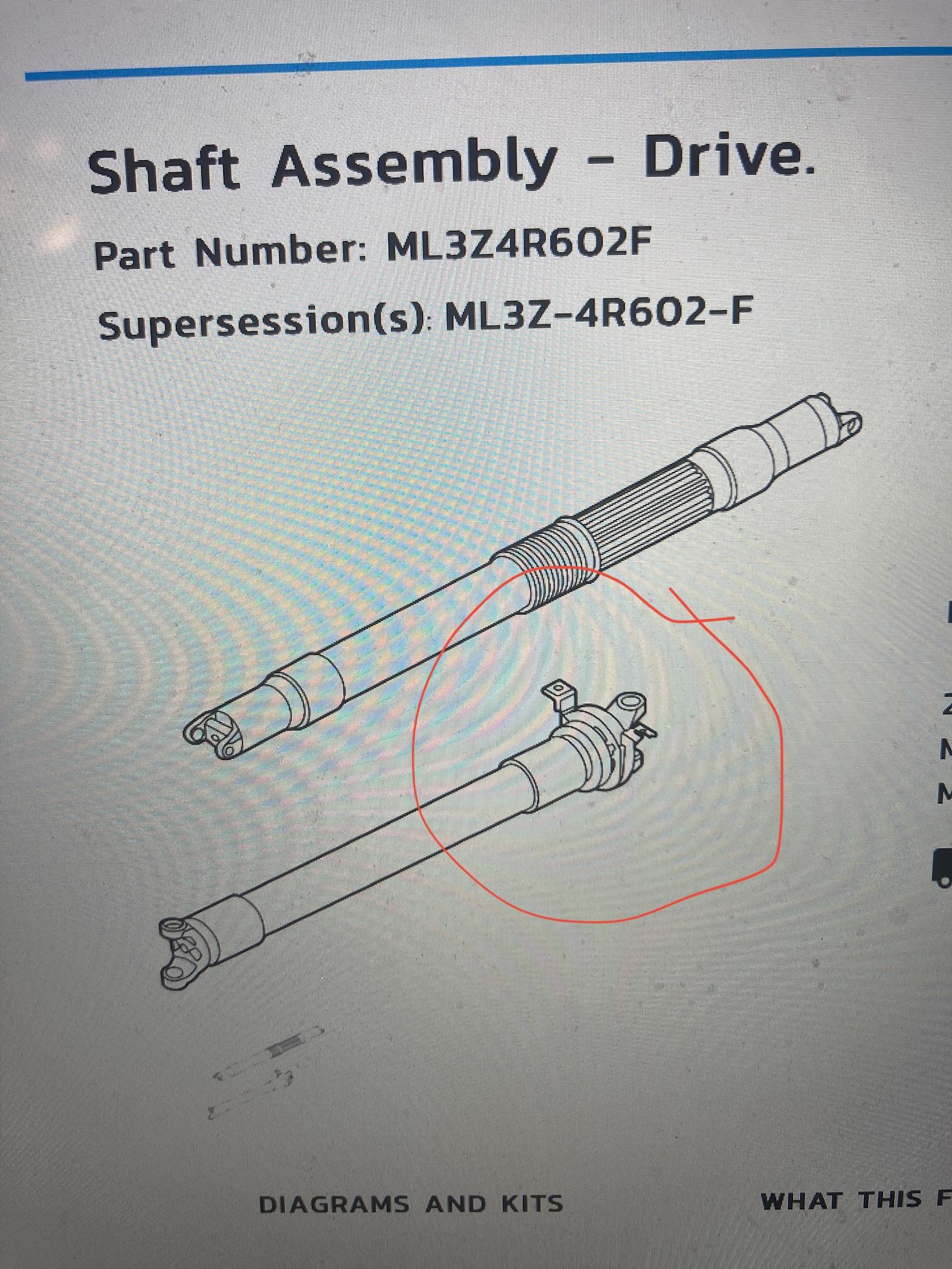

The vibration might be coming from the half shaft bushing that is mounted to the body of the truck It's a two piece driveshaft . on 157 bed
