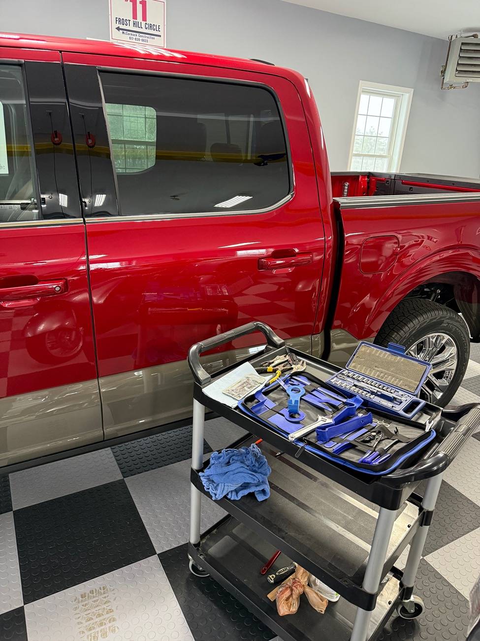

Me. Big Fish, not to change the subject but to change the subject, I saw the rolling cart that you are using and it looks nice. Do you like it and if so could you let me know where you bought it and approximate cost?

I got that on Amazon a while ago . I like this cart although I use it for lighter duty stuff it’s quite sturdy
