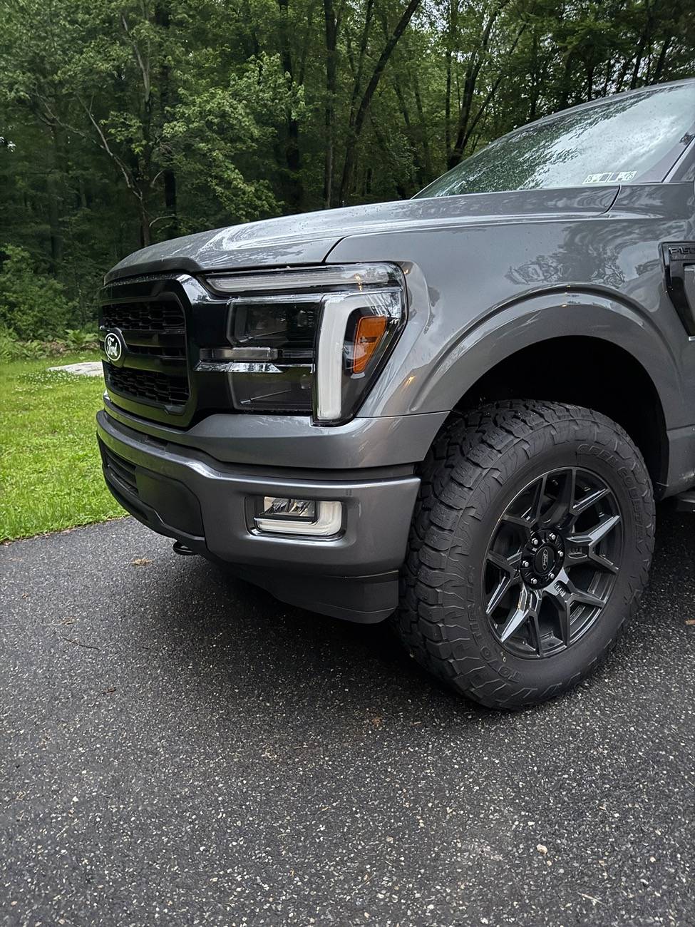

It is so unrelated and circumstancial that I'm afraid to comment and mislead people.
The only change was XL front end to Lariat front end upgrade. Everything else remained unchanged.
First drive revealed so much louder tire noise compared to before, that I decided to test. But what was different was the wind noise was greatly reduced, unsure of the aerodynamics of each front end but explains why the XLT and the Lariat I test drove were also in the 50s db when I tested them compared to the XL in the 70s db.

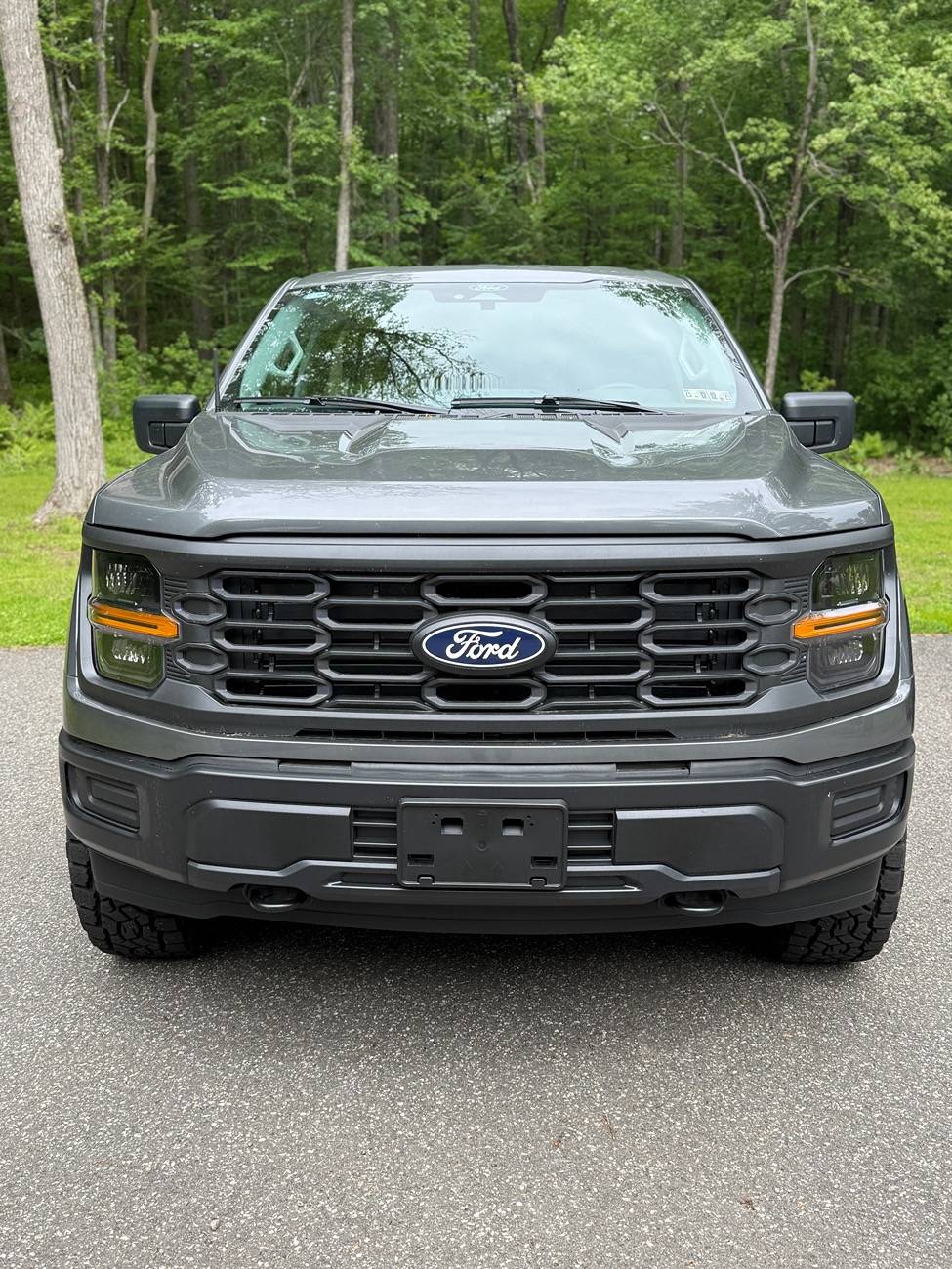

Current front end:
Ford F-150 2024 RCLB (Long Bed) 5.0L Carbonized Gray OEM+ Lariat Build IMG_0482 2

I believe it must be related to the mirror housing and some installation issues from factory causing the addition wind noise. The mirrors were sanded and painted and reinstalled. Other than the front end and the mirrors nothing else changed.

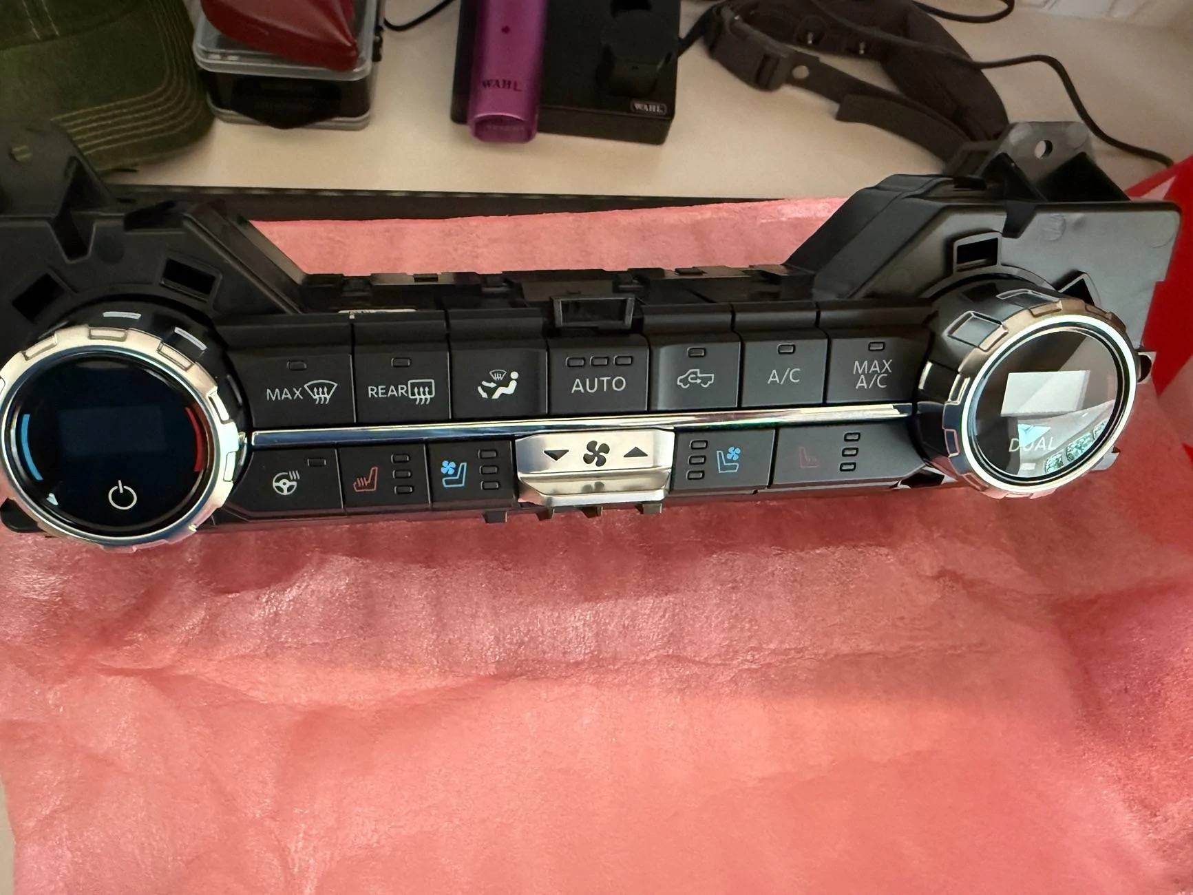

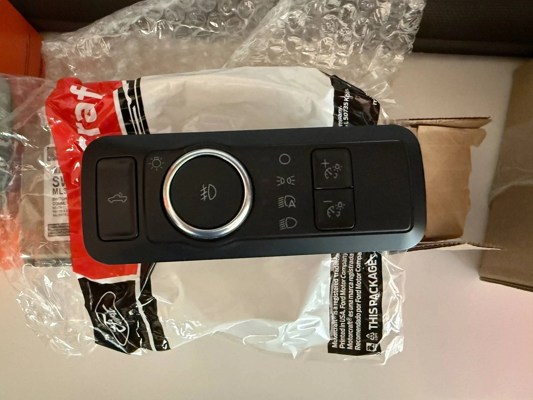

This just arrived!
Will be retrofiting the OEM heating pads on the middle bench for complete front seating heating. Will be taping into the OEM passenger harness for power.
Berrones is working on a harness for this to get full functionality of the Lariat active cooling/heated seats.
The stainless knobs on the AC controls and the light switch are causing serious OCD issues since they don't match the plastic ones on the radio controls.
