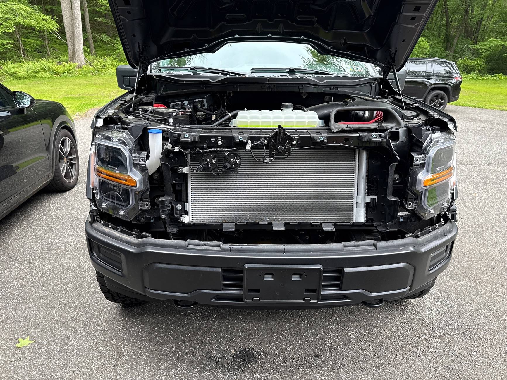

Quick update: Weather has been terrible. Finally found some days without rain to get this done.
Removal of grill and lights is very very easy, just tedious since it’s a high number of bolts and clips.
Have the OEM original parts available if anything is interested in the lights and grill or either.

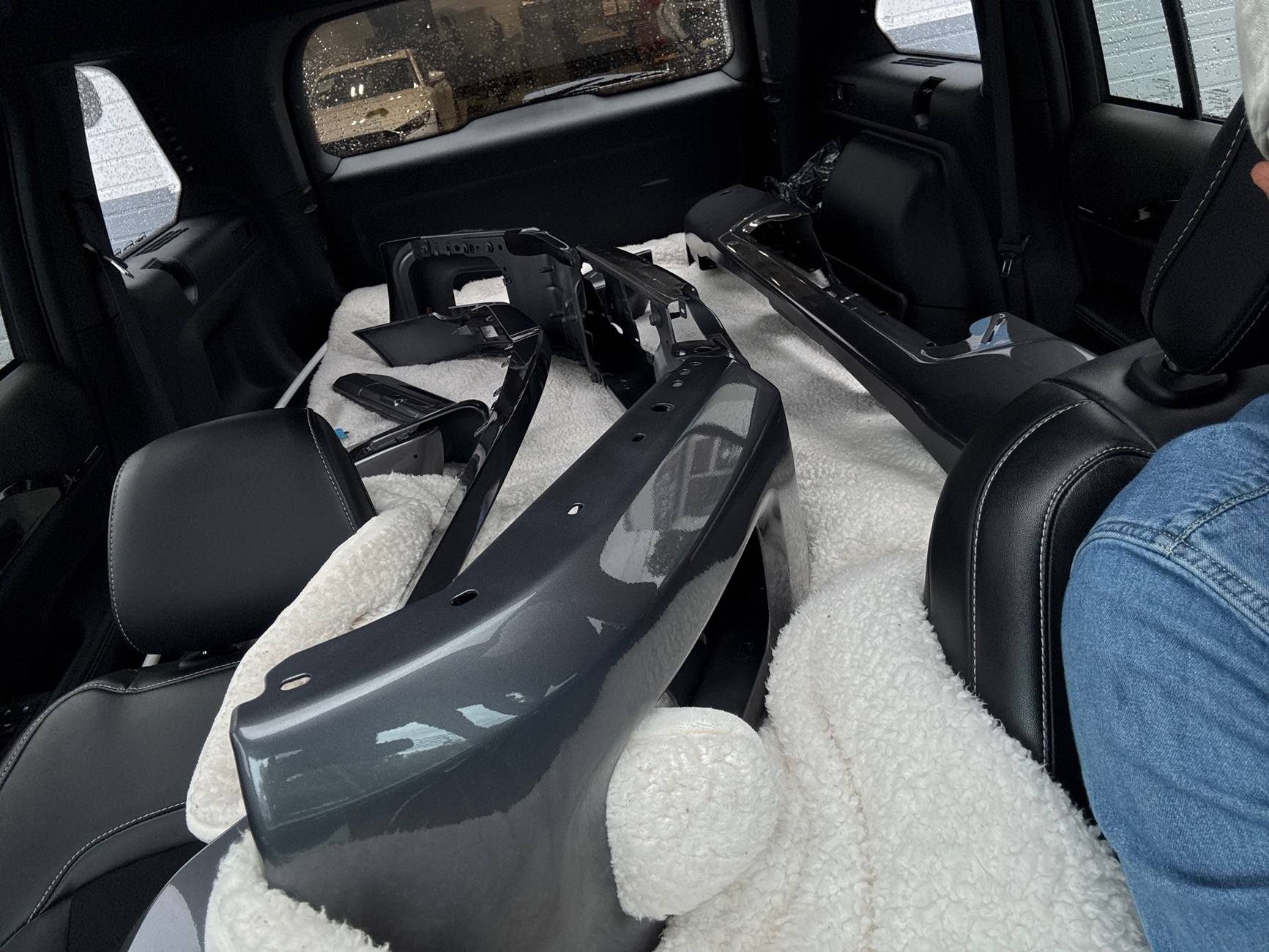

Dropping off the front end parts (bumpers, trim piece, and mirrors) to get color matched.
Ordered the wrong fog lights. Those are getting delivered on Friday.

Looks awesome! Remind me again, are headlights just plug and play, or did you need to do anything special with a harness adapter, and or forscan changes?
Headlights are plug and play to the original OEM harness but you do need an additional harness for DRL, turn signals, and fog light extension and run that in to the cabin. This harness allows high beam functionality later on.
It was a very simple process. I had some hiccups that were pretty simple to resolve but was not common knowledge to me so I’ll do a quick guide for anyone looking to do this.

Nice, yeah I would be very interested in that as I will probably end up going this route. Did you also retain the factory active air damper shutters behind the grill?

Did you add a HCM to control the lights or are you just running them dumb?
