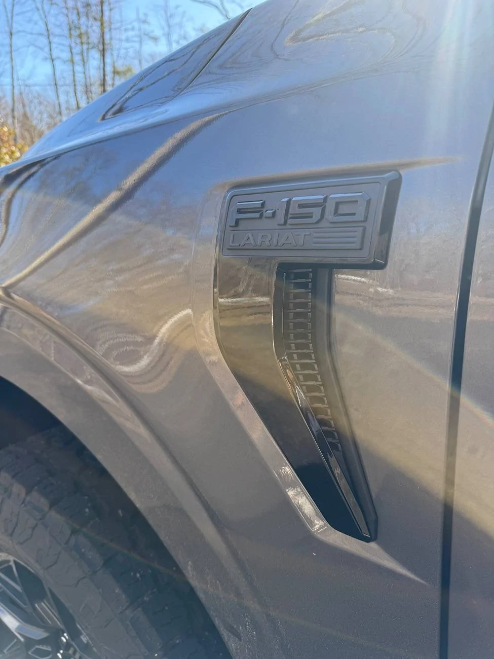

Side vents are in. They look great in gloss black although I might color match them.
Very split on the ‘Lariat’ side vents regardless if I’m doing a full Lariat build (Lariat front, Lariat interior, Lariat options etc) feels slightly poser. Hopefully it grows on me.
Upbadging is a no go IMO.
It's fairly common on RC Lariat, King Ranch, Platinum, etc conversions. I'm just not a fan of badging at all. All my cars are debaged. I might use Ford Performance once and color match them.

Ha! Ford won't build it so I guess you will
