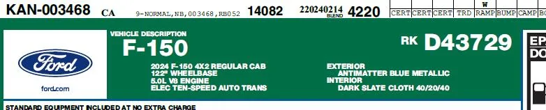

How do I find the blend and build dates?
It should be at the very top edge of the window sticker. Here's a pic of the blend date of my order.

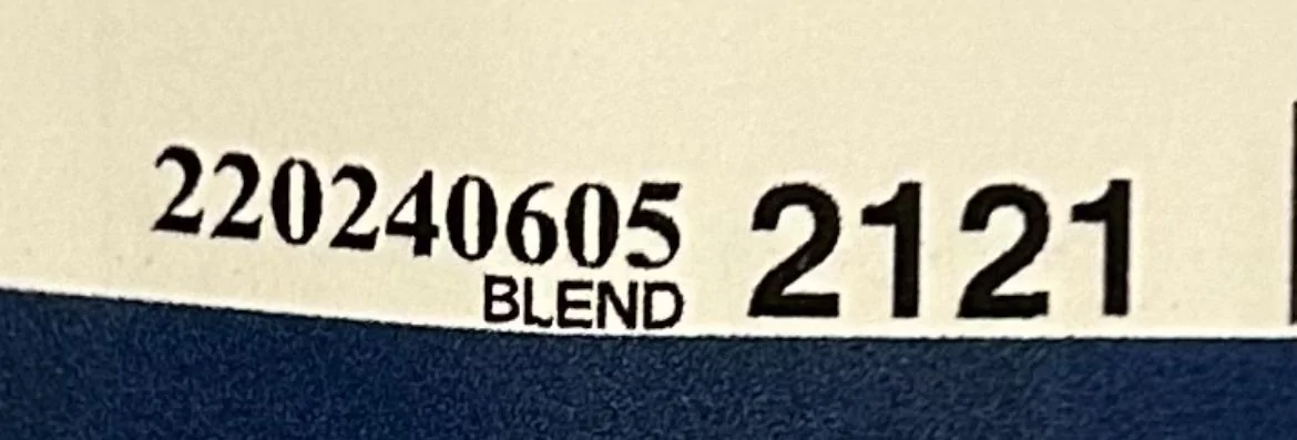

The only date I see on the sticker is what looks to be a date at the bottom under the total msrp field: 05-28-24.
I just looked at mine and didn't see it. I must have seen it on the online version ?‍♂ :frown:

Ok, wasn’t on the window sticker that was actually in the window, but I have one that I printed before I bought the truck. Is this saying June 5th 2024?
