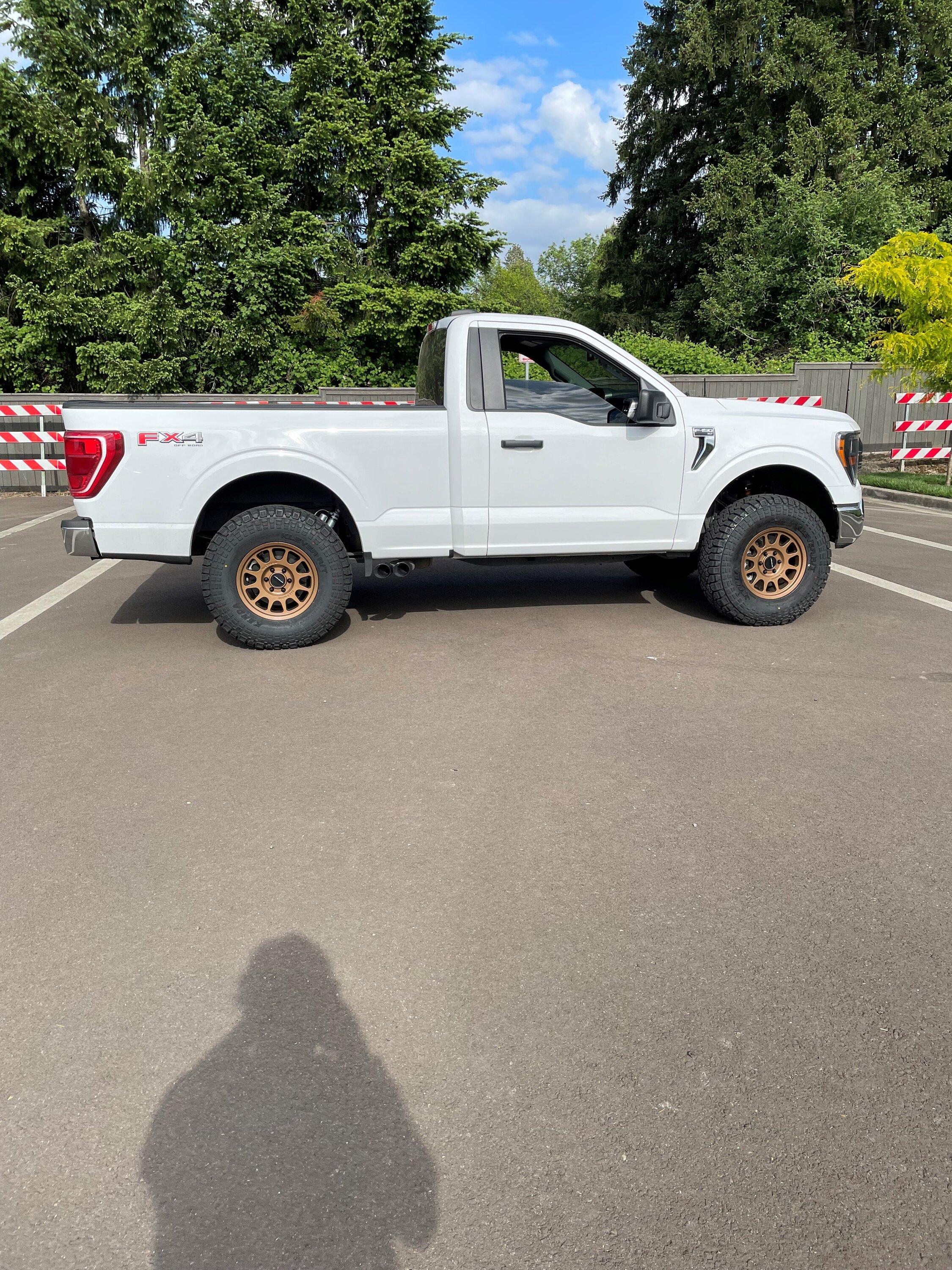

Most guys with the RCSB are slammin' them and going forced induction- i might go S/C some day but In the interest of going offroading I lifted mine. I took a different approach than most here, going with the skinniest 35's i could find and with a modest lift. I couldn't really get an idea off the forum what a lift like this would look like let alone combined with an odd tire/wheel combo on a truck body that's equally uncommon. Hopefully some of my like minded RCSB brothers can get some ideas from this.
Bilstein 6112's up front. On the tallest setting you're supposed to get 2.5" of lift on a crew cab 3.5EB. I have a two door 5.0 so im guessing i got more than that. Did i measure before and after? absolutely not. I have ZERO rubbing at full lock and don't absolutely need new UCA but will do them in the future anyway.
Bilstein 5160's in the rear. I originally took my rear blocks out to level the truck (pre lift) but realized I looked a bit squatted in the back (YUCK) so i added the blocks back and am about 1.5" higher in the rear.

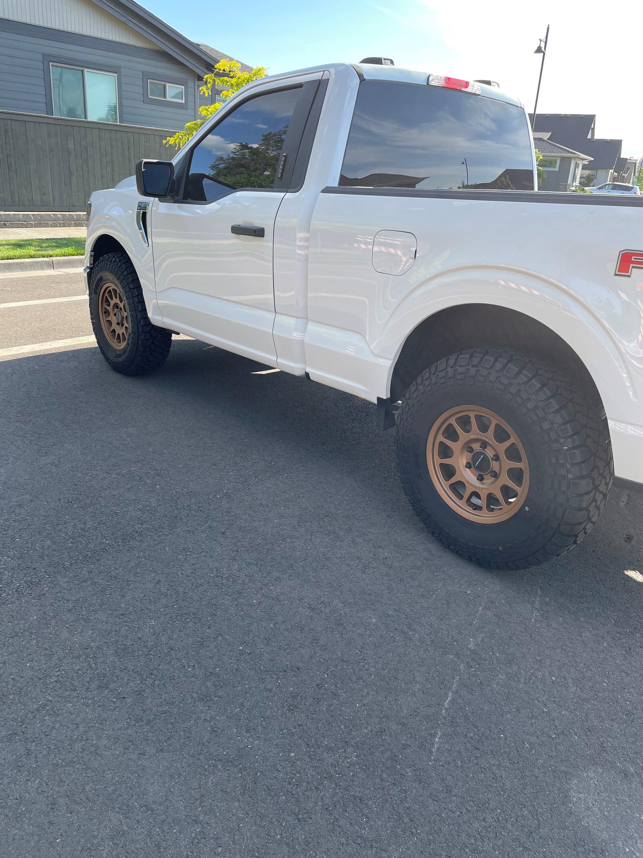

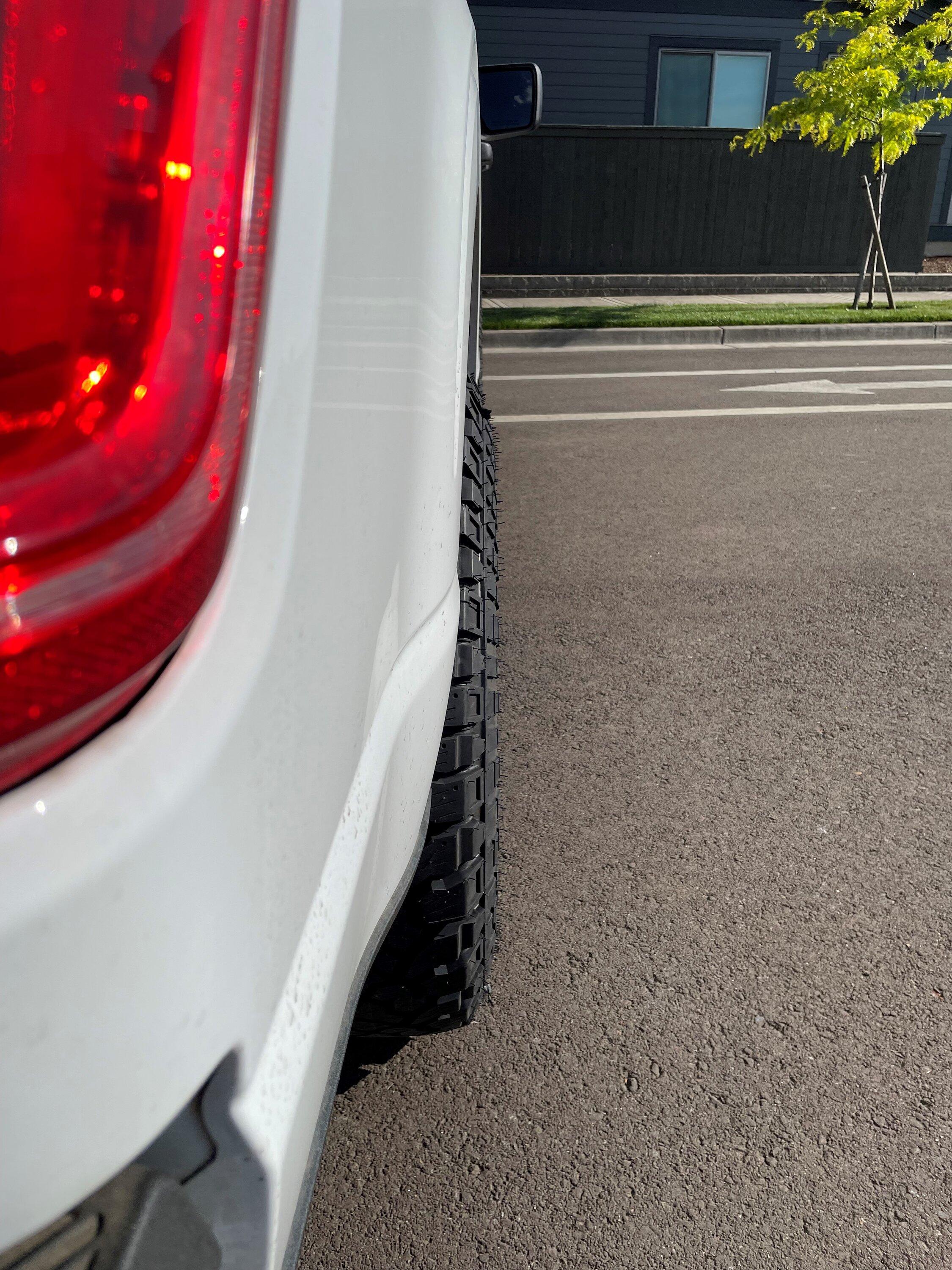

Wheels are Method MR703's 17x8.5 with a +18 offset. I don't like half or even a quarter of my tire out of the well so a positive offset suited my taste. I do have a little poke, but not enough to murder my wheel bearings or fling rocks everywhere.
Tires are Kenda Klever's 35x10.5x17. Yeah they're skinny. I love skinny tires though. Less of a hit on my MPG, steering isn't heavier, airing down will give me actually more contact patch and honestly I think they look better than 12.5's in this height. At stock FRONT height with the new wheels and tires, they didn't rub. Technically they aren't Mud terrian but what Kenda calls ROUGH TERRAIN. They also aren't technically triple peak snow rated, from what i've read these size are but other sizes aren't and in the interest of being consistent they decided not to label individual sizes to avoid confusion.
install was straight forward. Got spring mounts and spring isolators from the dealer with my ford points. Had em mounted since my harbor freight spring compressor gave up the ghost half way through. The shop that mounted put the mounts on recommended getting some LCA eccentric bolts for a good alignment. I did some research and found they weren't yanking my chain. If you're in the PNW and near Portland (YUCK) check out Adventure Outfitters in Hillsboro. Nice guys and none of that BROverlander elitism.

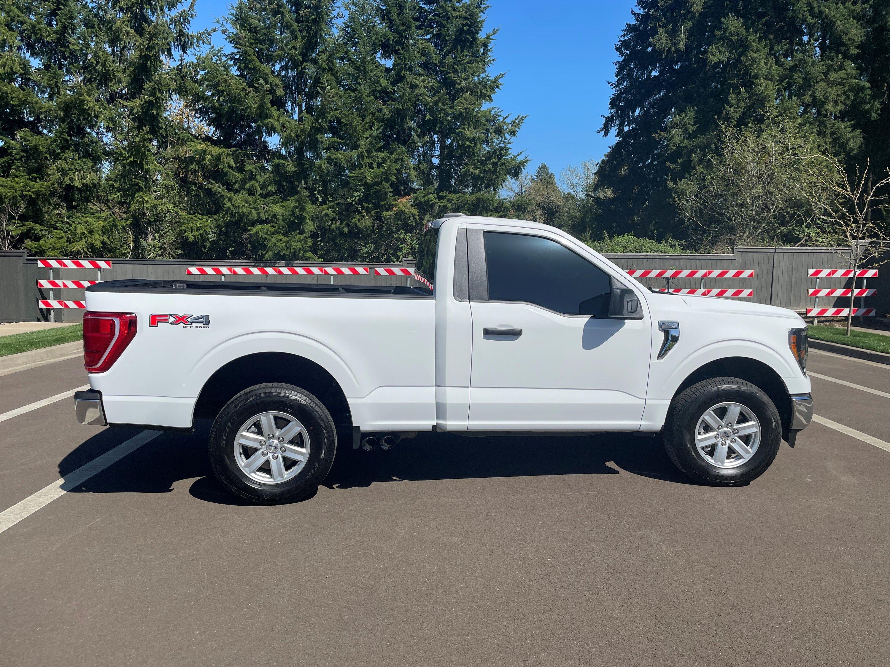

Stock FX4 wheels/tires/suspension front, rear blocks removed.
5160's in the rear, stock front. New wheels and tires didn't rub at all.
Full new suspension, rear blocks BACK IN. Decided to delete the active air damn and do a little plastic chin valence shave.

Long term- Everything has been stellar. Bilstein was an awesome choice. Suspension-wise the only thing ive changed is added Icon's Tremor knuckle and their Delta Joint Pro UCA. I couldn't find anything about whether or not the knuckle would fit a non-ICON coilover. Even ICON told me they didnt know. All they told me was that it was a clone of the Termor knuckle and fitment compatibility is limited to what they've tested...which is their own kits. So I went for it and it turned out great. I originally did it to get better CV angles for when i go 37's but didn't notice much of a change with my current 35's. Currently i have 255/85r17 Baja Bosses from Mickey Thompson, as the Kendas were just too slippery in the rain up here in Portland. Considering regearing at 4.56 and doing a raptor front torsen while im at it- before or immediately going 37's.
edit: I also have zero clearance issues with my wheel and tire combo. 17x8.5”et 25. 255/85R17’s which are close to a 35x10”.
