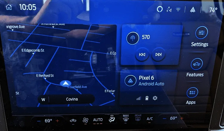

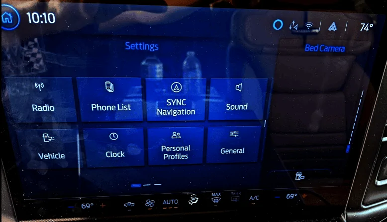

This the one?
I found a couple of things today experimenting with APIM after my Sync 22228 update using the Unreal theme (7D0-02-03 xxxx xxx1 xx--). Make sure to reset Apim in FORScan (wrench tool) after changes.
7D0-10-01 x8xx xxxx xx-- Adds Oil Life to Settings, Vehicle
7D0-02-02 xxx* xxxx xx-- Climate Bar at bottom (use 2 for non-hybrid or 6 for hybrid)
