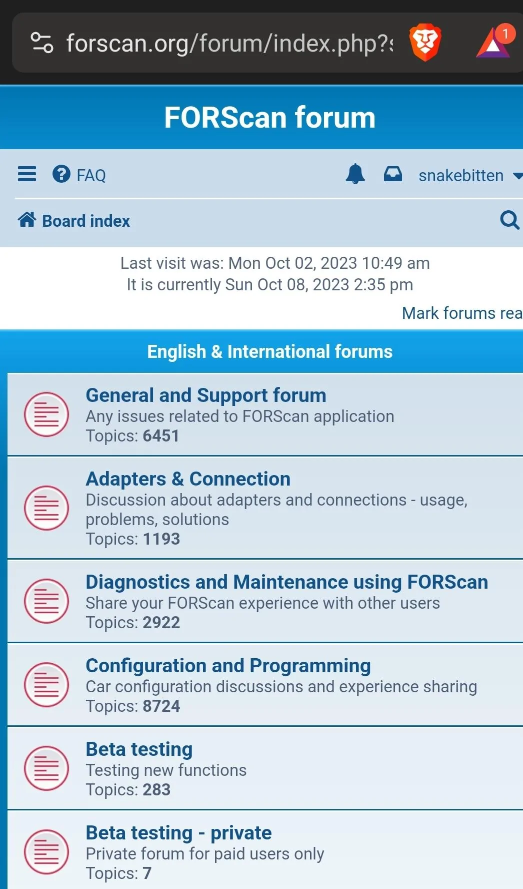

Note: there are 14 new members for October 8 2023. So registration is open today.
Ford F-150 2021+ F-150 FORScan List / Database / Spreadsheet Screenshot_20231008_153536_Brav

I'm not aware of the requirement of an invite to register for the forum.
I'm looking to see if I could provide you an invite, but haven't found a way.
Ford F-150 2021+ F-150 FORScan List / Database / Spreadsheet 1696800354218
Maybe at this time they're requiring we pay. Odd.
