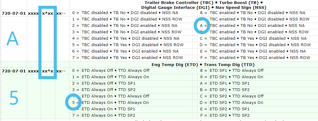

Thanks @hotrodmex , not sure what to scroll, I am looking at both settings (Common and IPC tabs). My truck is 5.0 so my settings should be A5, according to the Common tab and If I go by the IPC tab I would only need to change one digit to 5 (I have TBC). Hence the confusion between the two tables.
I am still curious what SP1/SP2 mean.

You need to make an edit to 720-07-01 to both the 6th and 7th digit, not just the 7th digit like I think you're trying to do.

No, I actually meant to do A5 based on the Common Tab settings.
Now, what is "Nav Speed Sign" ROW?

Ok...Let's try this: What is your 720-07-01 line right now?
NA= North America
ROW = Rest of the World
