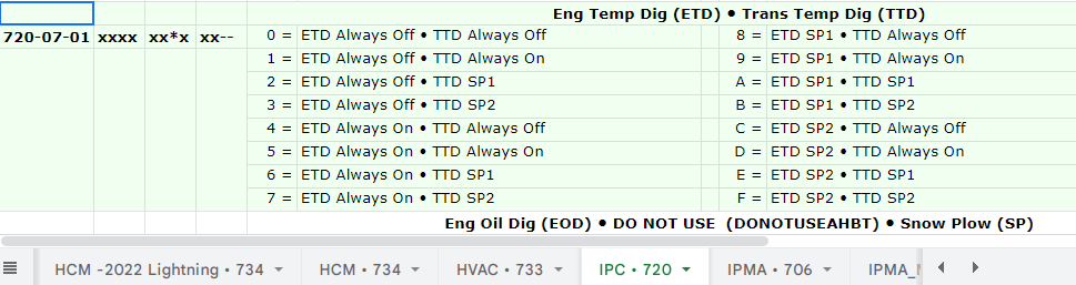

I have a question regarding Engine and Trans Digital Temp.
In the Forscan Google Sheet first sheet (Common settings) it shows these settings to enable digital temp.:
Ford F-150 2021+ F-150 FORScan List / Database / Spreadsheet 1678837431634
However, in the IPC specific sheet it has these settings:
Ford F-150 2021+ F-150 FORScan List / Database / Spreadsheet 1678837486394
What is the difference between the two and which one is correct?
Also, what is SP1/SP2?
Thanks.

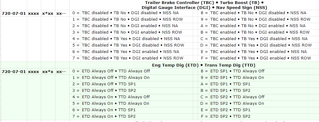

Scroll up. The two values are just combined on the modification instruction, but there are two separate values that are being edited.
Ford F-150 2021+ F-150 FORScan List / Database / Spreadsheet 1679536270218
So the first value (E, 6, A, or 2, etc)is to make DGI Enabled, relative to the other features your truck has.
Maybe only appears in certain drive modes, since the only other options are TTD Always On and TTD Always Off?
