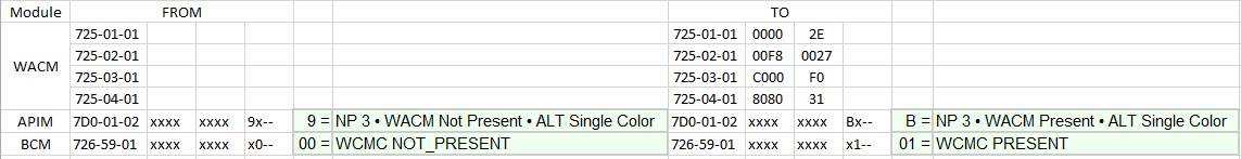

How do you activate a WACM if your truck did not come with one from the factory? This is what I have so far:
I installed the WACM after I purchased my truck. These are my values. This was installed in a 2021 build 1 so may be different than yours. @Livnitup may be able to confirm. My wireless charger works like a charm.
725-01-01 0000 2E
725-02-01 00F8 0027
725-03-01 C000 F0
725-04-01 8080 31
7D0-01-02 2300 C62B 9987
726-59-01 0BEA 6000 00DC

Does anyone have any input on this?
Please keep in mind the connections are there but not the wiring harness. If you just purchase the WACM its not plug and play.
Also, if I remember correctly. I ran two WACM updates in forscan.
Once you get the harness & WACM installed then connect to your truck in FORScan and click no when FORScan asks if you want to load your saved VIN profile - this will cause FORScan to search for the new WACM module. If FORScan finds the WACM then you can save this as your new profile that you use on subsequent connections to the truck. Then make the changes below to the WACM/APIM/BCM modules
WACM 725-01-01 0000 2E
WACM 725-02-01 00F8 0027
WACM 725-03-01 C000 F0
WACM 725-04-01 8080 31
APIM 7D0-01-02 xxxx xxxx Bx--
BCM 726-59-01 xxxx xxxx 01--
* Note: ignore whatever you have where the x's are above and just write the non-x value and ignore any message FORScan gives you about incorrect checksum and continue the write.
