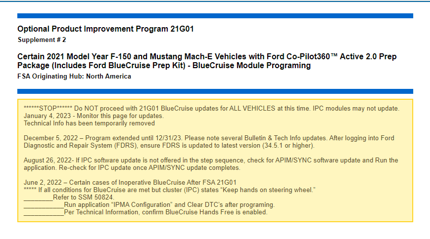

Does anyone know what the problem is that caused them to put a hold on the campaign to add BlueCruise to '21 Job 1s? Has anyone had any problem just borrowing a mongoose and doing it themself? I'm considering this route, but I don't think I heard what the issue was.
This is what PTS shows for the 21G01 campaign for Bluecruise programming. The IPC "may" not update. There are VERY rare cases where the IPC update does not appear on FDRS even after performing a network scan. When mine was stuck on 2.7.3, Jesse feared that might have been the case for my truck, but once I performed a network scan, it popped right up. The USB method failed, so I had to push the update into the module directly with the Mongoose which took 6 hours, but it worked. If that is the case and the IPC update does not show, then the IPC update has to be side-loaded which is something dealers cannot do. However, I want to say less than 99% of trucks have that problem, and Ford has a hold for 5 months on this program because of a possible issue on less than 1% of trucks. It's beyond ridiculous to me. If you follow the FDRS thread, there have been countless people with no related experience that have updated their trucks themselves here; including me.
Interesting. Thank you very much. I think I will go the mongoose route assuming they don't restart the program before my name comes up on the list.

Sorry for all the dumb questions here, but does it break anything if that update does not work, or does it mean that you just have to wait until the Ford gets their act together? Is it worth trying do on my own, or am I going to risk disabling my truck?
The IPC update not being done affects BlueCruise guys the most. If the IPC update is not done and you are allowed to proceed with hte rest of the updates the config will be an issue. It wont be correct. So you most likely will never get BlueCrusie working. It takes several modules to have teh correct config to allow BC to work. So Its a domino affect.
I have a good solid plan for guys that we had to sideload teh IPC update and it has worked out well.
Why Ford cant seem to get the IPC update to be reliable I have no idea. It seems so silly.
If you do not have Blue Cruise you can still be negatively affected by the missing IPC. You May lose lane centering and cruise control functions.
It more of an ordeal for BlueCruise trucks though.

So this makes me wonder if they are holding out BC OTA updates as well. I went from 2.7.3 to 3.5.3 today and BC is missing.
Can you send me your vin
Jesse-Infotainment
Diamond Sponsor
Jesse
May 27, 2021
3,961
6,401
Dallas
2024 F150 Lightning
1FTFW1E87MFB02623
Thank you!
Your truck got the first IPC OTA and not the second one. Good news is the second Update is showing and you need to get that installed soon. That is what is causing your issues. It is exactly what I said earlier. Thre config is based off the IPC. If its not installed the rest of the updates will install with the wrong config
