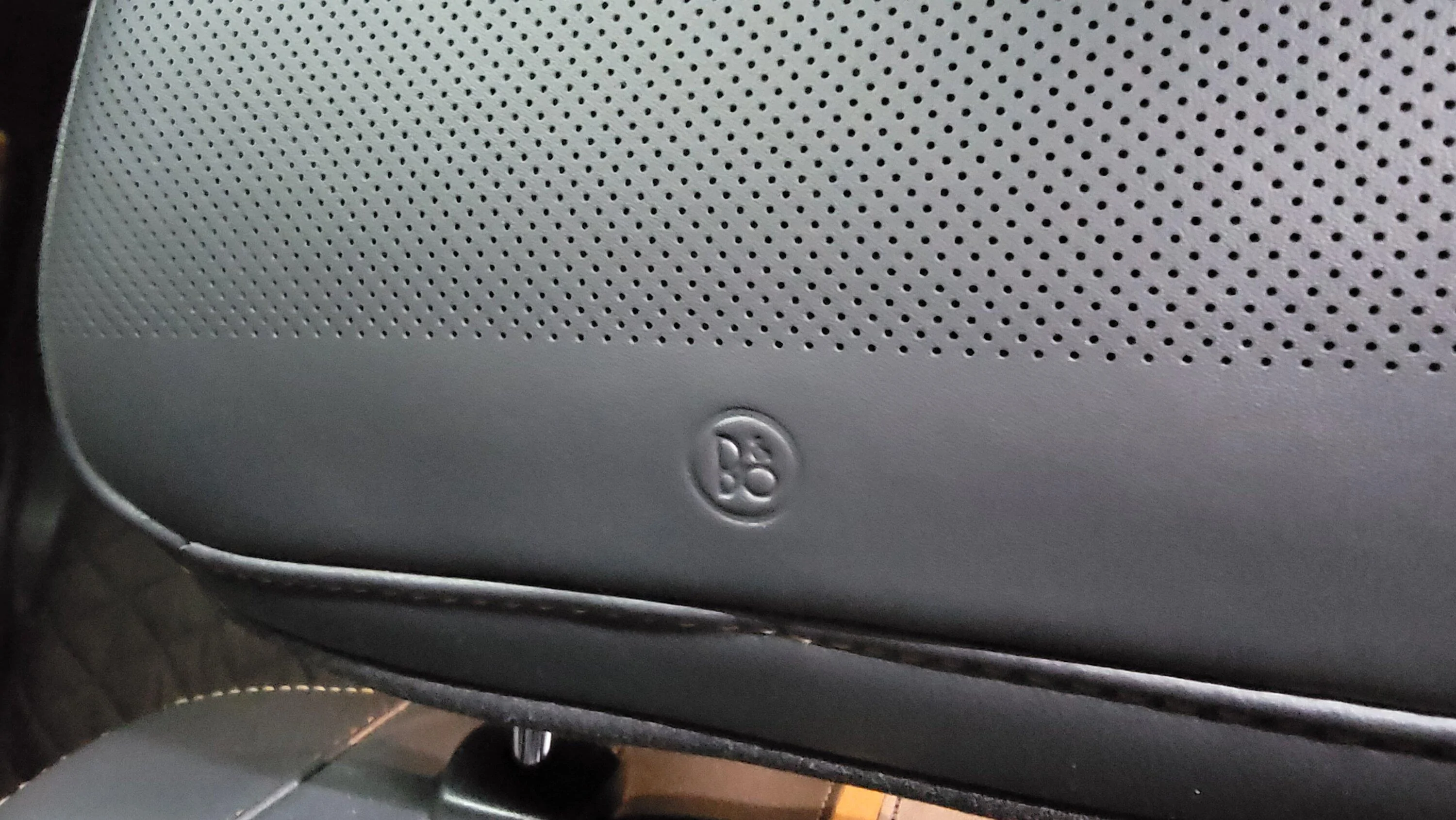

Doing all this research with the massage seats, then hearing about the speakers in the seats, then my dumbass is putting my ear against the head rest, just to hear nothing.
Whoa, hold up a second....
First, @diambo4life his first pic DOES say "Unleashed", but I can't tell if I can see the B&O logo on the headrest, does your have these?

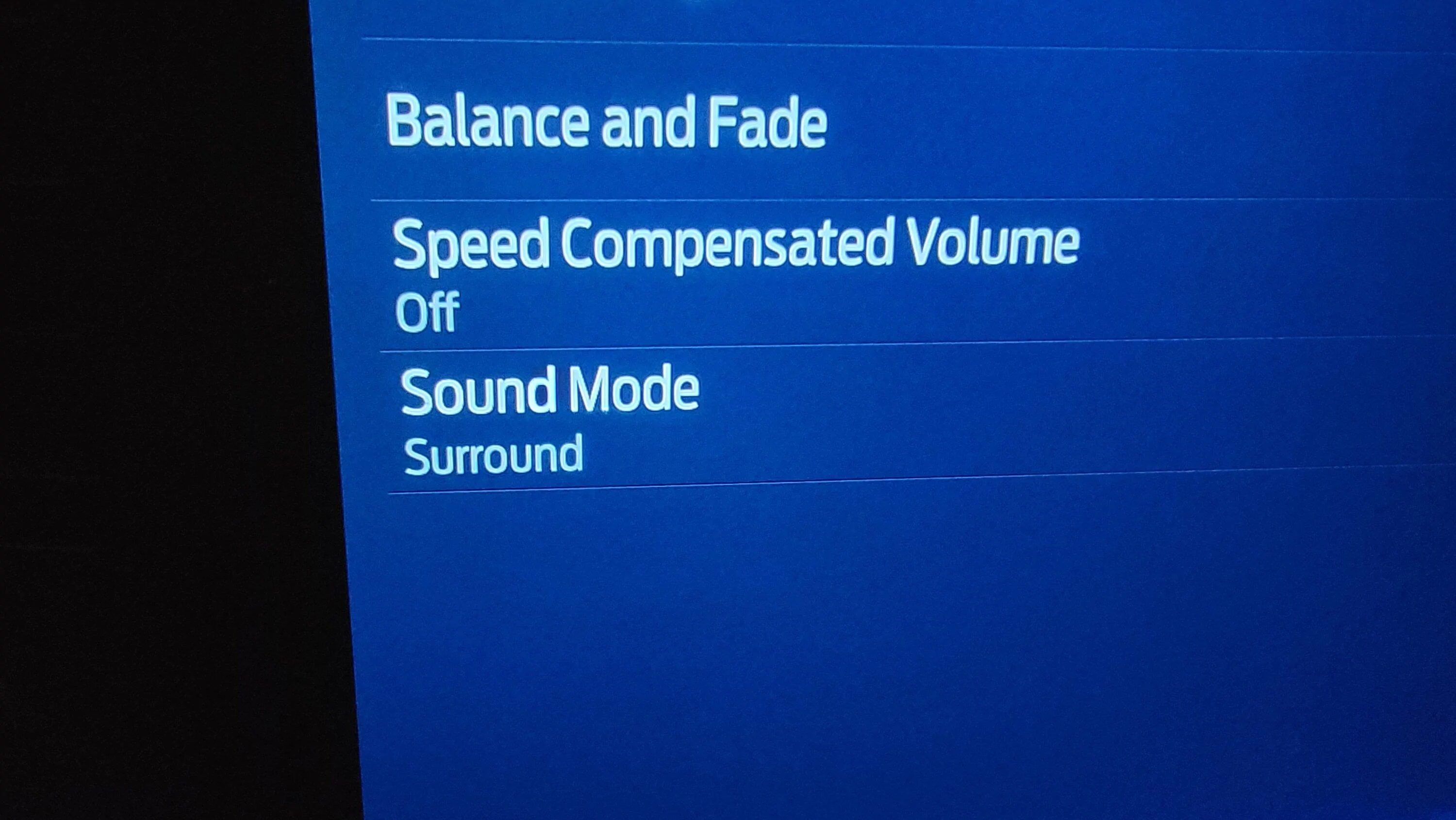

First things first, make sure you are in SURROUND MODE:
AUDIO>SOUND>SOUND MODE>SURROUND.

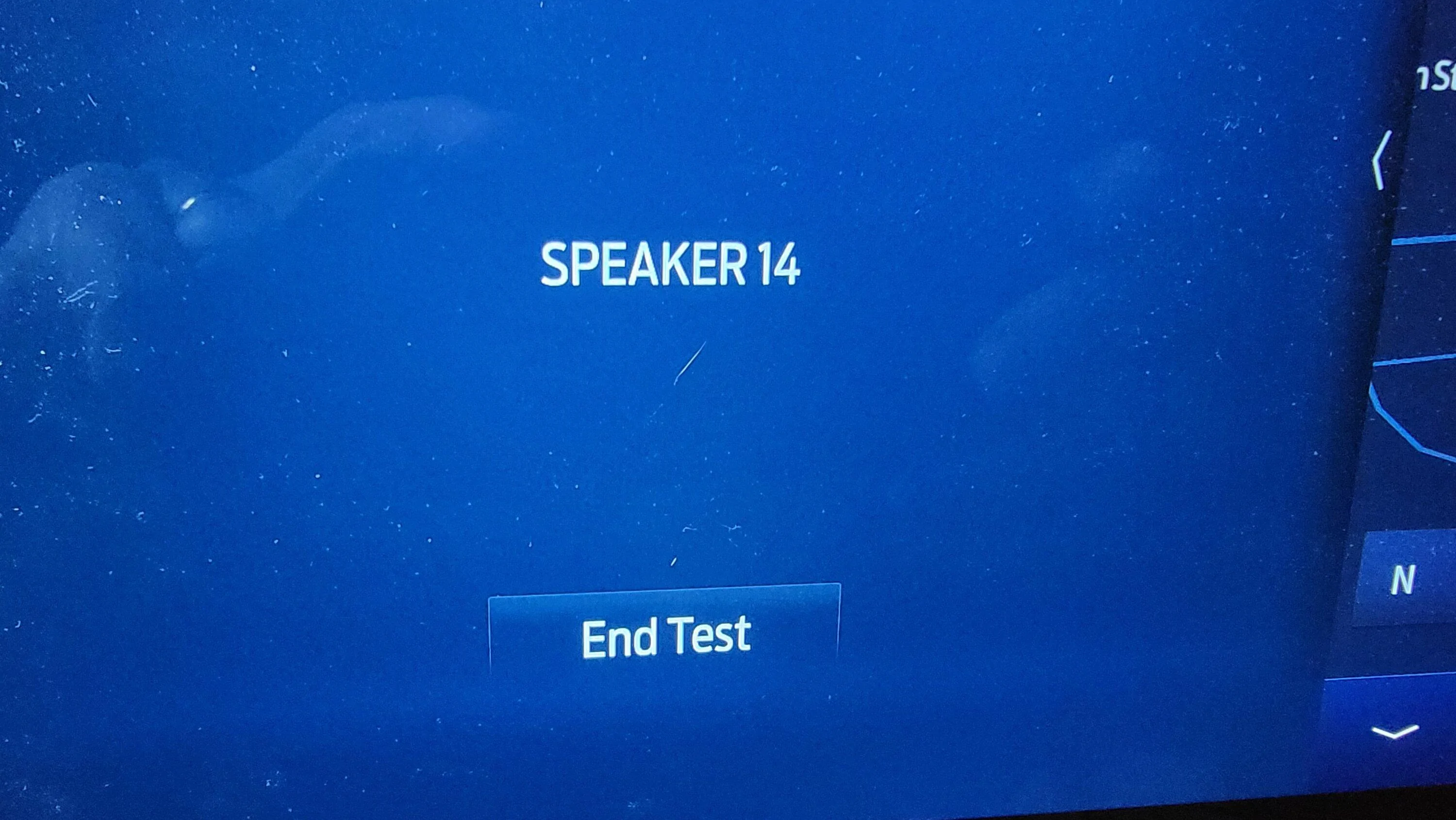

In order to go through the sound test press the forward button on both the steering wheel and radio interface at the same and hold for 5 seconds...
Ford F-150 18 Speakers/Head Rest?? 20230608_212909
Ford F-150 18 Speakers/Head Rest?? 20230608_212937
Ford F-150 18 Speakers/Head Rest?? 20230608_212958
.... It will cycle through the speakers.

Your window sticker indicates you should have the headrest speakers, but your headrests do not, as @JJSnell mentioned above. My 18-speaker Unleashed system has embossed "B&O" branding on the headrests.
